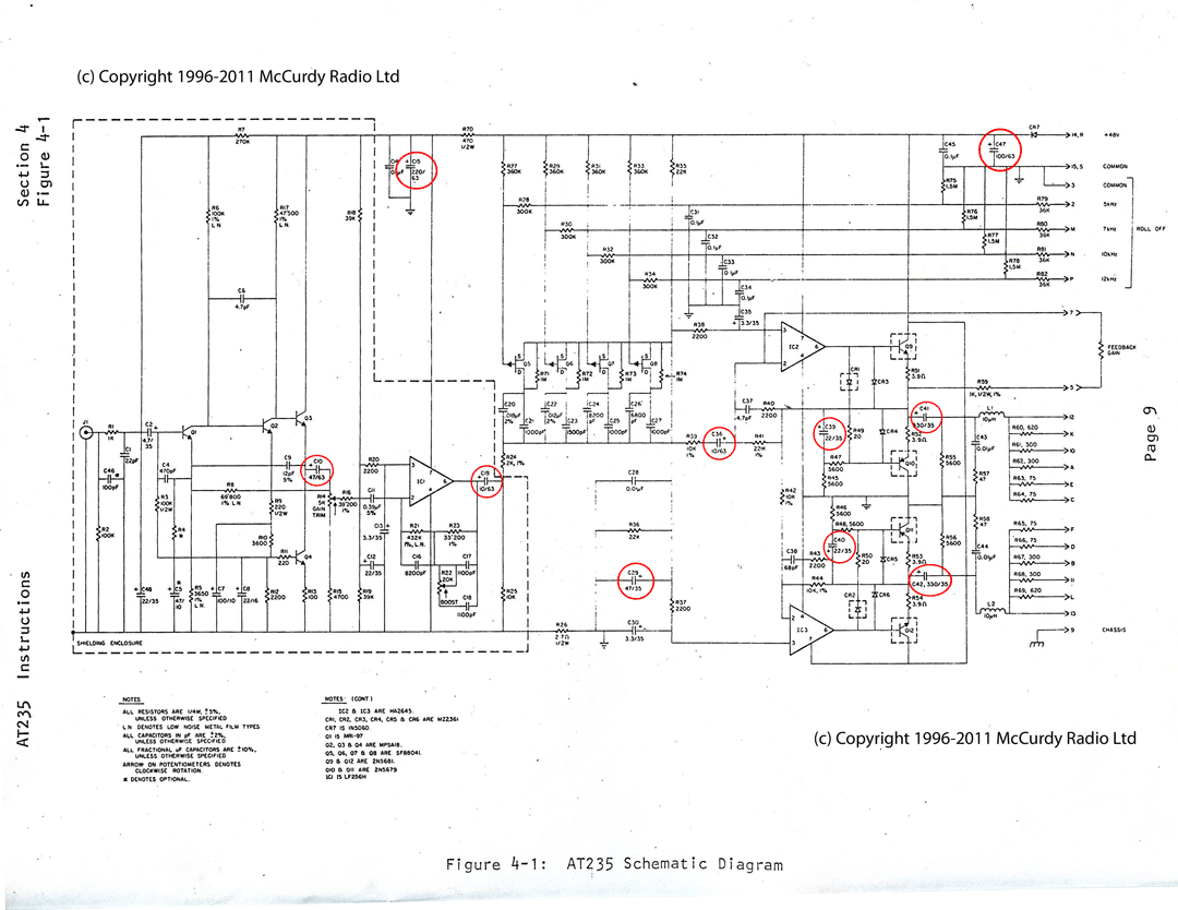

Hi Sy & h_a.
Well I finally got a scan of the schematic. I hope posting a companies schematic is not a problem.
I've circled all of the electrolytic caps that I'm looking at replacing. The schematic is for a single channel. The two channels sit above a single power supply. Since the channels are discreet (as far as I can tell) I speculated that somehow signal was getting to the other channel via the power supply.
Also, I've uploaded a screen shot of my 1k sine wave test tone@-44db that I ran into the right channel (Orange) only. The left channel (purple) activity is some how related to the right channel signal. If I play the test tone in the left channel, the right channel is silent and shows no activity. As you can see there are issues. In the middle graph (Oscilloscope) the purple line should be flat like the green line and the orange line should be a SINE WAVE!

> schematic saying copyright 1996-2011?
The copyright notice is clearly digitally-stamped over a much older blueprint.
The era is 1970s, though this is conservative broadcast stuff and may have been in production well into the 1980s.
I've never seen broadcast stuff with paper boards. My 1970 RCA had glass-base boards which could have served as armor-plate. My LPB console had a lower grade of board but not the cheezy paper found in consumer junque.
The "signal bleed" is NOT on the boards, since these are one-channel boards with excellent supply rejection. Much more likely in external wiring.
> The specs claim RIAA +-0.5% Frequency Response from 30Hz to 15Khz. Can +-0.2% be achieved?
0.5% is 0.0433db error. This can be a VERY accurate RIAA. There are multiple options to screw it up for more punchy sound or to roll-off scratchy highs.
PRR is absolutely correct. I added the copyright, which I got from their web site, just to add clarity of ownership. The manual that the schematic comes from is dated April 1978.
"RIAA +-0.5% Frequency Response from 30Hz to 15Khz. Can +-0.2% be achieved?" is actually supposed to say "RIAA +-0.5db Frequency Response from 30Hz to 15Khz. Can +-0.2db be achieved?"

h_a - I posted a new version of the schematic. I hope it's large enough. It seem fine to me but I zoom in to look at details.
Kevinkr - Ah great! Now I'm looking into replacements for the Harris HA2645's A quick search brought up the Burr-Brown Opa445.

> I'm just wondering given the extreme complexity of this design
> Lots of transistors and early, poor performing op-amps in the signal path
The complexity cleverly side-steps the possible opamp issues.
Q1 Q2 Q3 is a flat-gain low-noise amp which brings level far up out of the hiss of any chip. Assuming 1uV-2uV hiss from cartridge thermal resistance, gain-of-20 means the next stage should have hiss much less than 20uV.
Flat?? So where's the RIAA? The next stage *inverts* which allows an exact RIAA including infinite fall above 20KHz (non-invert goes flat-gain past the top of the audio band). The 1KHz gain is about unity.
HA2645 is a remarkable chip for its age. You sure can buy better specs today; I'm not convinced better specs mean better sound. Topology is complex but clean with hi-performance complementary process. Hiss is near 2uV, far below the 20uV needed to avoid stepping on thermal source hiss. Gain-bandwidth is "only" 4MHz, but this inverter runs unity-gain at 1KHz and there is over 80db NFB here. Slew is "only" 5V/uS but this allows "full" output well above the audio band. (Which does not matter to the RIAA stage but gets critical in the output stage.)
Also note the HA2645 is run direct on +48V (minus one diode-drop). Most standard chip opamps nominally explode at 36V, a few say 40V, and one says 44V. HA2645 is rated 70V. While I know a "36V" chip can live years on 37V, this point needs to be pondered before stuffing a "better" chip into a 47V hole.
So gain of 20 in front and unity-gain at 1KHz in the RIAA stage, gain of 20. We need more. The output stage is wired for gain of 22 to one output, inverted at the other, maximum gain is 880 at 1KHz, wow! You are going to want about 50K at "feedback gain" pins, to get it down in the 100-200 range we want for moving-iron needles. (The front-end is NOT optimized for moving-coil impedances.)
It's certainly stable enough. I suspect R21 and R23, 1% parts, are the correct value. C16 may be a correct nominal value, and if it is 2% or better it should be fine.
The goofy part is C17 C18 and that "Boost" trim. Treble Boost is handy in broadcast, but you want "correct". Disconnect either R22 pot or C18. Change C17 to the right value. What's right? Either 3X or 4X C16.... I'm just not sure which factor is correct. My inclination is to go 2,050pFd at C17.
Then get Hagman's inverse-RIAA board, stable sig-gen and voltmeter, and trim the RIAA network. He only claims 0.5db accuracy, but note his plot of error with 5% parts gives 0.5db so Hagerman's and McCurdy's 1% parts should come in much better. And perhaps matching L/R is more important than absolute error... use the same iRIAA channel for both preamps and you can match them, far easier than trying to match without the iRIAA network.
