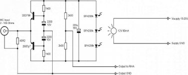

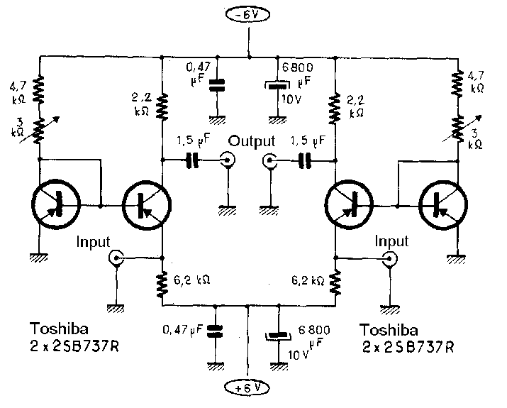

I'm looking schematic for MC pre-pre with bipolar transistor input.
