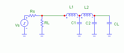

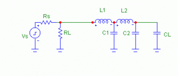

Put the resistor at the load end!
Do I have to 'splain transmission line theory? I would rather not have to.
Jocko
Jocko

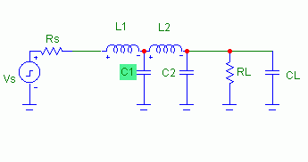

Christer:
Maybe not at 1 kHz, but a twisted pair CAN start to act like one as low as 100 kHz. The main reason I would put it there has mainly to do with the fact, that no matter what you do, there will be low frequency RF energy there. It is VERY hard to shield that low RF stuff, but easy to filter.
Yeah, yeah.......I know........guys use unshielded stuff all the time. And they claim their stuff sounds great.
Doing things the right way from the beginning is always a good place to start.
Jocko
Jocko
Jocko,
Thanks for the clarifying illustrations. Before going on, I'd better
state my assumption that L1-C1-L2-C2 is the simplified model
of the transmission line, so we don't get any misunderstandings
from this.
Yes, I agree that Fig. 2 is highly undesirable. I might perhaps
have caused a bit of confusion with some of my earlier posts,
since I use an extra resistor in parallel with the phono amp input,
to bring down the load impedance. It was this resistor I was
considering if it would better be on the TT side of the cable. In
my case I think not, since it is of much lower value than the
amp input impedance, getting us closer to the case in Fig 2.
Good that you brought RFI into the discussion, since we had
missed that parameter entirely. But then, if we have a choice,
wouldn't it be best to terminate with a low resistance at both
ends of the cable. Or would the coil serve that purpose despite
its inductance? What about Zobel filters at each end, as Rod
Elliott suggests for other parts of the sound chain?
Sorry Jocko, but HF and transmission lines is absolutely not a
strong side of mine, so please forgive me if I mess things up
here.
here.
No problem
