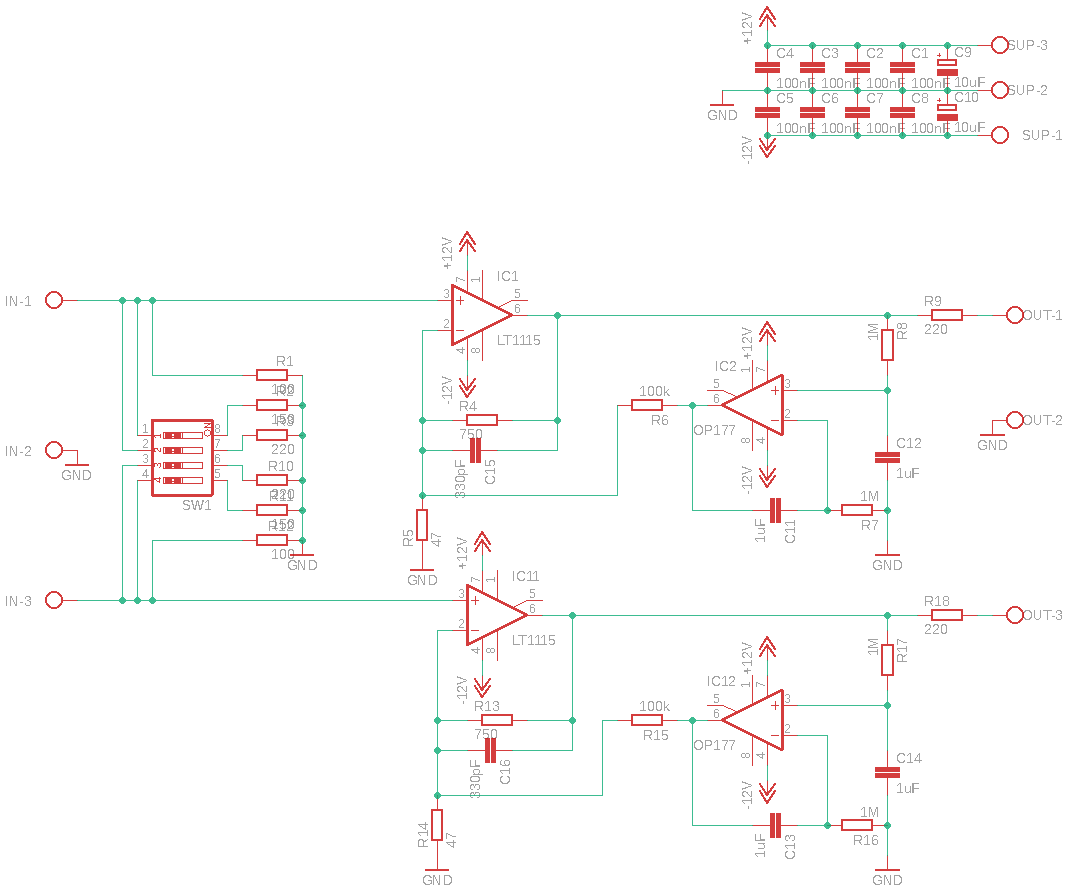

Schematics for the PSU and amp is available at the page I linked. But here's the schematic attached that the board is based on anyway.
I would be surprised when C15/C16 are the cause of the hum.
You could as a test replace the power supply by two 9V batteries to see if the hum is still there, if not, your power supply is causing the hum.
The other thing you can try is to connect the casing of the head amp to Protective Earth, and from there via a 10R to your ananalog Gnd.
Final remark, nothing having to do with hum, is that I don’t understand R5 in the feedback loop.
This resistor produces more noise as the LT1115, so you better change R5 to 10R and R4 to 250R to gain 3dB in S/N.

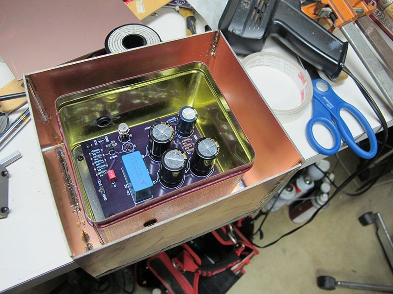

Your ground plane is a "radiator" in the sense of antenna, picking up mains radiation. It's like the stock PCB of the "Pearl II" for which hum in an omnipresent issue!
You may also pick up mains radiation from the umbilical connecting the power supply to the PCB.

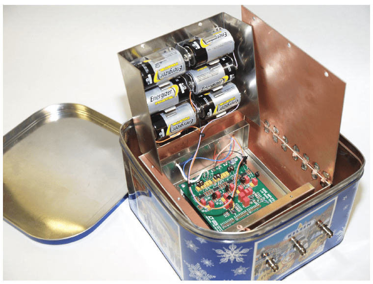

Now that the board is burned, you can remedy the situation by putting the PCB into a small candy or cookie tin, best if it's steel. You could go the extra mile as Linear Tech did in this application note by having a clamshell made of PCB material inside a cookie tin. Obviously, yours is going to be a lot smaller. (Edit, I include a pic of a very low noise measurement amplifier which uses an IF3602 JFET -- it is triple shielded.
