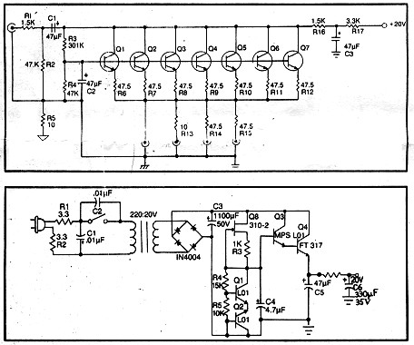

I have mine on paper, not in a file, but here it is as it was posted by arq_ some time ago.
Q1-Q7 in the original were MPS6571's, but MPSA18's or similar low noise NPN's will work fine (NP's words not mine).
I built mine using BC550C and if you decide to go for it match them as closely as possible.
Don't bother about the ps, replace R17 with 1K and use 2 9V batteries in series for both channels, they will last for about 6 months with heavy use.
You know, as a design it is 25+ years old but it's still unique, extremely quiet, no feedback, no loading problems, sounds fluid, lightning fast and with no grain at all.
And if it had the gain of the Ono mc stage, I don't think I would have been tempted to build the Ono.
As long as you are using a cartridge with an output >0.2mV partner it with the Pearl and you are going to be a happy man.

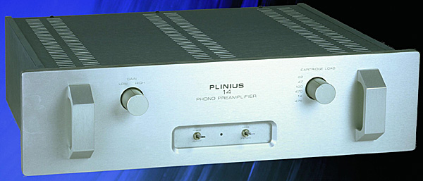

Hi KBK,
Have you had the chance to listen to the PLINIUS M14 yet! This is one of the best SS phono amps I've ever heard.
Fluid, transparant, lightning fast, and extreme deep and powerfull bass. Atleast in combination with the Ortofon MC20 SUPER, the Van Den Hul MC one Special and the Shelter 901.
The price of this well build tank is around $4000.00 !
Best regards,
Audiofanatic 😉
