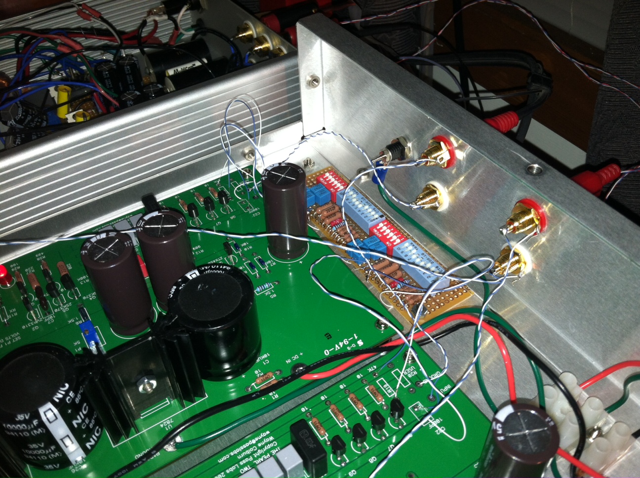

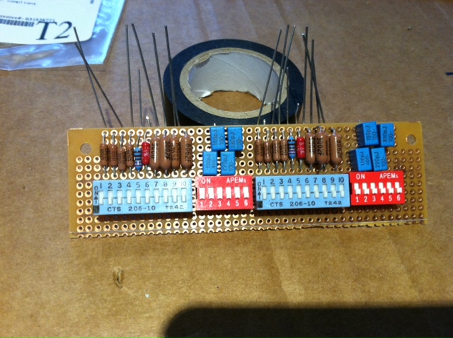

Resistor and Capacitor Load Switching
So, I'm on vacation to take care of my mom after back surgery and I had a chance between rehab visits to build the load switching circuit. It came out nice. I'm happy with it.
Si, the 1k load for the DL-110 is the way to go. From a cold start, one can tell that 47k is not correct or at least not optimal. More definition between notes and reverb that goes on forever.
Here are two photos that tell the rest of the story.
The parallel resistors are 80k, 47k, 30k, 5k, 3.3k, 2.2k, 909, 300, 150 and 100 ohms. Caps are 100pF, 150pF, 220pF, and 330pF. I was going to add a 100k also but realized the switch is a 10 DIP and not 12, like I though was purchased. I can still add it permanently to the board, if needed.
5k, 3.3k and 2.2k get 1025 Ohms. 3.3k and 2.2k gets you 995 Ohms.
I went with 1025 and doubt 995 would be much different...but who knows! 🙄
By the way, the above are meter measured readings, not calculated.
Vince

Hi Vince
Nice work on the loading board.
Thought you were going for a wi-fi connection at first...
...with all those little aeriels !
But no...
...fits in the Pearl as snug as a bug !
What with the Pearl PSU fix & the new 1K loading...
...sounds like the Denon should be living up to it's rep. now.

Very nice build. But why no use the R20 for loading? Is there any reason?
