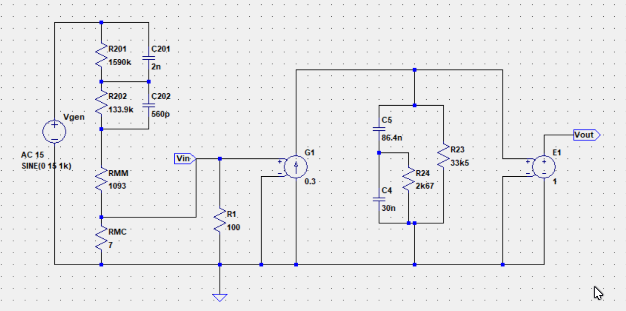

The concept I was working from is as simple as it gets:
The dc-gain is defined as Ag = gm x Rl and with Rl = 33k5 in
the RIAA network and Ag = 80dB = 10,000x =>
gm = 10k/33k5 =0.298S (S = 1/Ohm).
The RIAA network is from Linsley-Hood as found on Elliot Sound
(sound-au.com/project25.htm), allthough I reduced the impedance-
level to 1/3, i.e. resistors devided by 3 and capacitors multiplied
be 3.

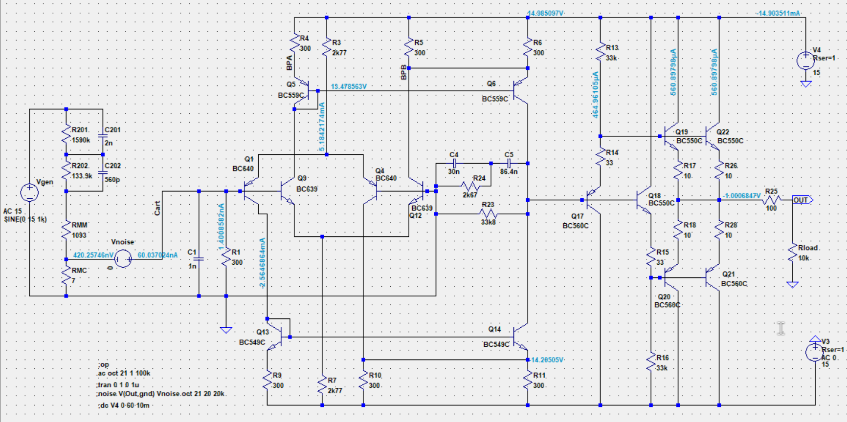

The design I came up with look like this (simplified):
The output of the LTPs (Long Tailed Pair) feeds into a combination
of a current mirror and folded cascode. With the R4,R5, and R6 as
specified, the quiscent currents of Q9, Q12 and Q6 are the same.
The same applies for Q1, Q4, and Q14.

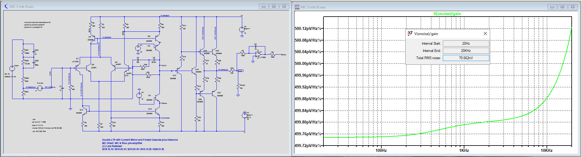

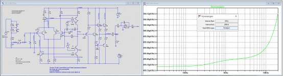

I added two cascodes between Q6 and Q14 to increase the impedance, thereby decreasing the Riaa deviation.
I didn't have the BC transistors that you used in my library, so I replaced them all by 2N3904/2N3906 except for the input resistors, where I used very low noise the ZTX851/ZTX951.
To get the output nulled, I used a servo connected between output and cascode.
Noise is below 0,5 nV/rtHz or 71nV for the audio range from 20Hz to 20Khz.
Hope this helps you.
Hans

You beat me to it, Hans. But here is the full circuit as promised,
pls see attachment.
A lot has been added, relative to the simplified circuit. From left, I
have added 2 LTP in parrallel with the original, purely from noise
requirement. The reason for the BC639/BC640 is that a) it's readily
available and b) rumour has it, that they are merely BD139/140 in a
TO92 housing. In other words, medium power transistor, with a larger
chip compared to a normal small-signal one. I tried with 2sa1316 and
2sc3329 - they are specified as input transistors for MC amps, but
they sim worse - for what its worth - than BC639/BC640. The reason for
parelleling LTPs in stead of transistors is a practical on: it is much
easier to find 2 pairs than finding 4 transistors that match within,
say, 1mV from a batch of say 20 transistors.
MarsBravo: regarding R5/6 and R9/10, you are absolutely right. The
reason is that I some time ago bought 1000 pcs of 300 Ohms 1% for
next to nothing.
The next addition are Q7/8 (and Q15/16). Instead of a cascode, I
chose to use boot-strapping. There are two reasons for this.
Firstly, it is superior to the cascoding, as it maintains a constant
voltage over the boot-strapped transistor, Q6 an Q14. Secondly, the base
current flowing into Q7 cancels out the base current flowing out of
Q6, thereby improving the performance of the current mirror. R19 is
added to improve in this regard.

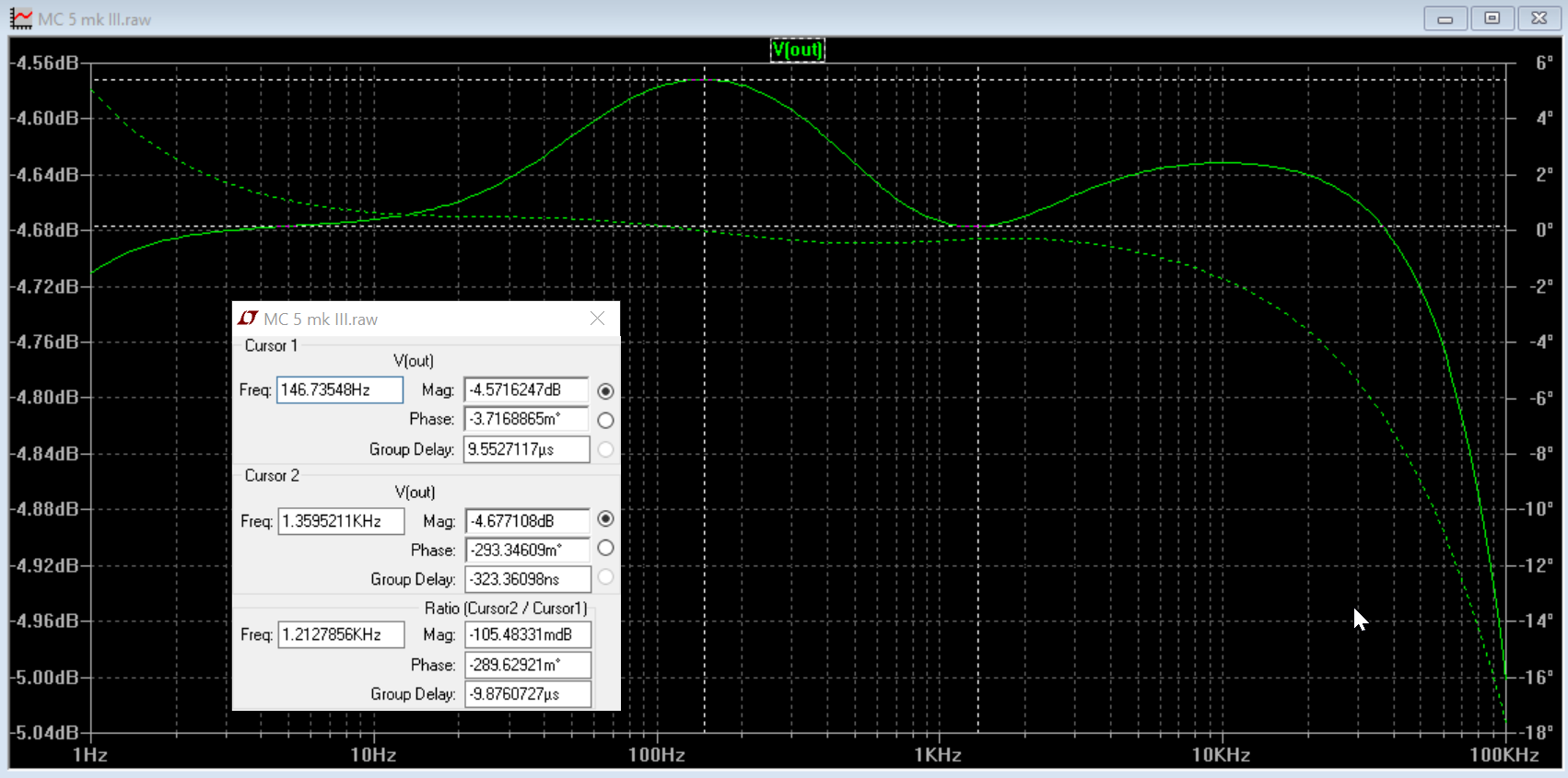

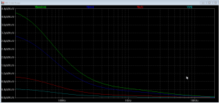

Simulation results:
I've attached an AC plot of the RIAA accuracy : in short it's within
0.1dB from app 3Hz to 37kHz.

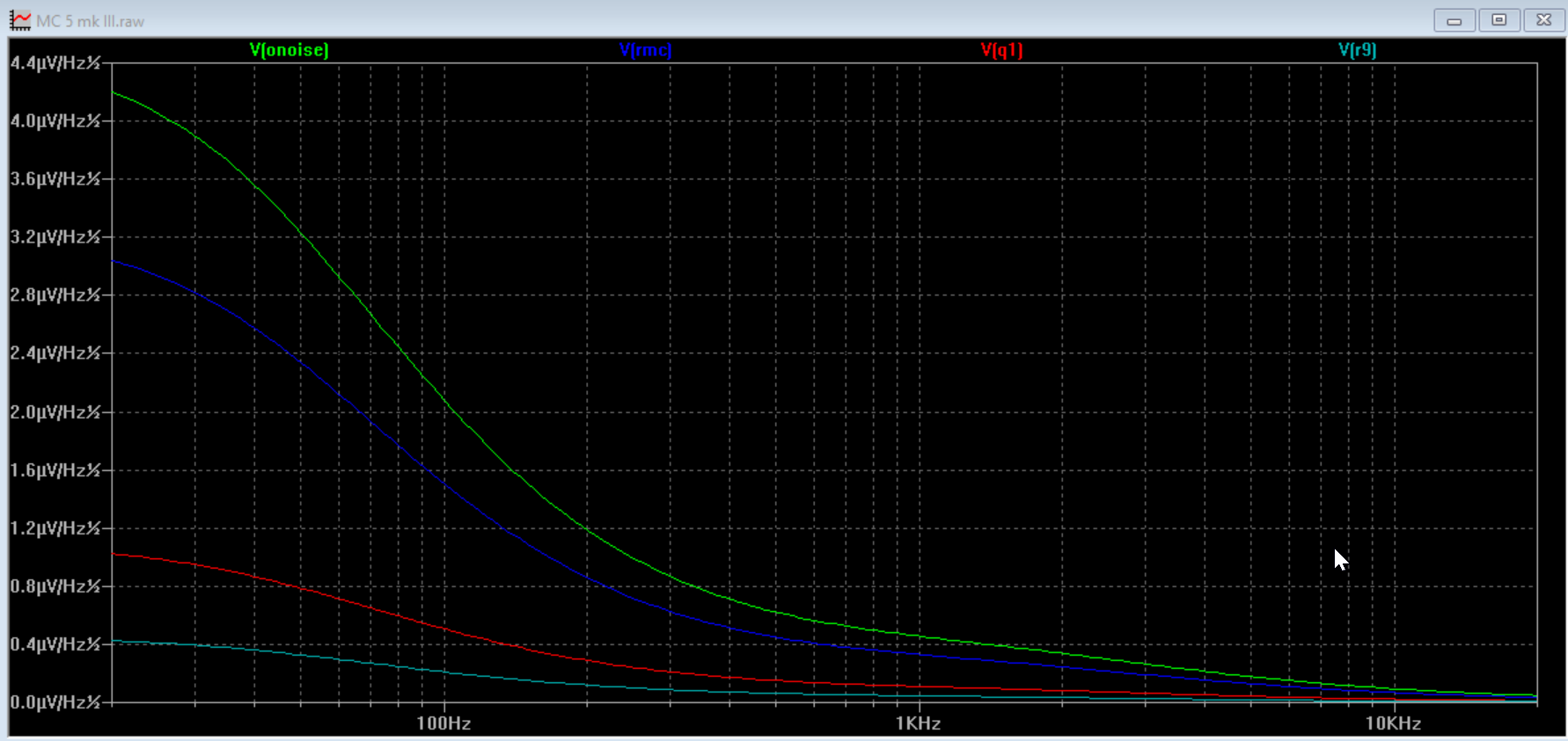

You'll also find a noise-plot which shows, that the primary noise
source is the MC-resistance (blue trace), #2 is the input-
transistors - there are 8, and I've only included one (red trace),
and #3 are the emitter resistors of the current mirrors (turquoise
trace), again only one is included. I'm afraid I'm not a noise master,
but it seems to me it could be worse. It may make sence to use
ZTX851/ZTX951 as Hans suggested.

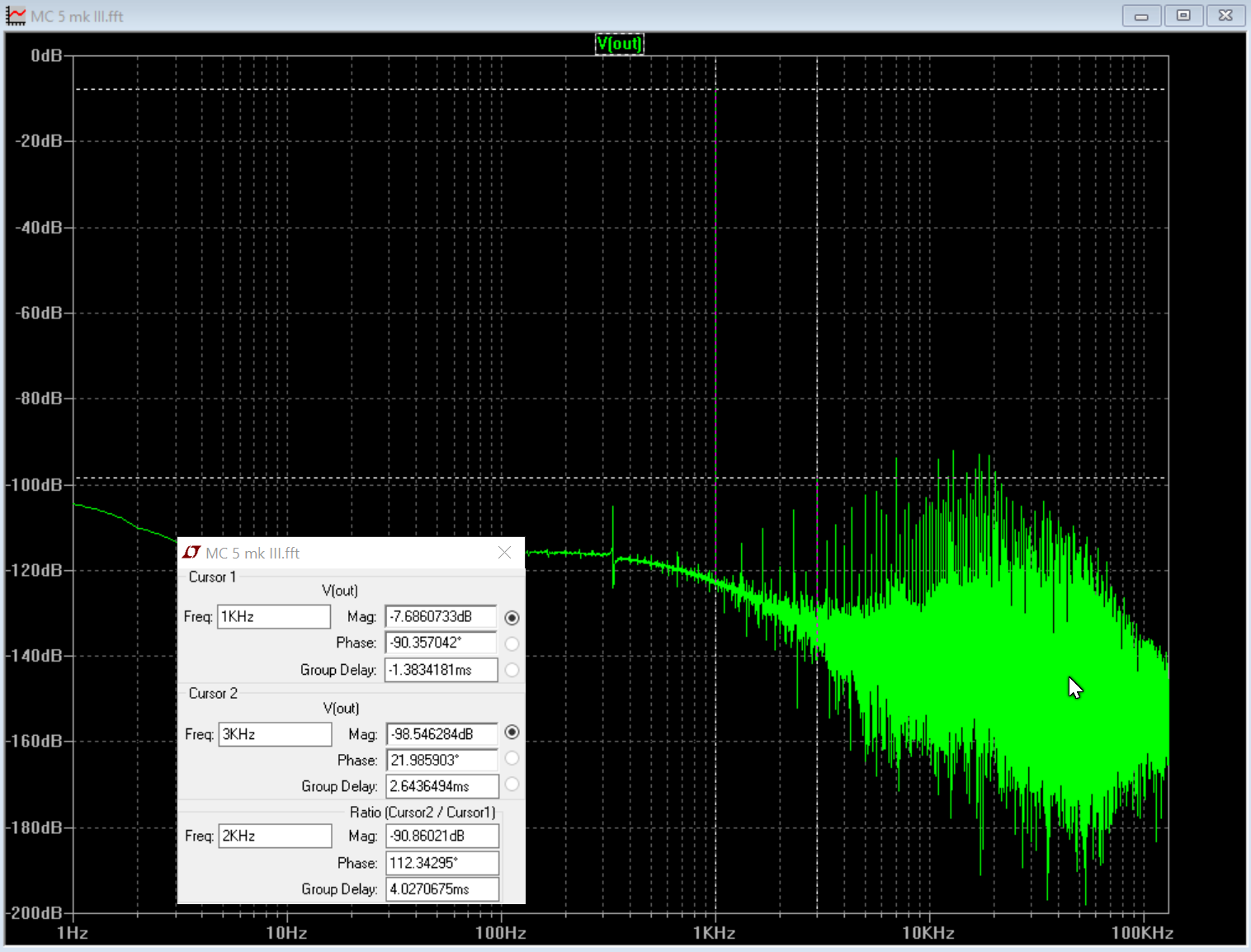

Finally the FFT of a 1kHz transient sim, which indicates a very low
distortion: the third harmonic is only 0.003% with 0.6Vp out - not
shappy.
shappy.

A few comments on your current latest circuit diagram:
Even if the BC139 is a BD139 etc, the spice model shows a Rb=0.5 Ohm.
No transistors have lower Rb's as the ZTX851/951 series with resp 1.2 and 1.5 Ohm, according to Horowitz & Hill, so be very sceptical with the outcome of your simulation.
Your input circuit looks very complex with that many transistors.
With the ZTX transistors and 7R Cart you wil have 0.5nV/rtHz RTI noise, that becomes 0.35nV/rtHz for a short circuited input.
More than adequate for 99% of the MC Carts.
My experience with the ZTX trannies is that they are all within 1mV Vbe.
You correctly named the extension with Q8, Q16 bootstrapping, this is of course also a version of cascoding.
You used a practical version keeping currents together.
The measured contribution of the current mirror emitter resistors seems a bit unlikely.
Counterintuitive, increasing their values will even result in a overall noise decrease of a few percent and vice versa.
And as a last comment, I find your servo overcomplicated. I didn't simulate it but it looks like a potentially unstable circuit, two servo's to solve one problem can fight each other.
Hans
A differential pair input stage automatically has 3dB more voltage noise than single-ended class A, since they are in series from a noise perspective.
The way the input transistors (ZTX851/ZTX951) are connected in this circuit (I forget the name of this configuration), reduces the voltage noise by 3dB as they are in parallel from a noise perspective which is much better for an MC amp: MC Phono Preamp
(note the configuration doesn't need feedback, that circuit happens to use it).
Hans, you are most likely correct with respect to the noise mechanics. As I said, I'm not a master in the noise department.
Regarding the servo: that is *not* two servos, only U1 acts as a servo, U2 is merely an inverter to give the right polarity for the bias. As it is a symmetrical amplifier without feedback, the servo must act on both the positive as well as the negative part.
Lars
Mark, you are absolutely correct. That is the price you have to pay, if you want to avoid large electrolytes in signal path.
My design is basically 4 Long tail pairs, 2 NPN- and 2 PNP-based in parallel. From a noise perspective it is equal to 2 parallel transistors in single ended configuration. So 4 times as many transistors in order to avoid the electrolytes.
Lars
BTW this is a feedback amp anyway isn't it?, the RIAA network forms a current feedback path through the cartridge impedance.
No it is not. Hence the elaborate servo.
I should have drawn it differently, what you see as a feedback, is in fact ground.
It is an transconductance amplifier driving the RIAA network. The only feedback is the servo to set the correct output voltage (=0V)
Lars
That kind of IV converter is made by feedback. The input current to output voltage ratio is set by passives (the RIAA network, cartridge impedance, 300 ohm resistor etc), and the spare gain of the differential amp is turned into more linearity.
To convert current to voltage without feedback you need to pass the current through a resistive load and amplify the voltage difference across it. Then pass that signal through a passive RIAA network.
Creating any kind of virtual ground is a feedback trick.
It is *not* an IV converter, it is a VI converter . The input (i.e. the LTPs) converts the voltage from the cartridge to current witch in turn is mirrored and amplified as a current and send to the RIAA network, which convert it to a voltage .
Creating any kind of virtual ground is a feedback trick.[/QUOTE said:
I'm afraid you have misunderstood the design. Pls go back to post #1 and reexamine the concept- and the simplified-schematics. There is no virtual ground and absolutely no feedback "trick". The only feedback is the servo to keep the DC on the output at 0, it has no bearing in the audio band.
Lars
Ah, poorly laid out schematic confused me - if one side of the diff amp is grounded but not obviously, why tie it to the RIAA network? You shouldn't have to chase down long nets looking for a single ground symbol somewhere along its length, ground symbol at every grounding point, unrelated circuit sections should have separate ground symbols.
Quite patronizing to tell others how to lay out their schematic as an attempt to mask your misjudgement.
Hans
Just reporting that it misled me. That's a statement of fact, followed by advice how to do better schematics (go check out Horowitz and Hill for where I learnt good practice here), so that others are less likely to be misled.
I admitted to a mistake, and analyzed why it happened, and offered ways to reduce the chances of such mistakes happening. That's trying to help people be less confused and less confusing.
If that makes you feel patronized I'm sorry, that wasn't my intention.
Analyzing mistakes helps prevent future mistakes.
