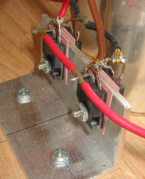

I have some MBR20200 Shottky diodes on hand and would like to build bridge rectifier with them for my AlephX. There are two single (10 Amp) diodes in TO220 pack. The amp drows about 4 Amp current (one channel) and has seperately PSU’s for each channel. I guess use of single diodes only in the bridge may be insufficient. My question is, it is possible to use both diodes from one pack paralelly and use four packs in the bridge?
Yeah, that works. I made a single bridge for one channel of A-X using 4pcs of MBR3045. The middle pin is shared, so all you have to do is connect the other two pins together, and you've got a single diode of double the current rating. Current sharing should be pretty good, as they're on the same die (I think) and thus should be closely matched within a single device. Check out my P2P construction here. A bit hasty, but it is just a test amp...
