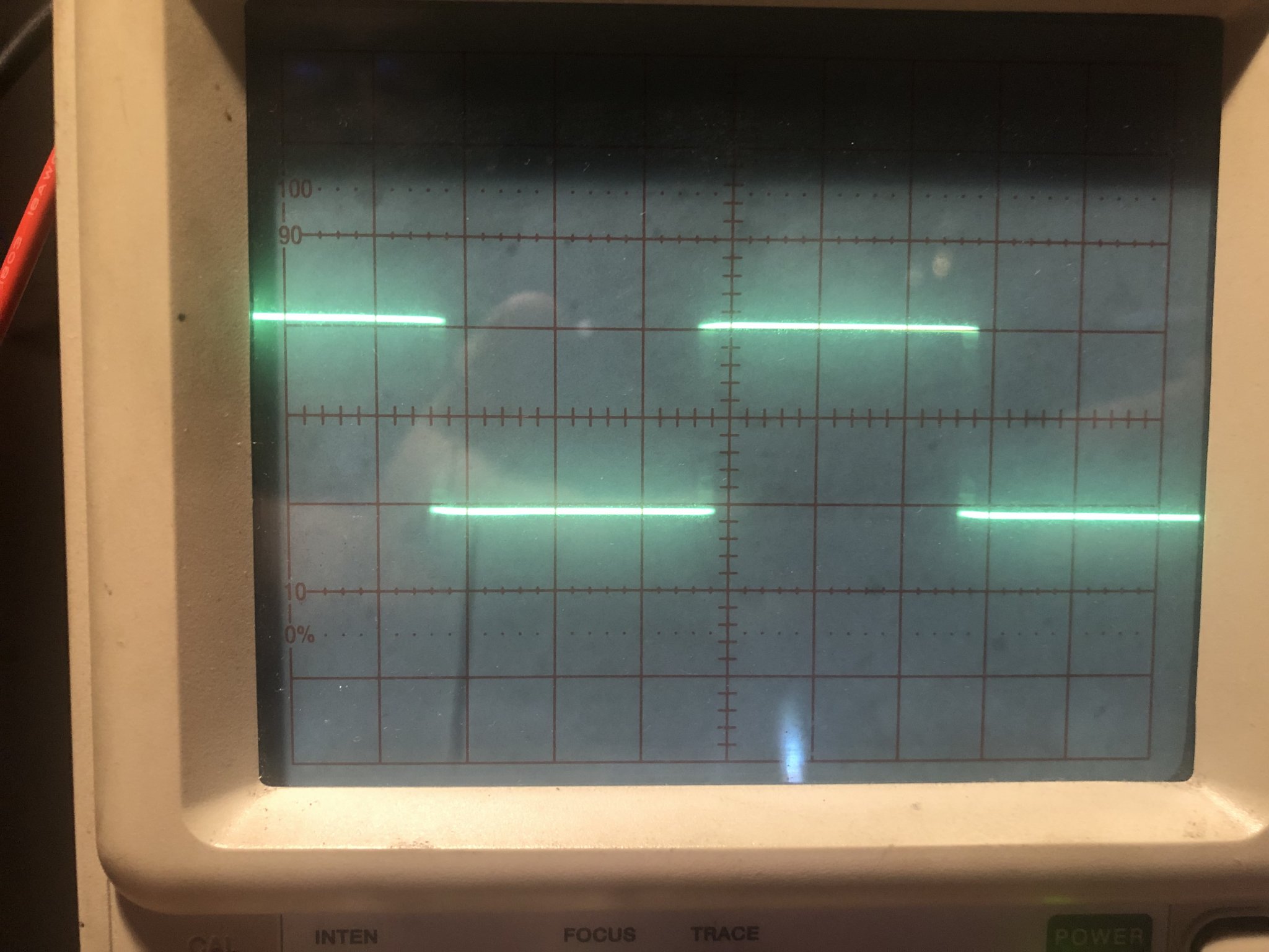

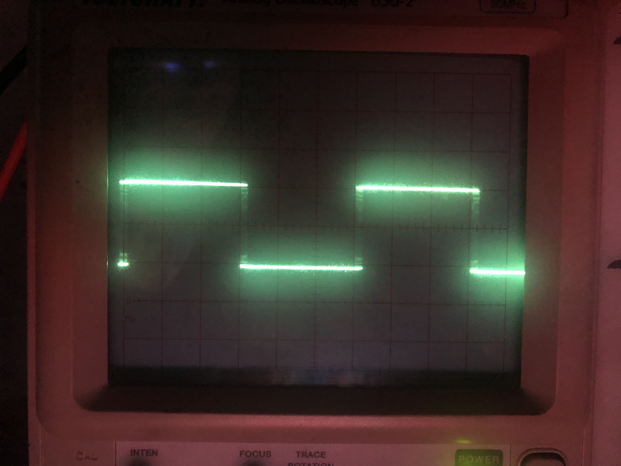

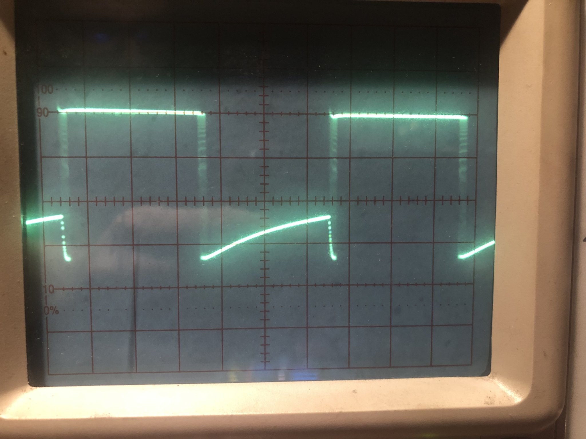

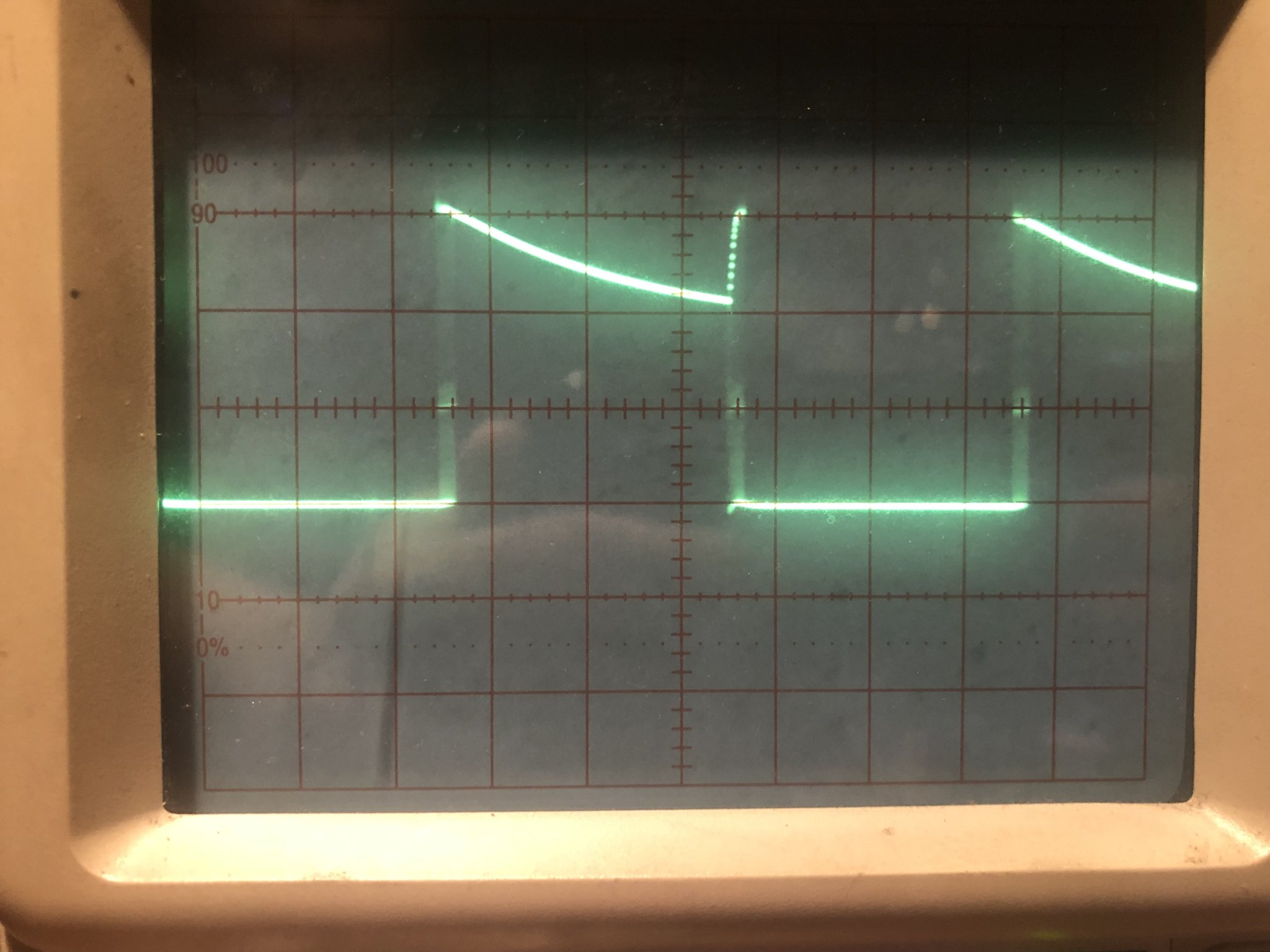

MBQuart PAB 1200.1D
With ground reference on the base of Q1A Pin8 -8.955V Pin 9 -8.955V with reference on Driver Board Ground Pin8 0.66mV Pin 9 0.00V
I also saw the pulled vias, it happened during the second desoldering of the driver Board, except for 4 connections all traces are on the other side of the board, of course I checked and repaired them. The 4 connections on the top side I repaired with short cables.
After repairing the power supply, the error pattern was exactly as it is now. Since I had not yet unsoldered the driver card so I do not assume that it is due to the pulled vias
i have just decided to remove the two output inductors and remove the bridge between G-S of Q1A. The amp turns on normally without drive but as soon as I inject a signal the driver ic starts but only as long as I inject a signal.
Measured at the high/low site gate resistor and at the drain of the output fets
