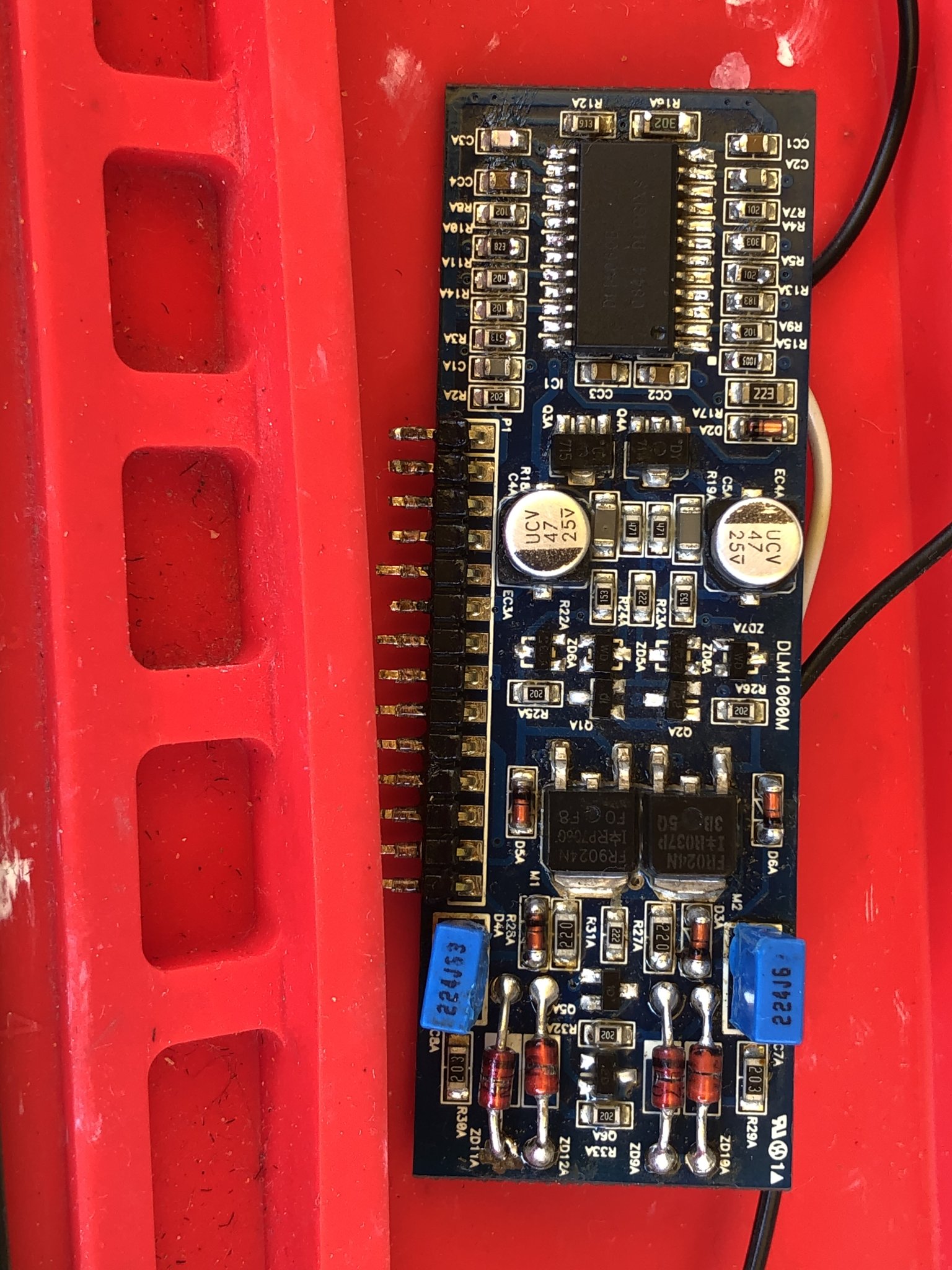

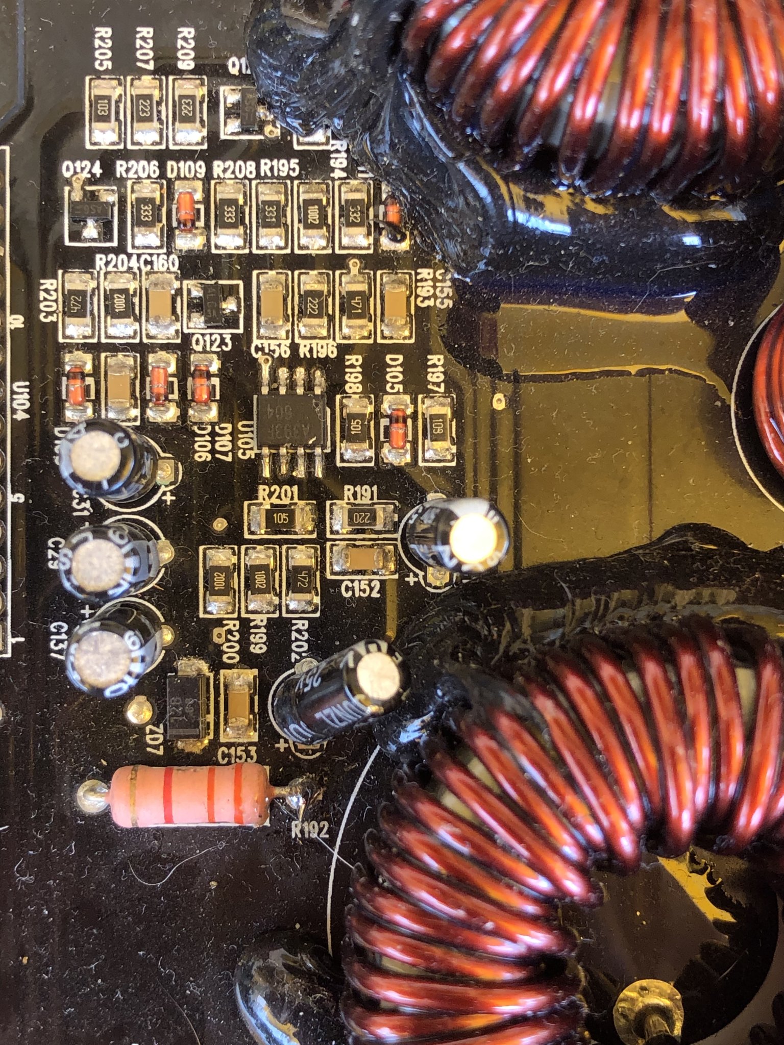

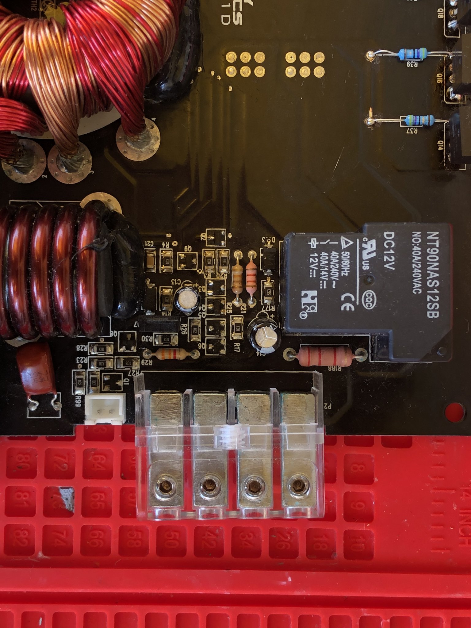

Post a good quality photo of the component side of the entire main board and the component side of any driver boards if no one can help.
Here are some photos of the board and the driver card the drive IC is a DLOGIXS DLI4060B

Which terminals of the driver IC and which resistor terminals connect to the base of Q3A? List all.
When I bridge Q1A G-S the amp turns on normally with 0,7A idle current but of course without drive signal. Rail Volatge +/- 60V and the auxiliary power supply also looks good. The volatge regulator for the drive IC also work +/- 9V
When I inject a 100hz sine wave I can see it on pin 9 but as soon as I turn up the volume I can hear a crackling sound from the drive card when I turn up the input signal further the amp goes into protection.
Pin 8 without signal is at 0V as soon as I inject the signal and you hear the crackle pin 8 jumps between 0-0,5V
Yes they reach the chip, from the +/- 9V input of the drive card I have a direct connection from +9V to pin 5 and 12 -9V to pin 1,4,7,15,16,18,19 and 23 of the drive IC. Unfortunately I didn't find a datasheet for the IC so I can't check if this is correct.
What's the exact DC voltage (precisely what your meter reads) on pins 8 and 9 (measured using the same reference). The base is Q1A may be a good reference.
I just zoomed in on the driver board an it appears that there are a LOT of pulled vias. If there are that many pulled vias, this may be very difficult to repair.
