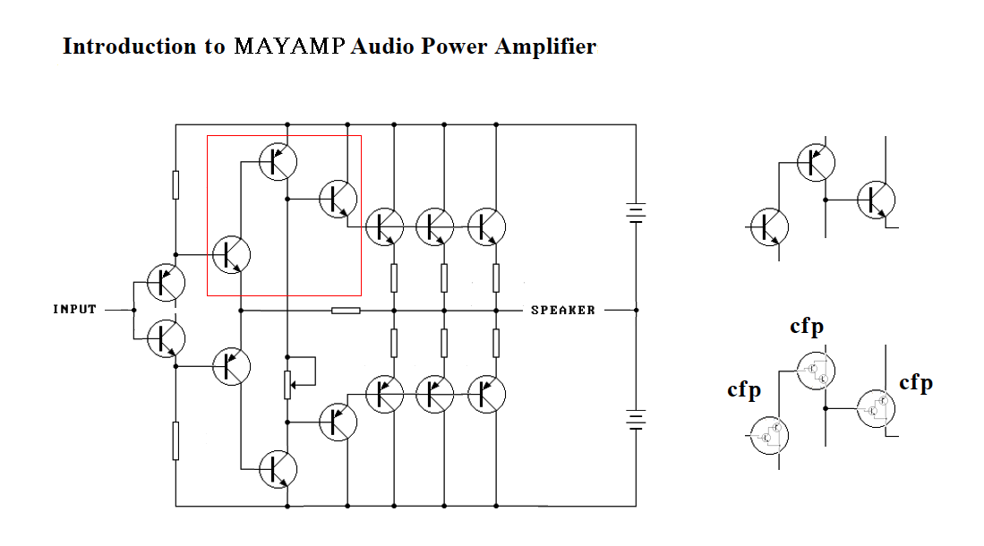

MAYAMP - full CFP stages
With this project, we exploit the characteristic of the unity gain of the CFP
in order to equalize the gains in each of the two branches 😀
complementary architectures in the most difficult challenge is to unify the gains PNP and NPN
using the CFP in the input - voltage - output stage
will sound more balanced between two half-waves
because this behavior is guaranteed locally 🙄
