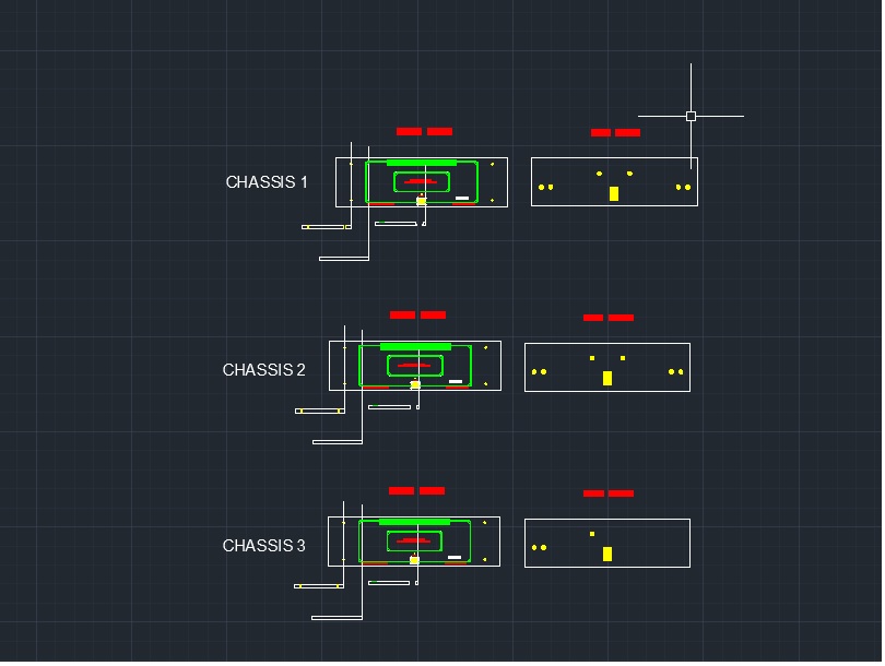

Try do download a drawing of mine made for the Maya.
maya4 (1).dwg - Google Drive
This will maybe let you start with some basics on it, at least dimensions.
SAF
Thanks, SAF, maybe we need to go off-line for any more discussion about this (to stop messing up Hugh's Maya thread) but attached is what I saw when I opened your Maya dwg. 😱
