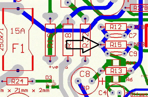

4 dB reduction would definitely help a little. Where is the resistor located? And would this affect sound quality in anyway? I guess it will increase feedback?
It sits directly above the 100uF shunt cap C17 at the bottom center of the PCB. It is designated R17. On V4.23 fb shunt is written above the resistor.

I'm thinking of trying out this mod. Which exactly is the resistor? The one that says NFB or GFB on the board?
No the gfb and NFB resistors should be high quality carbon composition, Allen Bradleyor Takumi.
To have gain put in two 5k resistors from input to ground with signal to top resistors and midpoint to amp.

Oh, I think there was a misunderstanding. I was thinking what you described in your first reply in this thread. Increasing the feedback shunt 120R resistor to 180R. Where is this one located?
