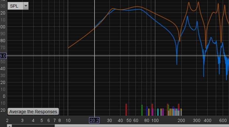

@maxolini Is getting quite good at illustrating these 6th order parallel boxes. I thought it appropriate to aknowkedge/appreciate him as he’s very willing to do this for persons who have existing designs and can help him develop his CAD skills.
I wish I could just scale up the size and proportions to any driver but it’s very intersting how different things like the 18ds115 or dayton audio Ultimax under/over damp the heck out of things that end up so ‘perfect’ with some drivers .
I also find it intersting to geek/nerd out on that cancelation frequency and the other resonances and find they’re directly related to the actual distance between the drivers(I’m new at this)
