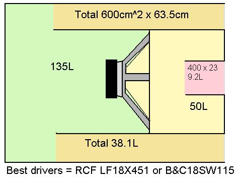

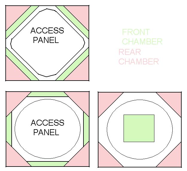

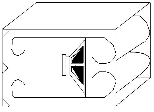

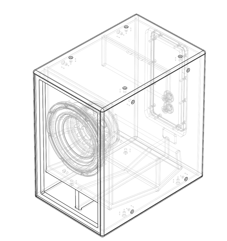

I'm not sure how the outer chamber would affect the tuning of the inner chambers though.
It will affect their tuning. The output port is basically in series with the inner ones.
The first image looks like a design that I was considering a few years ago, except that the shelf vents at the top and bottom were actually vents for the front volume, and the rear volume was vented directly into the front volume. It looked good on paper, particularly as the arrangement allowed for a design where the driver could be accessed by removing a rear panel.
Well originally I wanted the driver to be front mounted, because often the gaskets around the back of woofers are superior to ones on the front, and it also allows the woofer to fall into place when the cab is on its back, but that latest port design allows for two side access panels behind the driver, and also room for a bracing grid like in the dB designs (although the dB designs are front mount and the front chamber has just a square hole without any port length!)

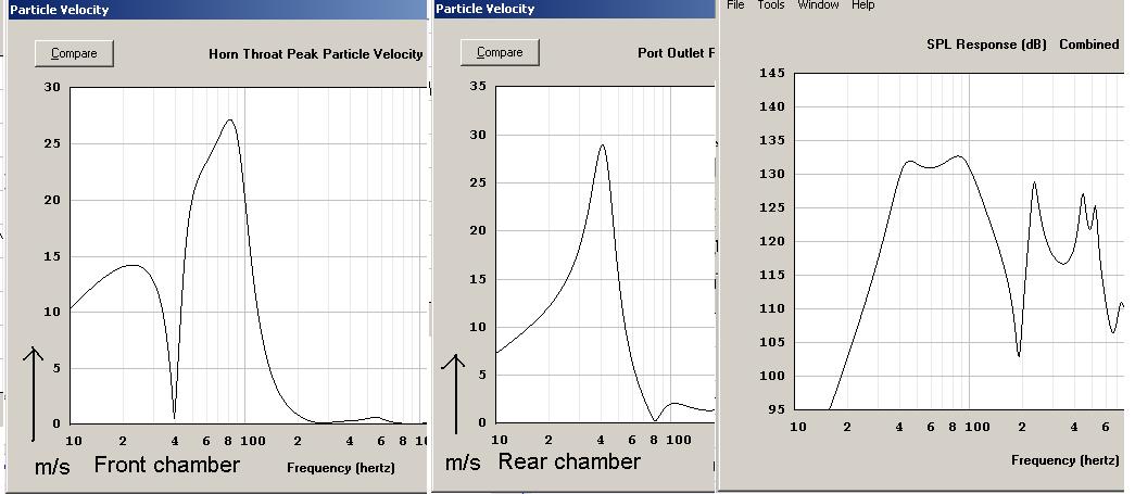

what exactly does this port compression do what all guys here are talking about?
To double the amplitude pressure (+6dB) of a sound wave produced by one speaker, excursion and port velocity will generally double. This will normally require about 4 x the power as you need to increase the stored energy in the air by 4 and the kinetic energy of the speaker cone by 4 because the velocity has doubled, but the frequency is the same.
Moving air however, needs up to 8 x the power to overcome air resistance for every doubling of velocity (air resistance is proportional to speed squared, and power you multiply by speed again). When port speeds get too high, this becomes the dominating factor in power consumption, and eventually you'd need 8 x the power for +6dB through the ports!
On top of that you'd get an audible chuffing/hissing sound if the port is too restricted.

I like your enclosure design from Post #5.
18 Sound has a similar bandpass for a 21" that uses a single duct from the back to the front. That one may be a easier to build, on the other hand, your design reinforces the side panels very well. I have no clear idea if one large port radiates better than 4 equivalent smaller ports, maybe somebody can shine some light on this.

If you are going for a shaped port (Art's example in Post #6, Polk's Power Port or JBL's Jet Port) a single port would be easier. Ideally the shaped ports seem to have as their rationale an improved transition from duct to box and duct to outside.

I quite like the 18Sound enclosure. Cutting circles in a front access panel for stock flared ports could be quite a good idea.
It looks to go lower than mine, it appears to be tuned around 30Hz but mine appears to be louder above 40Hz, real world test pending. Whilst it is possible if you spend some time calculating angles, it could be difficult to flare triangular corner ports, hence the design in post 18 with two flared slot ports for the ~40Hz chamber and 1 for the ~80Hz chamber, and I still should be able to cut ply thickness down between 9 and 12mm.
Braced flexiply and it's almost a W-Bin!

Comparisons of impedance and SPL between my design and the Eighteen Sound 21".
Also impulse data and excursion at 2.83V

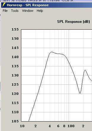

Critique.
I'm assuming the graph at 90Hz is a "wrap around" the scale and not a swift motion through 360 degrees, otherwise the group delay chart would spike right?
True it does move over the passband from -45 to -180 and I don't think this cabinet would sound as tight as a stack of front loaded horns outside.
I've found in some of my travels that the room is more responsible for the so called "slow bass" than the enclosure, with many kicks being blurred together by room resonances. My flat (and car probably) happen to be a lot better for tight sound than my parents' living room for instance.
The impulse chart does show a bit of resonance at 40Hz, and if the tops are lined up with the subs, you'd probably need to reverse polarity on this subwoofer to get the crossover in phase.
Correct on both counts.
You might find that altering the default-calculated offset delay correction from 4.0 msec to something different, will remove the 90 Hz phase wrap.
Well in that case it seems to have a smooth phase response from -60 to -180 in a corner and -45 to -180 not in a corner in the pass band I'm concerned with.
It may or may not require a reverse in polarity depending on where the top speakers are.

If that's a picture of the "Resopump", then how is it a BP alignment? Where's the front chamber? Its cross-section looks more like a RLH than a BP design...
I was thinking that it was more like a mini scoop cabinet with a slight block of the mouth.
As my design does not have an exposed driver, wouldn't it filter harmonic distortion much like a front loaded horn does? Thus it wouldn't sound too muddy, although it does have a slight 40Hz resonance in the impulse response.
If it sounds as good or better than my bass reflex Kappalite 3012LF cabs I won't be too dissapointed if it doesn't have the "punch" of a group of front loaded horn cabs outdoors.
