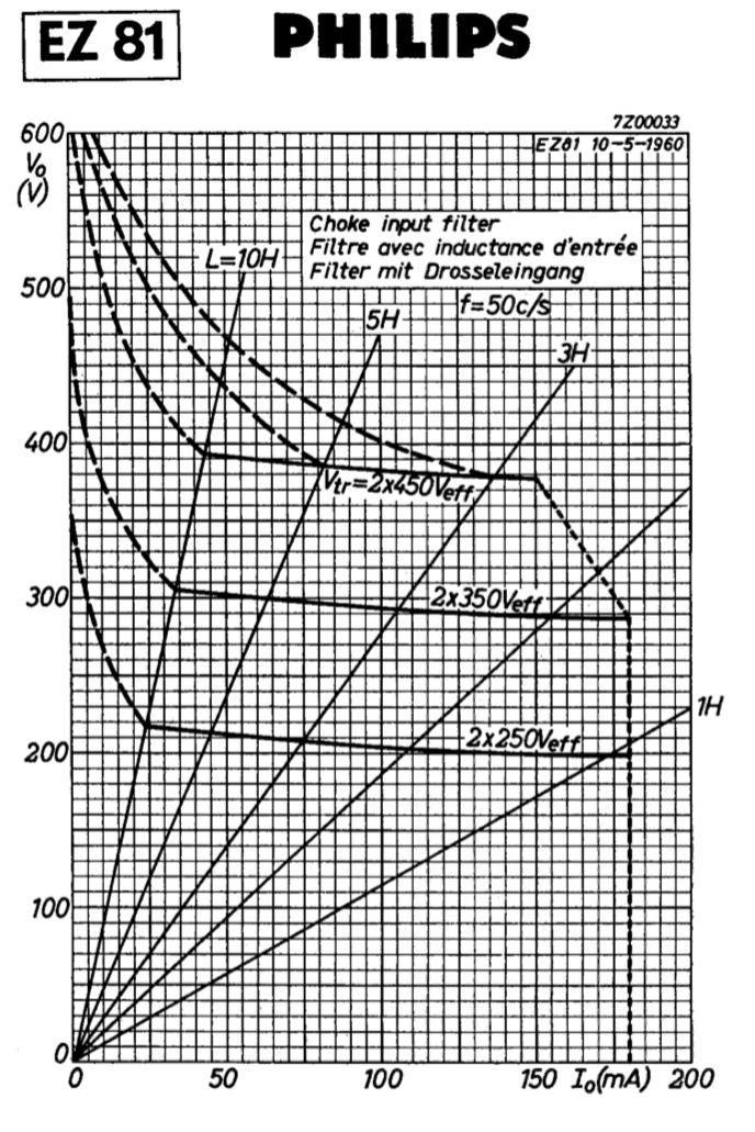

Is their a practical limit to the inductance of the choke used in a choke input filter after a rectifier?
I am trying to understand the attached graph for the max rating of an EZ81 using a choke input filter.
It seems to suggest that the larger the coke (in henries) used the lower the max output current rating is at a given voltage. I have never seen this mentioned before.
Am I just misinterpreting the graph?
Thank in advance for your advice.
Cost, weight, size, I*R drop.
If the current in a choke-input filter is too low, it works as a CAP-input filter, with much higher output voltage.

The max. O/P current of a PSU is ultimately linked to the capabilities of the power trafo.
A good approximation for choke I/P filter critical current, in mA., is given by V/L. Notice that smaller critical currents are associated with larger inductances.

The graph that you posted is both for the safe operation of the rectifier, and to show the predicted DC out with a given RMS in, and choke inductance.
It does not show the required Critical Inductance to make the filter be a true choke input filter. You will get more than Secondary RMS x 0.9DCV output with a choke that is less than critical inductance (again, you have to take the additional voltage drops due to the rectifier drop, and the voltage drop of the choke DCR).

I think the graph's lines showing choke inductance values is meant to represent the minimum inductance required for a particular output voltage-current capability on the given transformer voltage characteristic curve.
Eg. when Vtr=2x250V, at least 1H is needed to allow 200Vdc - 180mAdc loading capability; where a lower loading current would not maintain critical current, and a higher loading current would exceed the diode capability. Whereas 10H would be needed if loading was down at 25mA; where a lower loading current would not maintain critical current, and a higher loading current up to 180mA could be applied without exceeding the diode capability.

trobbins,
50Hz, 100 Alternations/sec, full wave rectification:
420/180mA = 2.33 Henry, Minimum for true choke input filter.
420/25mA = 16.8 Henry, Minimum inductance for a true choke input filter.
Or, those are not True Choke Input Filters.
Putting just any random value of choke in front of a cap does not make it a true choke input filter.

You can use a choke that is smaller than the Critical Inductance value.
But the currents will be Transient currents, very similar to Cap input filters; not Average currents that true choke input filters are.
Undersized choke input filters will give DC Volts output of Larger than 0.9 x RMS Voltage, and Smaller than 1.414 x RMS Voltage (when you take into account the additional DC voltage loss due to the Rectifier Drop, and the additional DC voltage drop due to the choke DCR).
A 2x250VRMS secondary that has 0 Ohms DCR, will blow up the rectifier if you use less than 1 Henry choke, and use more than 180mA load current.

The minimum inductance is not for protecting the diode , for that you must have the nominal series resistance , but to achieve continuous mode operation , V medium = 0,9xVrms and "regulation" . Dependent on current and voltage like in the graph .
So for an PP amplifier you should use high inductance for the voltage to remain stable from no load idle current to max power .

OK , if you want don't use any resistance ... I assumed that the choke has no significant ohmic resistance and the cap is big in our days . The reactance of the choke could be or be not enough at startup .If it is saturating at that surge current certainly not .
By the way, the graph did not show the critical inductance values for the currents and voltages on the graphs.
They showed the Maximum Safe values of inductance, versus voltage and current, when there is no series resistance.
Series resistance in either a choke input filter, or in a cap input filter causes droop, when the current goes up.

From the graph:
250V RMS = 353.6V peak
1 Henry @ 100Hz (50Hz mains x 2 = full wave rectification) = 2 x pi x f x L
1 Henry is 628.3 Ohms of inductive reactance (at 100Hz full wave).
353.6V peak / 628.3 Ohms = 0.563 Amps peak (a little less than that, because the waveform has higher frequency harmonic structure, so a little higher total effective inductive reactance than 628 Ohms).
After the choke starts charging the first cap, the peak currents go down very fast.
Page 5 of the Philips EZ81 data sheet shows a schematic of the necessary resistance of the primary, secondary, and added resistors in each plate circuit (and shows a capacitor input filter).
There is no spec and no diagram that shows resistance for a choke input filter.

There are a few simplifications for calculating critical inductance. The equation that Philips used for the EZ81 datasheet is L(crit) = Vo / (942 x Io), where Vo and Io are the DC load conditions, and 942 = 2 x pi x 100Hz x 0.667. And after checking the maths, I can confirm that the Philips datasheet does show critical inductance 'lines'.
Choke input filtering may be a concern for a hot turn-on event, depending on the situation.
For a normal power on situation, the resistance of the valve diodes fall from a high value, and the choke current builds up from zero typically without any gross overshoot. In simulation land, PSUD2 manages that with a 0.5 sec ramp up of supply levels. I haven't done, or seen, any examples of ramp up conditions for a cold start-up with a choke input filter.
For a hot start-up, after a few cycles the choke current can peak well above rated DC current level, and the affect of choke saturation on inductance dynamically changes, and the diode surge current may exceed its datasheet rating. PSUD2 can provide some insight to what may be experienced by changing the inductance, but that requires that choke inductance is measured for different levels of DC current and at DC current levels that significantly exceed the rating. I haven't seen this topic discussed in any vintage book afaik.

trobbins,
Interesting.
But I am not sure we are there yet.
The derivation for the number 0.667 is 2/pi
That is the term for the average voltage value of a pair of full wave rectified alternations.
2 x pi x 100Hz x 0.667 = 2 x pi x 100Hz x 2/pi = 400.

If you use 942/mA, and 190mA, that is 4.96 Henry.
If you use 420/mA, and 190mA, that is 2.21 Henry.
I still am not satisfied with the interpretation of the graph.
The graph in Post # 1 shows 1 Henry, 190mA, 250V in, and 200V out.
250V x 0.9 = 225V. 225V - 25V rectifier drop = 200V
So that means that the rectifier has only a 25V drop when the DC current is 190mA . . . I doubt the EZ81 can do that.
I think that 1 Henry is less than Critical Inductance on that graph.
I use solid state diodes, and choke input. If I account for the voltage drops caused by the 'primary DCR x turns step up ratio', and the 'secondary DCR', and the 'Choke DCR', and the 0.6V - 1.0V diode drop, it works for me.
60Hz power mains (120Hz full wave), 350/mA, = critical inductance.
With a 350V-0-350V secondary, and critical inductance choke input, 350 x 0.9 = 315VDC.
The output is 315V - the drops caused by the primary x step up ratio, secondary, and choke DCRs.
It works out good.
Actual circuits prove the numbers.
What am I missing in my calculations and measurements?
It works out good.
So, from Post # 1 graph: 200Vo / (942 x Io), Where Io is in Amps (not mA).
200 / (942 x 0.19) = 200 / (179) = 1.1 Henry
Now we are getting there.
That still does not account for the differences in the critical inductance formulas.
50Hz (100Hz full wave) and 60Hz (120Hz full wave) should only disagree by 5/6, or 6/5, depending on which frequency you start 'with', and which frequency you compensate 'to'.
All I know is that for 60 Hz mains (120Hz full wave), 350/mA always works.
And for 50Hz (100Hz F W ) 420/mA works.
For 50 Hz mains (100Hz full wave) 420 /190mA = 2.2 Henry.
That is a 2:1 disagreement of the two formulas.
. . . Perhaps it has a very large margin built in.
