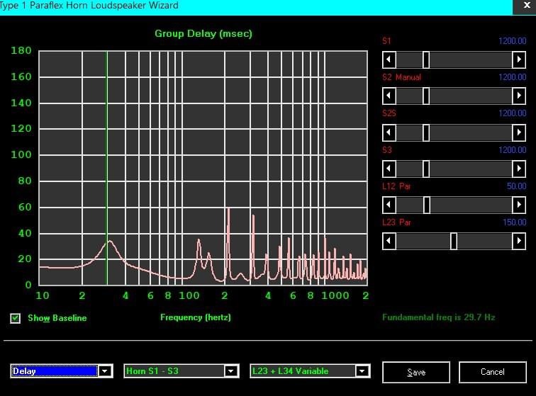

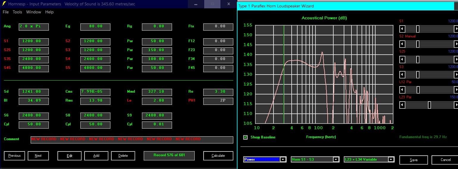

I can’t believe how huge these things can get and have less group delay than most bass reflex boxes or TH(??). The tapped pipes connected in parallel that share the second resonance are truly ‘unique’ (imHO)

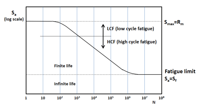

As looks like by trial and error people find drivers that can survive a high compression enclosure
It's not trial and error, but it's engineering knowledge. The point is that it's expensive to know the fatigue curve for the material and for sure companies may evaluate them, DIY is a different history and it's more trial and error.
Check attached image, it's a generic Wöhler curve used to define material life in terms of fatigue.
You can consider the Y-axis being material stress and X-axis being life in terms of cycle.
Each time you speaker receives and Peak voltage from the amplifier, it will generate in cycle on the drive cone as fatigue. If this peak is "low" according to material under usage, probably the component will have infinite life and will never break.
Once you apply the same driver into TH or any other design that will increase cone stress, Hornresp is capable of simulating it, so based on fatigue knowledge as background the user can take some decisions for their design.
Cone material also depends if the enclosure is planned to be used indoor or outdoor, because paper and water and not friends, right.
Sometimes, people don't share all those information, but it doesn't means that they haven't been taken into account.

But!! Just barely change the length and/or size of the high tuned resonator section and watch how quickly it gets UGLY…. very quirky as the path lengths no longer match the frequencies (especially at the second resonance the entire pipe shares)

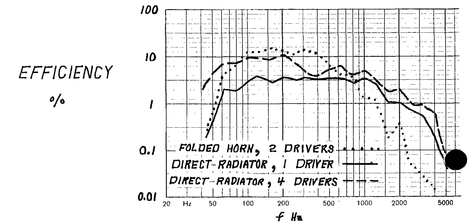

Multiple drivers in smaller cabinets can exceed the efficiency per enclosed volume of horn enclosures

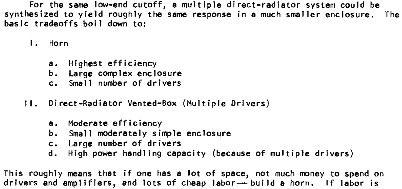

In 2016 I wrote an e-mail do Mr. Don Keele Jr. about the EV T18 project and other stuffs and he replied to me:
"I’m definitely in favor of multi-driver vented boxes over horn-loaded system. Attached is a paper I wrote back in the dark-ages of 1976 when I was at EV. It compares several systems one-of which is the Sentry IV B cabinet"
See attachment.
See attachment.
