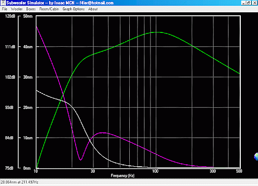

The first simulation is for a 12" Peerless XLS in a 40 liter box, 12" PR with standard 425 grams total on it-nothing added. 40 Volts is fed to it. that is 400 watts into a 4 ohm load.
The white line is the PR excursion,
the puple line is the driver excursion
the light green line is the total speaker response
See how 400 watts pushes the PR somewhat past it's limit of 22 mm:

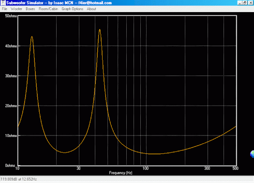

Figured you might as well get an impedance curve, which of course will not change with the power fed into the speaker.
As you can see, it is about 4 ohms at the tuning frequency, 23 Hz, and around 120 Hz. It goes sky high at other frequencies.

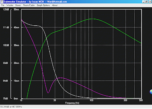

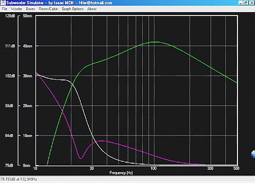

Try It With 2 Passive Radiators
Here is the Subwoofer Simulator printout for the 40 liter box with two 12" PRs. The power fed into this is 400 watts-actually 40 volts into a 4 ohm load. (Subwoofer Simulator lets you program in the voltage-it is up to you to decide what the wattage is at that voltage). I had to almost double the weight-750 g for the two, or 375 for each PR-to maintain the same tuning frequency.
Incidentally, here is the link where you can download this freeware program by our own member, F4ier:
http://www.geocities.com/f4ier/newsubsim.htm
It has over 20 different curves, which you can enable or disable at will.
I'll let others analyze for now. Overall, I would say that you can probably get away with a single PR if you feed 200 watts into the subwoofer. If you want to feed 400 watts into it, then you probably need two PRs.
