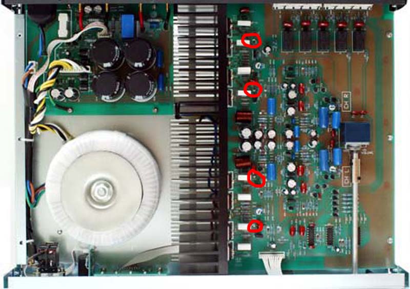

i have attached a blown up pic of the internals (i cannot find a schematic), i was measuring at the emittor resistors and when i check the standard settings noticed that at the resistors there was an imbalance 13 : 17 between left and right. I noticed a couple of raised pins on the board (of the type that look like they are there for attaching alligator clips to for some reason) but didn't measure there until last night. I find that when i have balanced the current at the resistors that if i measure at those 2 points they read out of balance. I assume this is the correct point to measure the bias from, i have included a blurry pic with the points circled, i can take a better pic next time i have it open however. the points appear to be on the same piece of trace as the matching resistors on each channel.
the only other amp i've biased was an a400x pioneer and that from memory just had a single resistor per channel.
if you can point me in the right direction i promise i will set it back close to factory and not bother you guys again (until i start on the DIY project).
thanks again, it's good to know you guys are here.

You better measure the voltage across all emitter resistors to make sure that one transistor is not carrying a lot more current than the others. Then adjust based on the transistor that gives the highest current reading, and check the others after you are done (when it's all stable) so they are not running low. If you do have a large imbalance then it's time to try to figure out why..
Thermal compensation in that amp may be poor, but you DO need to monitor the bias for a minimum of 30 minutes (an hour or more is better) before you put it all back together...just like ACD said.
I'm not sure what you feel you're accomplishing by cranking up the bias, but I'd surmise that any sonic gains are likely in your head. If you want a Class A amp, build or buy one.
