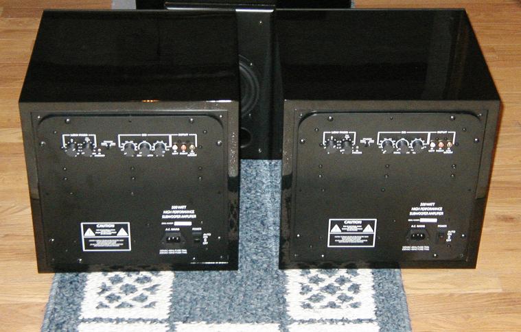

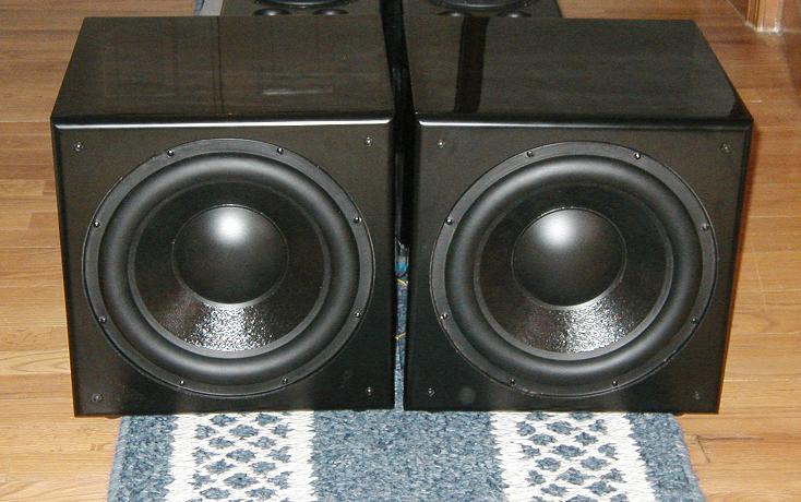

My Trio12 sub from about 2010 in PE 1 cu ft internal boxes, don't know why they won't inline here:
NLA Trio 12" data sheet in .pdf: http://www.juoiga.eu/images/datasheets/css_trio12.pdf
When I demoed them, quite loud with War of the Worlds and other HT tracks it was easy
to light the yellow clip light on the 500W amps.
The floor felt like it was moving 1/4" and the picture window even more.
Unfortunately, we also smelled epoxy or enamel toward the end and the driver is supposed
to have a metal VC former.

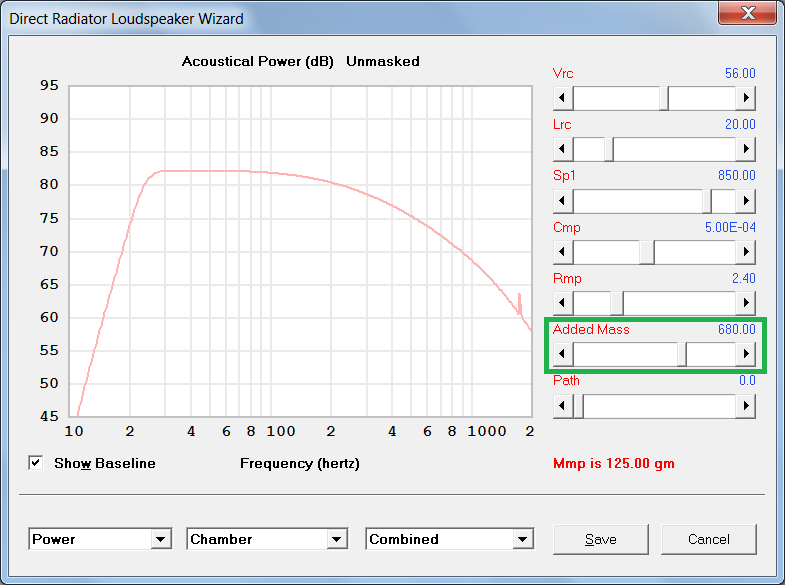

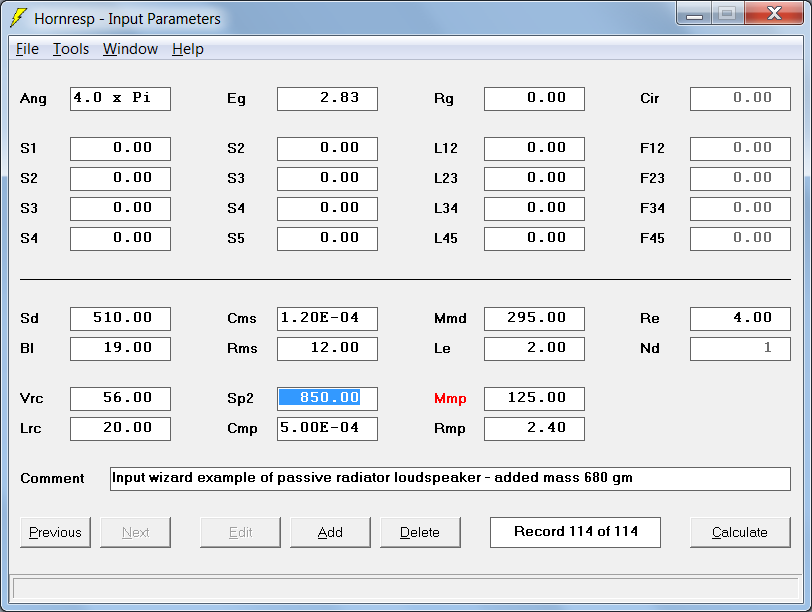

1. Open the Hornresp Help file.
2. Search for references to passive radiator using the File > Find menu.
After reading the relevant information in the Help file...
3. Create an example passive radiator system using the Help > Input Wizard menu accessed from the main input window.
Thank you David, very appreciated. I'm almost there, but the SP1 to SP9: that is the total area of the passive radiators? SP1 = a single one, SP2= 2x radiators, etc.. ? I'm not sure how to calculate everything and i cannot edit from the input parameters, only from the LP wizard.
The Sp, Cmp, Mmp and Rmp parameter values are for a single passive radiator only (normally taken from the manufacturer's specification sheet). When multiple passive radiators are used, Hornresp automatically adjusts the values inside the program as required. It is no different to the way that the parameter values Sd, Cms, Mms and Rms are specified for an active driver.
That is very strange indeed. If the record is in Edit mode, it should be possible to edit all the input fields, as shown in Attachment 1.
Incidentally, it is very easy to find the optimum added mass (for each passive radiator) by simply adjusting the Added Mass slider in the Loudspeaker Wizard.
Sorry David, i didnt express myself clearly.
What i meant is i don't understand what ''Sp1'' stands for compared to ''Sp2''
also, that switchable Sp1, Sp2, Sp3... Is not editable from the input parameters, at least on my side. But it is from the Wizard. Probably meant to be like that, though!
