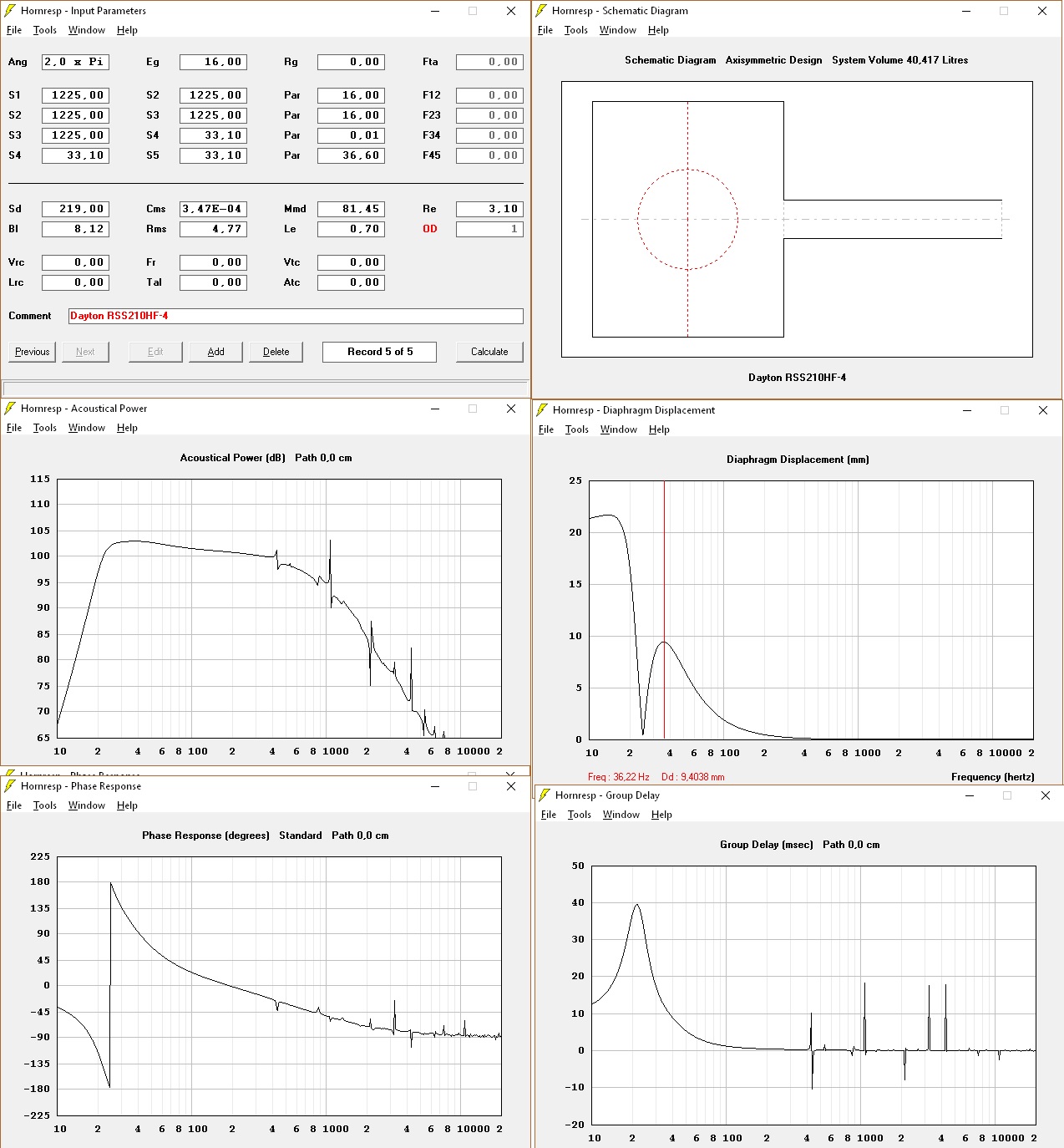

Edit:
Added a classic ca 90 liter BR just for fun. 110db in halfspace at 25hz ok or do you need more?

30L can give you two beefy 8" subs (or one 10") ported to 30Hz with a 4" port or a couple of 12" beefy passive radiators. 1000W or so should give you decent output while staying within Xmax.
I think that should beat the CM9 S2 by at least 6dB.

Port is a bit small. Hard to find suitable 8"s, might find some 2 x 6.5"s. Better to go up to a 10" and 55 liters.
This is in halfspace as usual.
Edit:
Can certainly understand the request for anything else than a BR box, but at this size, and with these design criteria, it will be really hard to get it right no matter which path you choose. A chuffing port will at least allow the drivers to cool down a bit.

A single Peerless SLS 12" can get there in 55 liters.
Peerless by Tymphany 830669 12"

Just trying out the Dayton Audio DCS255-4 a bit. you get 110db in halfspace flat down to acoustic impedance peak at 32hz. 51 liters
