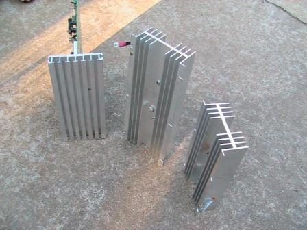

Speaking of heatsinks, would anyone be interested in including them in the kit? Here's what I was thinking:
http://cgi.ebay.com/ws/eBayISAPI.dll?ViewItem&category=31489&item=7527192673&rd=1&ssPageName=WDVW
Have him cut 3" pieces. One piece for each amp (3 x 5 3/8 inches). 3" would be $4.38 each, plus shipping charges out course. Could go to 4" for $5.84 each.

That sound like a great idea! If 4" can dissipate enough heat I would be in for that.
Anyone else want to offer an opinion of heatsink size/have interest in them? I can add it to the Wiki and consider it seperate from the main kit.

Heatsink: I Suggestion to use a type with 1-1.2 °C/W of Thermal Resistance, with vertical development ( like NS- AN1192 by BR100 mod. )
