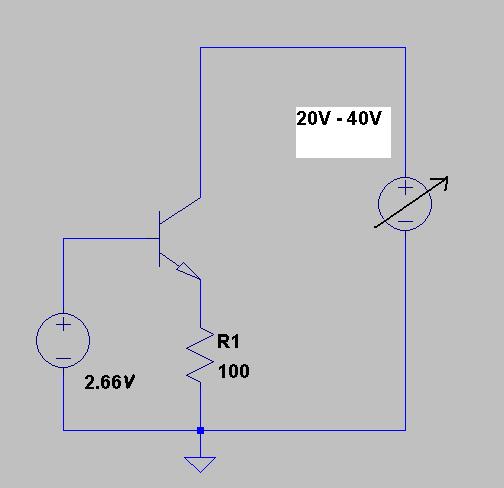

Attached is a less extreme example of a transistor biased at 20mA, with a 100 ohm emitter degeneration resistor. Lets suppose again that the transistors early voltage is 100V.
If the collector voltage source is varied from 20V to 40V, how much will the collector current vary?
Are you still going to maintain that the transistor looks like a 5k resistor, connected between the collector and emitter?

syn08 said:From this perspective, for small AC signals, there is a 5k resistor between the collector and the emitter and everything I said holds.
Well I maintain that everything you said certainly does not hold and you are avoiding my rather simple question.
For ac signals the collector impedance is a great deal larger than 5k.
You were wrong in another thread when you told Waveborn that the collector (output) impedance of his current mirror was simply equal to VA/Ie, and, as far as I can see, you have made the same mistake here.
And your calculation above that determines that the “LF gain” of the Otala VAS “is about 670 or 56dB” with the two 2.2k load resistors (which is, in reality, a little over 20, or ~26dB) simply makes no sense whatsoever.
Now lets get back to my example. I've got a 1kHz sinusoidal voltage on the collector with a DC offset (varying from 20V peak to 40V peak). There's an AC component there to make you happy.
Please tell me how much the collector current varies.
Glen,
If by "collector impedance" you mean the "small signal output impedance" then you are correct. It would certainly help if you would brush a little your listening/careful reading skills; First, Ro IS NOT the output impedance. Ro is the impedance between the collector and the emitter that models the Early effect.
You changed "a little" the problem, now you are asking for the OUTPUT IMPEDANCE of a degenerated common emitter circuit. The answer is (with a small approximation):
(1) Zo=Ro*(1+Gm*(Rb'e||Re))
Before plugging in some numbers, please note that the effective degeneration is NOT Re alone, it is Re||Rb'e. And now, some numbers:
Ic=20mA
VA=100V
Beta=100
Re=100ohm
Then:
Gm=Ic/Vt=20mA/0.026V~800mA/V
Rb'e=Beta/Gm=100/800mA/V=125ohm
Ro=100V/20mA=5kohm
Rb'e||Re~56ohm
Note that the effective degeneration is about half the 100 ohm resistor, and that's simply because of the low Beta and high collector current.
Therefore:
Zo=5kohm*(1+800mA/V*0.056kohm)=5kohm*46.8 that is about 240kohm.
This lies between what Scott mentioned as a rule of thumb.
Now, back to Wavebourn's high current mirror, you would of course note that, in terms of the small signal output impedance, the degeneration is less effective when the collector current rises. Assuming a 200mA current mirror, and using the same numbers as above, the effective degeneration resistor would be only 10ohm! And you can increase the emitter resistor Re until the cows come home, this won't help a iota. Combine this fact with a low Ro (because of the high collector current) and assuming the same numbers as above, the output impedance will be no larger than 50kohm. To me this is crap, but YMMV. Of course, the solution is to use high Beta devices and also high Early voltage devices. Now, for a low current current mirror, the degeneration is controlled by Re and changing Re may significantly change the output impedance. Of course, the higher Re the higher the output impedance.
What I was talking re: gain was always referred as "intrinsic gain", not the gain of the entire stage. But that's already a different story, it's 4AM in the morning here, I need to get some sleep 🙂 A final note: you can re-arrange (1) above and put it in the Y=Yo*A/(1+F*A) where Y stands to the output conductance and identify F; this would be the feedback view of a degenerated common emitter circuit. You could then identify when, from a feedback perspective, is the local feedback loop gain large enough to consider Y=Yo/F a valid approximation (as a function of the device bias and intrinsic parameters). Very interesting exercise!
Well what else are we talking about, besides the "small signal output impedance"?
And how did I change the problem? The Otala VAS IS AN EMITTER DEGENERATED COMMON EMITTER CIRCUIT!
And you defined the output impedance of the Otala VAS as being equal to Ro (VA/Ic) - 5k per side and 2.5k for the push-pull (Va=100V, Ic=20mA) Remember????
For basic analysis I even specifically gave you a common emitter circuit equal to one half of the Otala VAS, with its 100 ohm emitter degeneration resistor and 20mA bias current (which is degenerated to approximately 77 Vt's, BTW)!
Your "intrinsic gain" calculations of the Otala VAS are still wrong and pointless to me.
The LF voltage gain of the Otala VAS is simply equal to
2 * (1.1k / (100R+Remitter))
Where 1.1k is the two parallel 2k2 VAS load resistors (R26 and R27)
100R is the emitter degeneration (R18 and R19)
And Remitter is the internal emitter resistance of the transistors.
This is multiplied by 2 because there are two such common emitter stages with the degeneration+emitter resistances effectively operating in parallel.
The answer is a little under 22Av, or ~27dB. This is pretty basic stuff.
