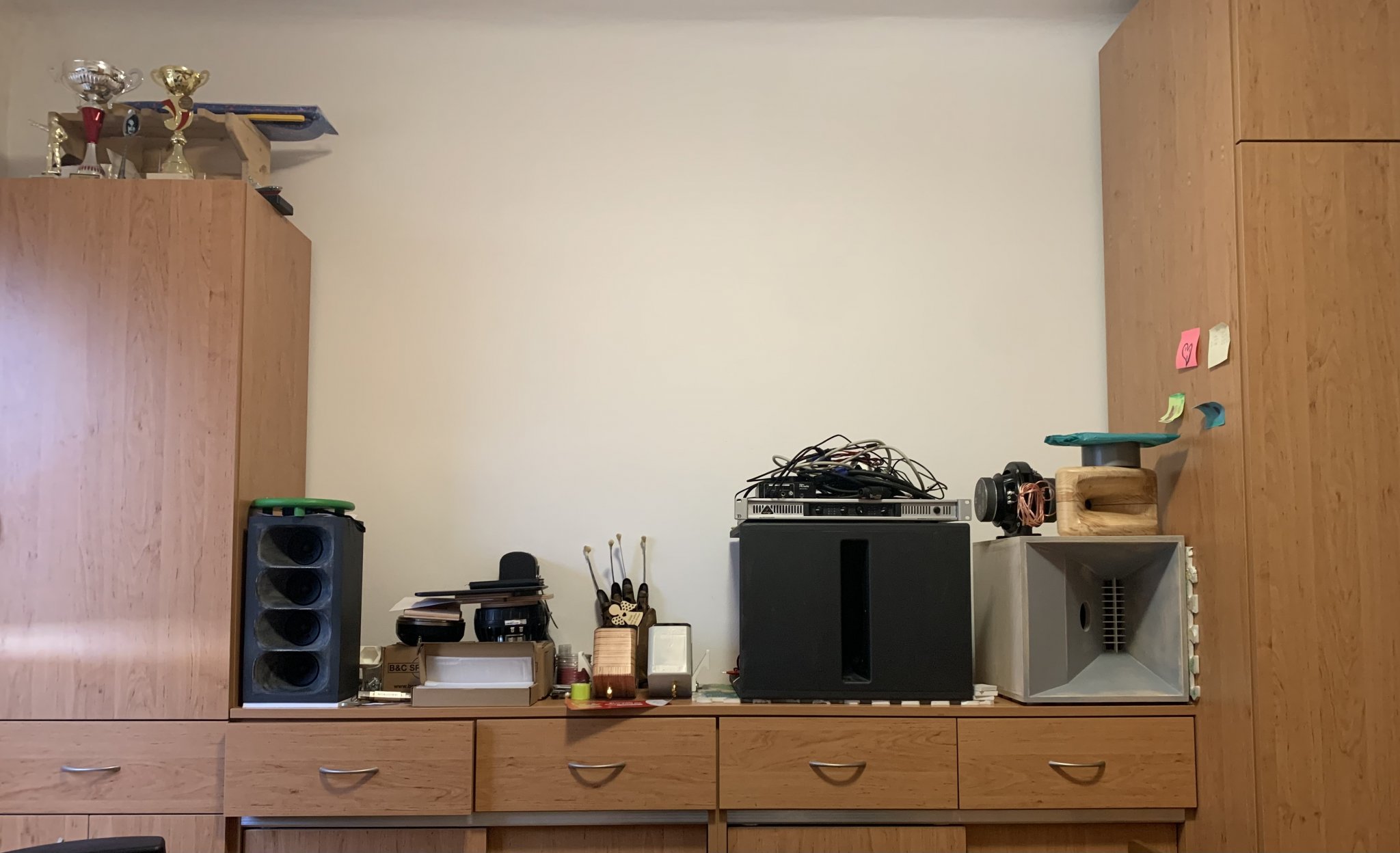

And here are my 3FE22 speakers (SSS, Hydra clone and F1 clone) I use for my experiments. https://www.diyaudio.com/community/...-full-range-driver.379277/page-3#post-6864437
Especially the SSS with a mono subwoofer is super cool, but low in SPL.

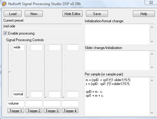

I tried a mid/side matrix in winamp and it seems to emulate very well (for free) what the DPLII's centre-width function is said to do, that is, remove a weighted portion of the centre material from the L/R and restore the same via the centre.
The result of the matrix is:
Lout = L - slider*R
Cout = (L + R) * slider
Rout = R - slider*L
When played back through 3 identical speakers, the (unwanted) portion of the opposite channel is cancelled by that from the centre to restore the original sound stage. However, the L+R portion is still physically reproduced through the centre speaker, and is expected to improve dialogue / vocal clarity etc. The extent to which all this happens can also be controlled by the user.
Code:
m = (spl0 + spl1)*(1-slider1)*0.5;
s = (spl0 - spl1 )*(1+slider1)*0.5;
spl0 = m - s;
spl1 = m + s;

I tried the dual 3FE22 "Hydra" clones and the center image on some recordings was so great, that it made me think the LCR setup might be a bit overkill in this small room. It was almost like if the speakers were off and the sound was coming from the space between them.
Two things were obviously missing - bass and volume. I definitely need to build the second "Kallax" MEH or another symmetrical pair based on the planar driver soon.
