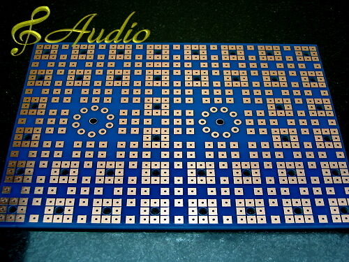

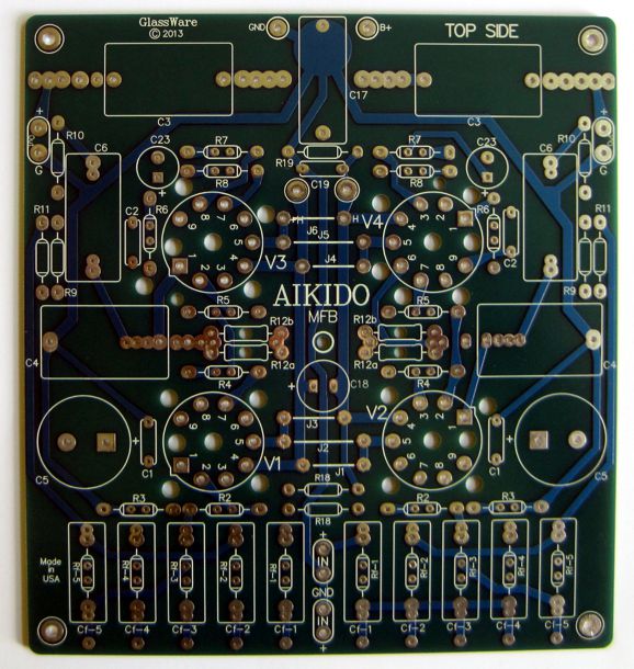

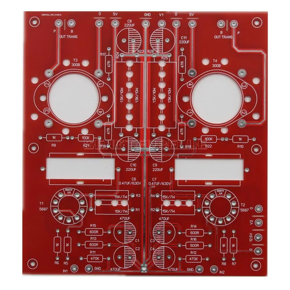

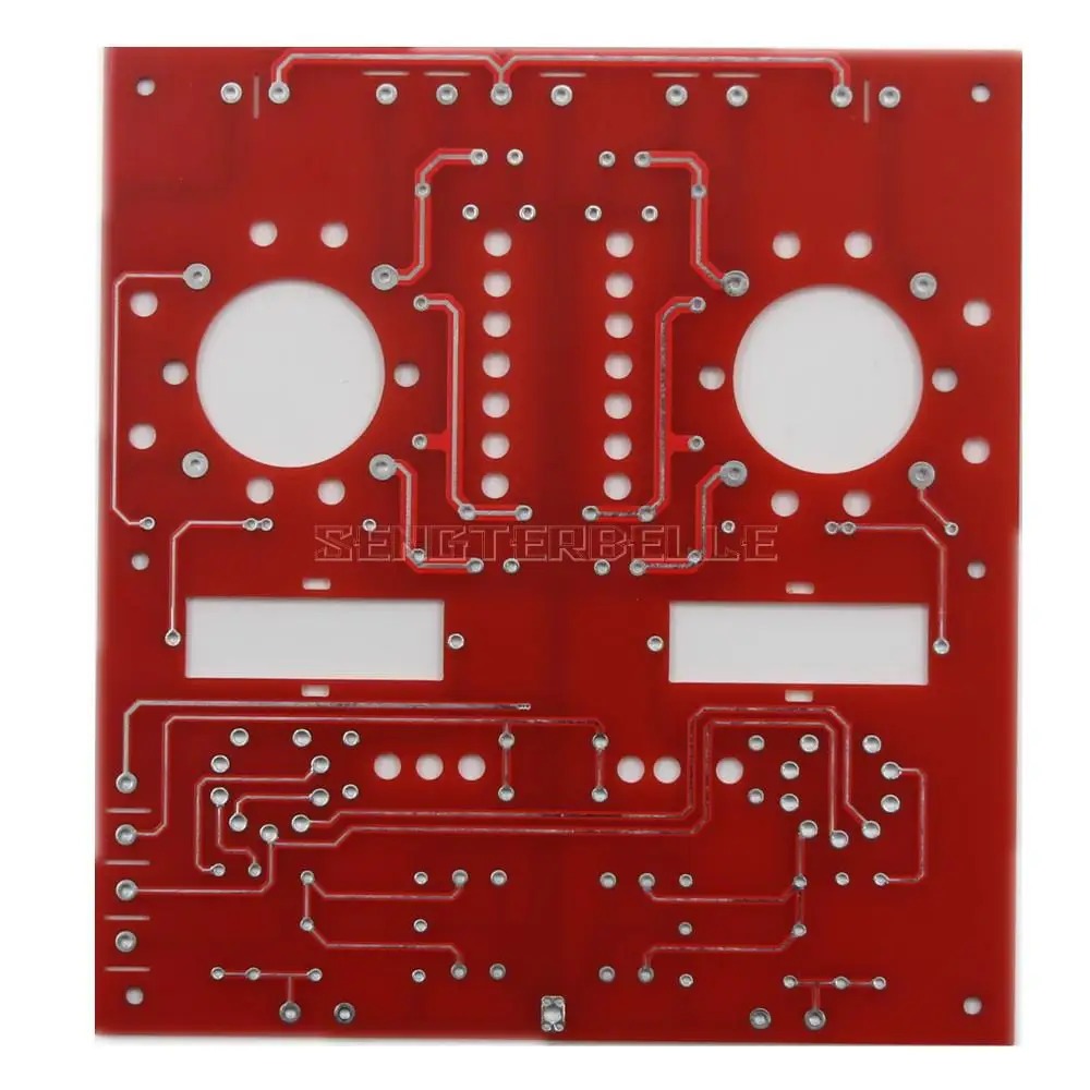

For realizing various projects like line stage, RIAA stage, active crossover networks etc.) so as evaluation I am looking for PCB's like those under
https://www.ebay.com/itm/255197072218
https://www.ebay.de/itm/202604951103
https://www.ebay.de/itm/255197072218
and
https://www.diyaudio.com/community/threads/vacuum-tube-prototyping-pcbs-of-my-own-design.387959/
but with a single large hole appropriate for tube sockets usual used for chassis mounting (for lower thermal stress on PCB).
The image of PCB from post #2 show this - unfortunately only realized for the power tube and not for the tube for small signal application
Thanks for any advice to suppliers for such prototyping evaluation boards.

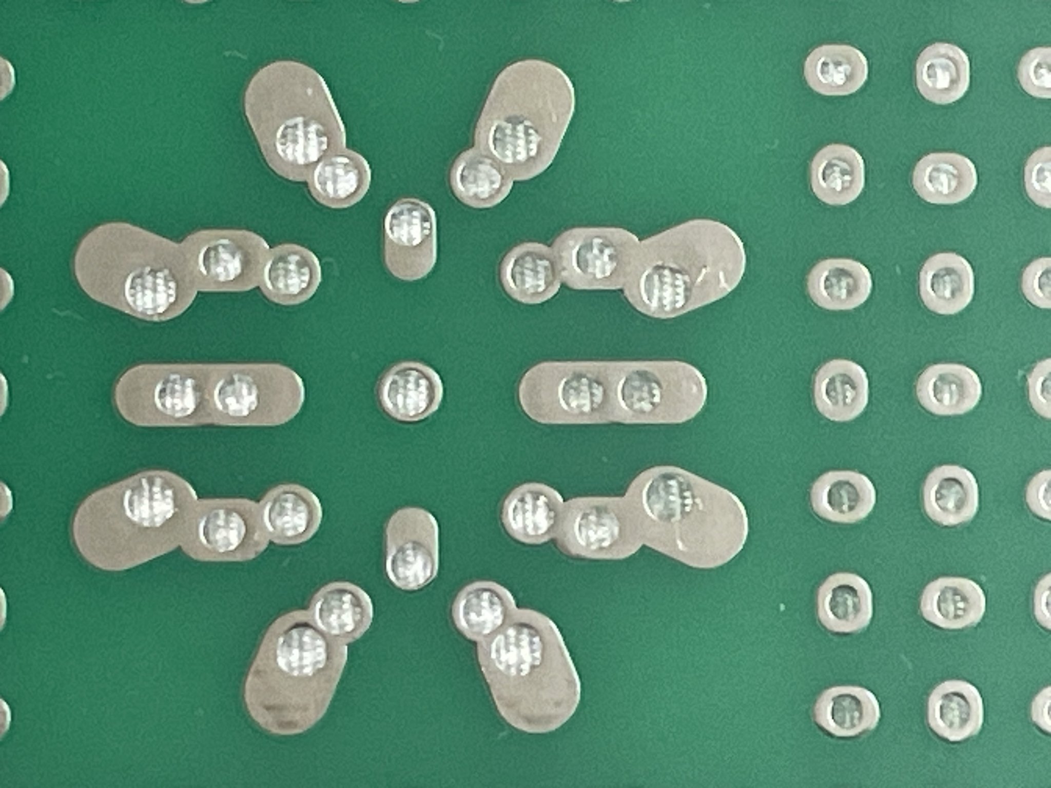

After being disappointed with turnkey solutions from eBay/Aliexpress I have designed and now use my own 250x165mm, 2.0mm thick prototyping boards, with universal pads for tube sockets, power planes on the edges of the board. I cut them into smaller pieces when necessary. Hole pitch is more convenient 5.0mm rather then 2.54mm.

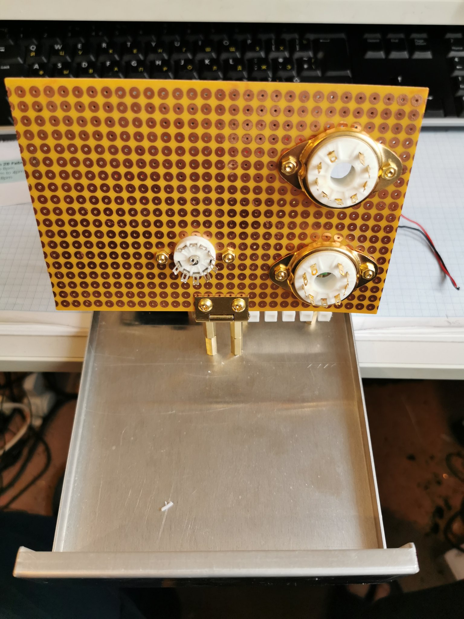

I use off-the-shelf boards with drilled holes, and just mount the sockets like I would do with a chassis.
