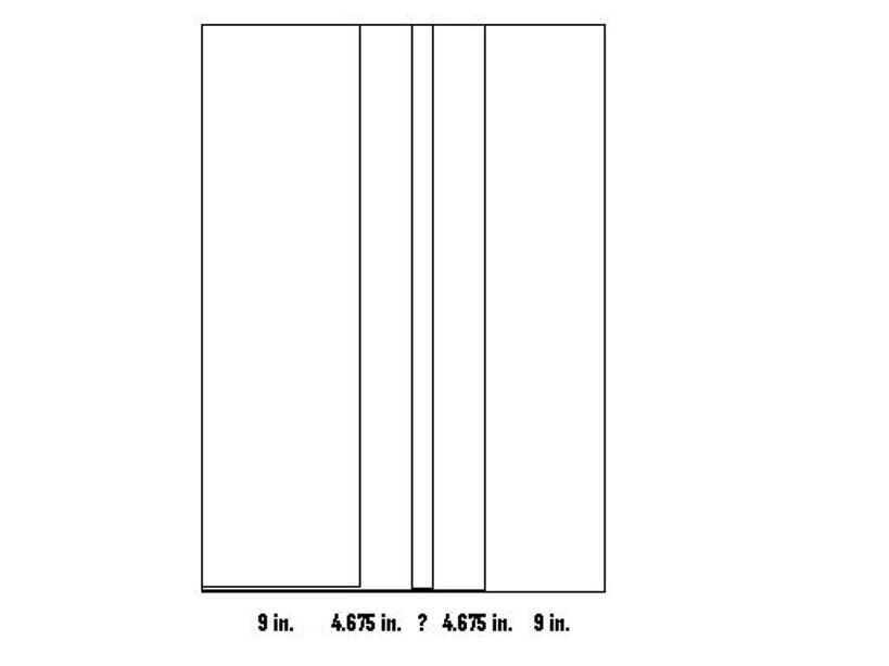

I also have some (2) of the B&G RD75s!, but one of them is non-
functional, but I do have 4 of the 48in. Carvers that all work!
I think the BGs roll of around 18K (which is probably why
you are using the leafs?). I want to try to keep it simple as
possible and I was also looking at the Marchand X-Os.
I like their line level passive units (small inductor and cap!).
Maybe we can get together when we can find the time.
Finally found another set of RD75's of which one of those is also bad.
Providing I repair the bad units, I think I can do something like the Polk
Stereo Dimension Arrays (SDA's).
Any thoughts on correct spacing between RD75's (will probably build
a narrow HF ribbon to fit between the RD75's to cover the top.
Also any thoughts on the response shaping for the crossfeed drivers?
http://www.parts-express.com/catalog/pdf/2010/198pec10.pdf
http://www.parts-express.com/pdf/264-710.pdf
The 9 in. panels are the electrostats.
Can't seem to find much info on how the Polk SDA's worked though.

I saw pics posted of ThomasW's setup. I did certainly have something in mind as
a higher freq. ribbon or leafs to cover from 5k up and most leafs are too wide
with the complete assembly.
Thought crossed my mind to roll my own, what was the spacing from the driver
centers to get the SDA effect?
I don't remember but I thought it was somewhere between 6-7 in. and that
would help me figure how wide to make my tweeters.

The Polk SDA is nothing more than the old Dyna-quad (ambient recovery) design with hot leads from the corresponding sides run to the hot in and a common wire run between the two (-) terminals. Personally I can't imagine this being of any benefit with dipoles.
I think the SDA was different than the Hafler-Dyna quad setup in that the ambient
recovery was just out of phase signal extracted by running rears from the two (+)
terminals and anything different between the two(+) was out of phase ambient info.
The SDA, If I recall, had attenuated, equalized, inverted signal crossfed to other channel.
So, it sounds like there are two distinct stereo signals crossfed and inverted. The
spacing between the normal signal of inner driver and the outer driver of a channel
set up the delay timing to produce the SDA effect?
I was thinking of some more fairly heavy damping in the BG ribbon part of the system
and leaving just the little felt pads on the electrostat panels, so the electrostat
would be more dipolar, and then become more monopolar in the highs
