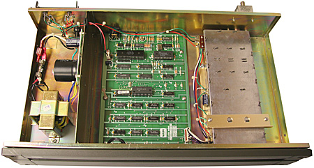

Picked up one of these cheap on eBay and ripped the guts out of it, lovely side heatsinks included INTER-M R150 PLUS POWER AMPLIFIER 2x 75W/4, 50W/8, bridge facility, rackmount, 2U
