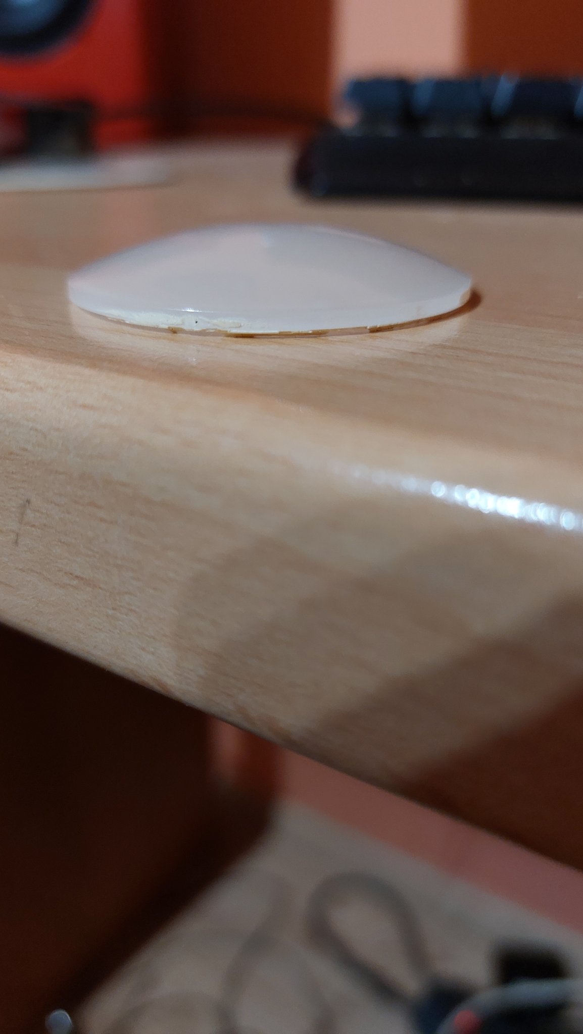

I have done some tweeters from actual silk ( bought from shop for clothes material, sewing materials, etc. ).
Tested with wood glue , actually it is flexible and sounded good.
Maybe I should have been more specific: I was referring to typical cloth soft domes. I am familiar with vaccuum-forming of the various poly- and other sheet materials.
I assume you have used some form of heating and form-pressing of the silk sheets?

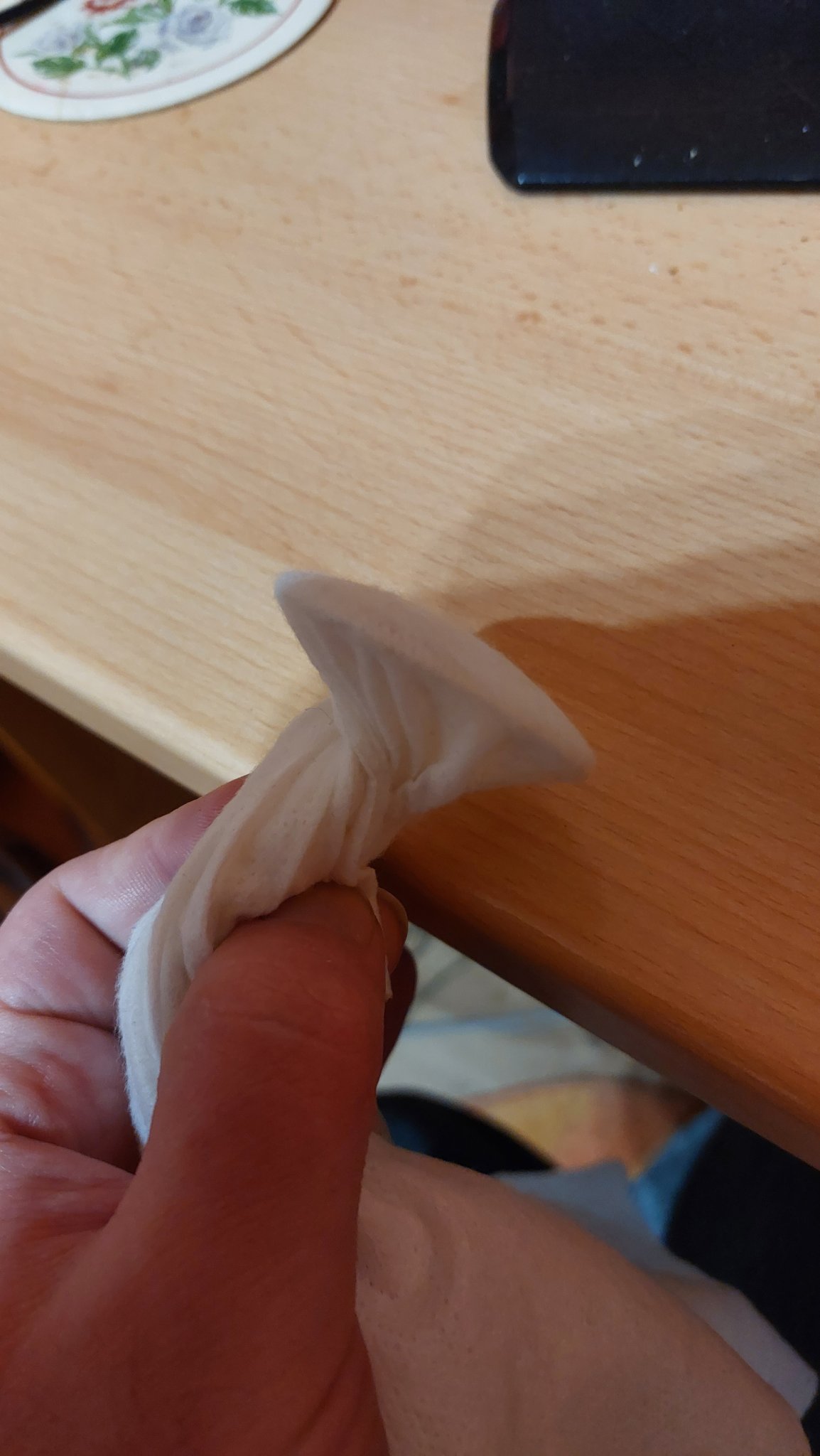

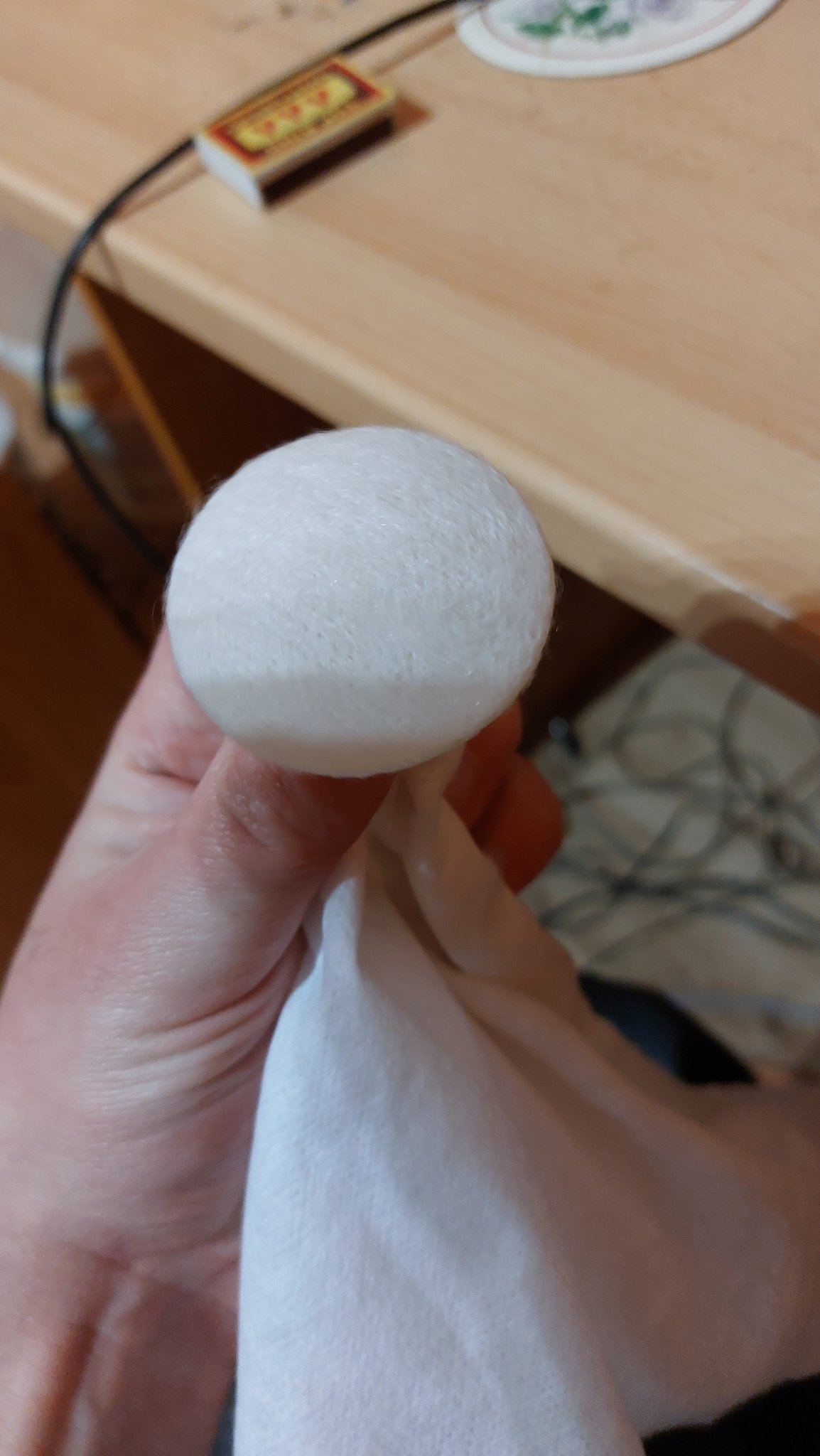

I have used some plastic dome I had laying around and made a press " form " out of cement from that plastic dome, used oil, silk with wood glue, pressed with some weight on it. Mine were 2.5 inch or so mid- high drivers
I also tried directly on the plastic with oil again, and wood glue on the silk , tighten on the back with some zip ties, worked just fine.

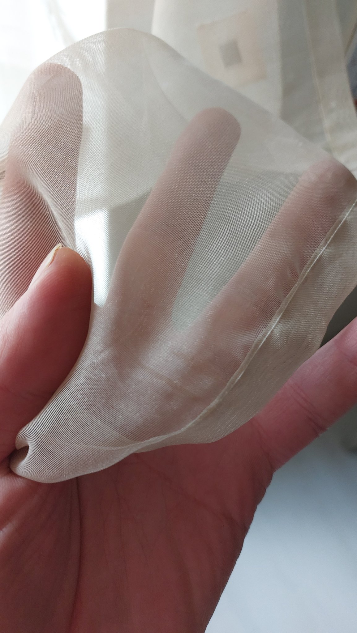

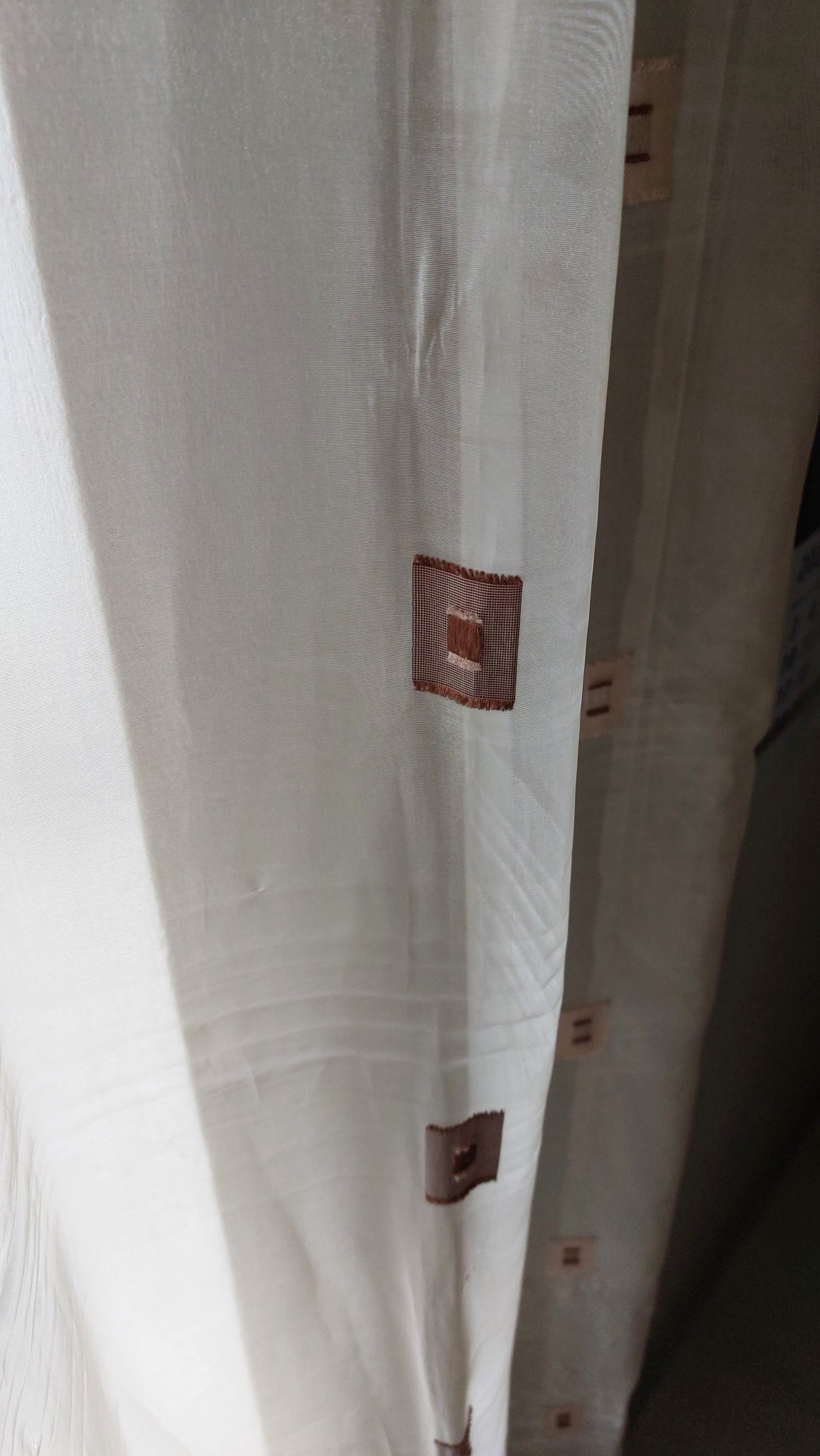

You can find fine silk for window curtains . Thats what I used.

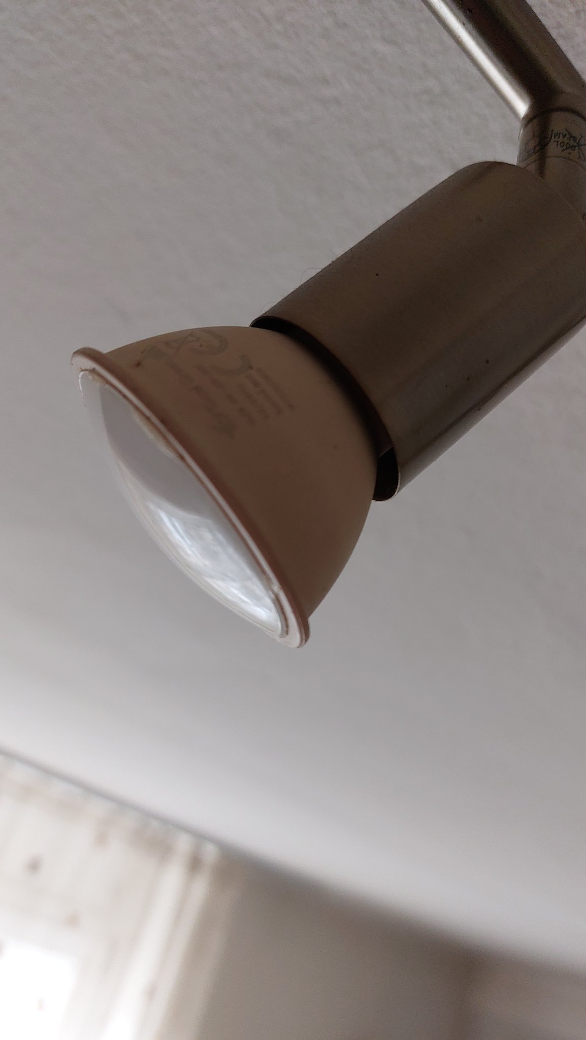

Some light bulbs have " usable " domes made of plastic , to be used as a matrix.

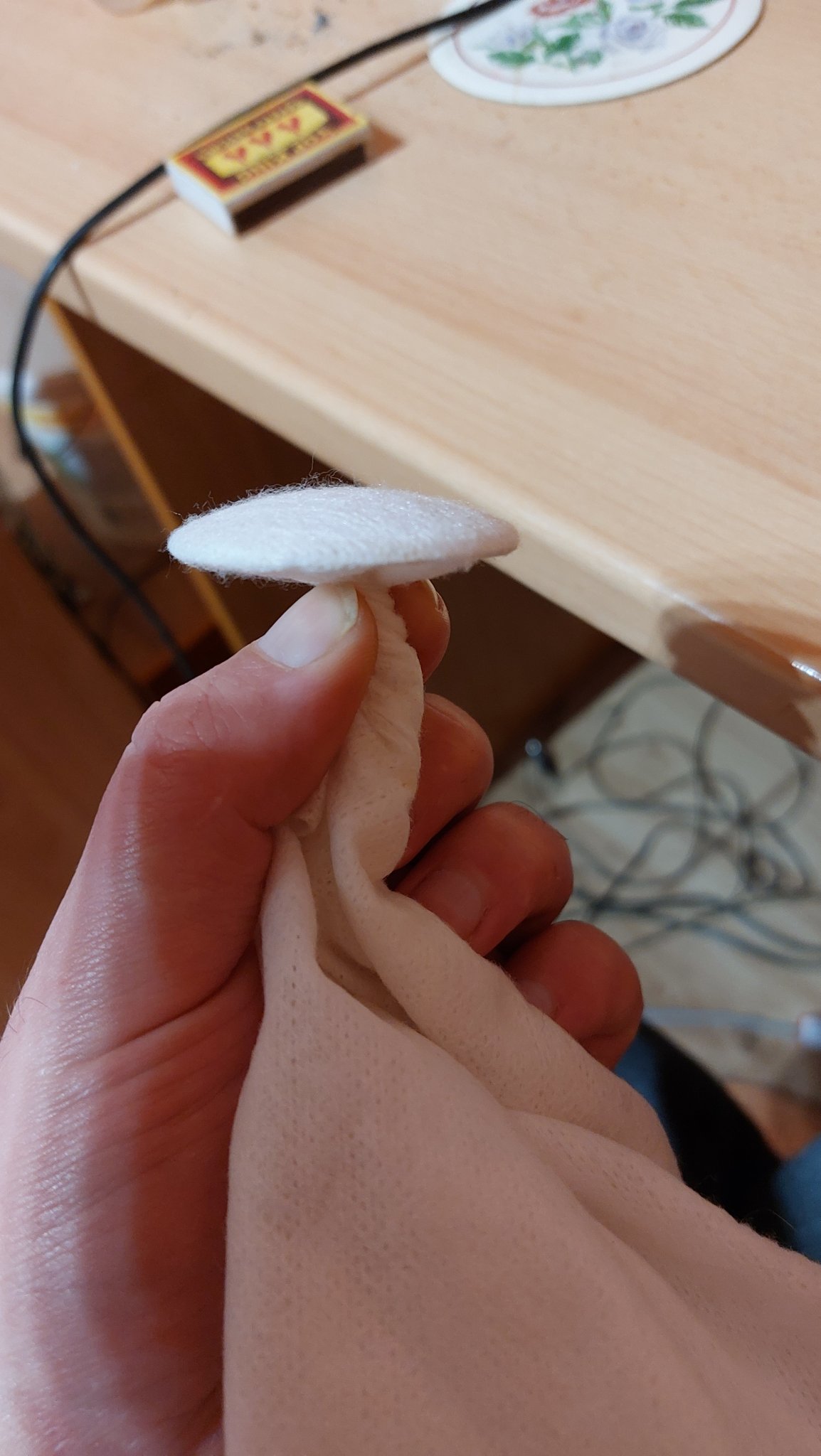

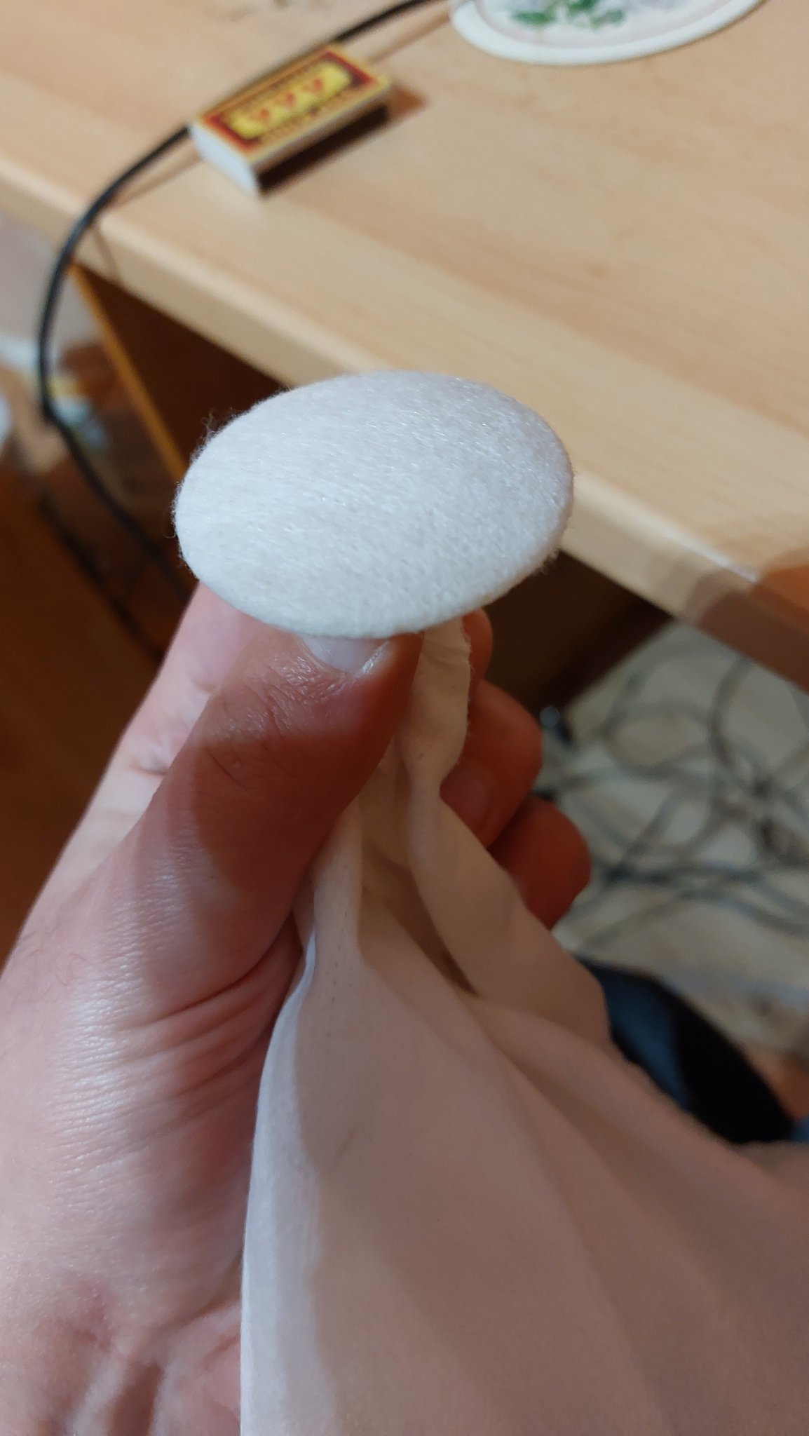

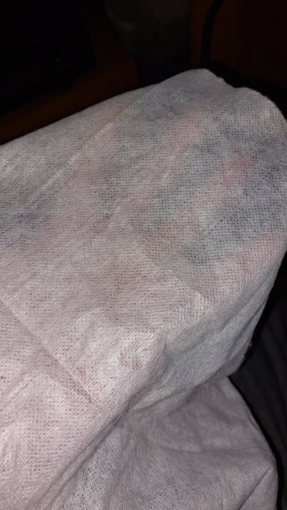

Thanx for the pictures and the answers. Are you sure the material in picture 2 is silk, not nylon?
The one in the picture I'm not sure 100% , might be silk with something else, or just silk. ( doesn't feel like nylon , but hey I might be wrong. )
I have used silk 100% and also the material from that picture. ( it sounded good as it's thin, not so dense, with wood glue it looked / ended up very similar to what silk dome tweeters feel like on touch, flexibility. For me the surround was harder to make, I tried some EVA Foam ( youtube with great results even for woofers ) but porbably not the right composition, concetration. Used surround from other speakers, 2.5", you can get them new anyway .
I have changed the cone on some regular 3inch speakers with ones I made from this material, and there was improvement in the clarity, voice/ highs, but I don;t have the necessary tools, equipement to test , fully make great diy speakers, I mostly did it for fun, I don't know what you try to achive.

Silk alone will not keep its dome shape, all textiles need impregnation in some kind of resin which is later cured under heat and pressure in a set of male-female dies.
A lot of Phenolic resin and cotton fiber thick-ish cloth will give you old style brown hard domes, still much used in cheap horn drivers, not sure anybody still makes tweeters out of it; silk is about same but uses very thin cloth and as little resin as possible, it is still flexible.

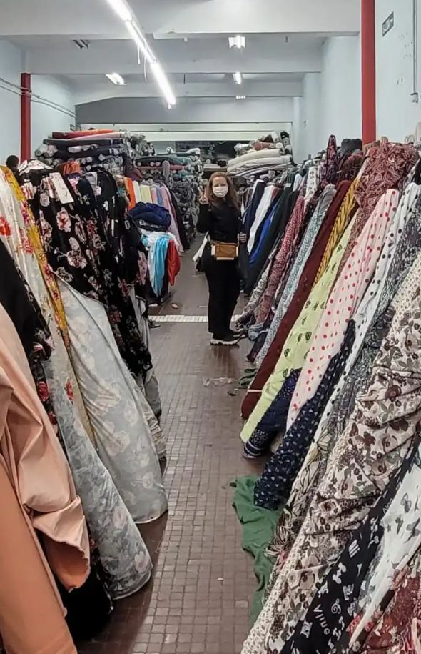

Textile Industry is incredibly advanced and offers a huge range of products.
Not sure where you live but here in Buenos Aires and certainly in any large City worldwide there is a "textile/cloth" area where you have all kinds of it.
Just walk around, look at and touch everything 😄
You will be surprised at the huge selection and you will certainly find some dome suitable type.
Cloth is cheap so you can get many samples to test.
