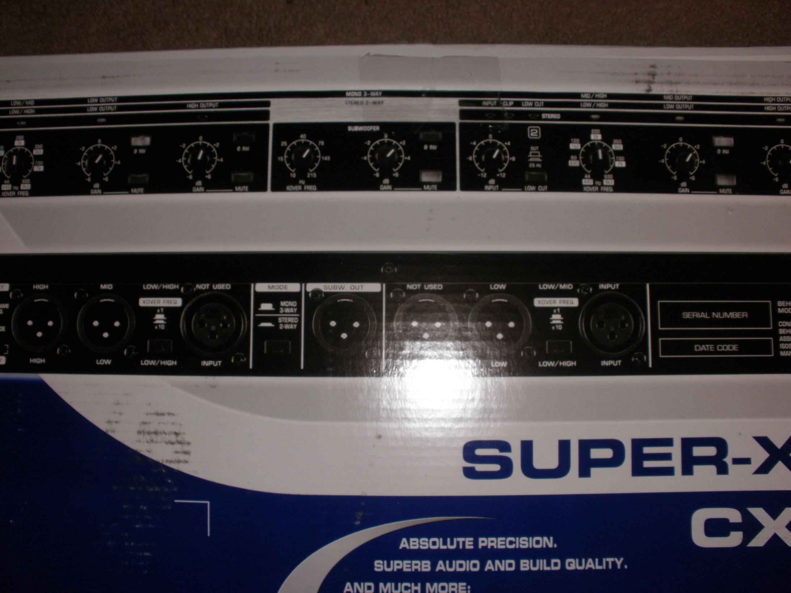

problem
here is the problem, iwish parts express would have told me that this does not have rca out. any suggestions before i send it back? i would imagine they make a plug for rca connection, but i think i would be better off with another cross over. but still open for suggestions, i do not want to modify the unit in any as it will void warranty. thank ya.

Ger, John,
Ger, parts express sent me the adapters today, un bias rca to that plug, j plug n plug, either way, problem solved. and why didnt you guve me a heads up that was for DJ equipment????It will work, thanks, many of them.

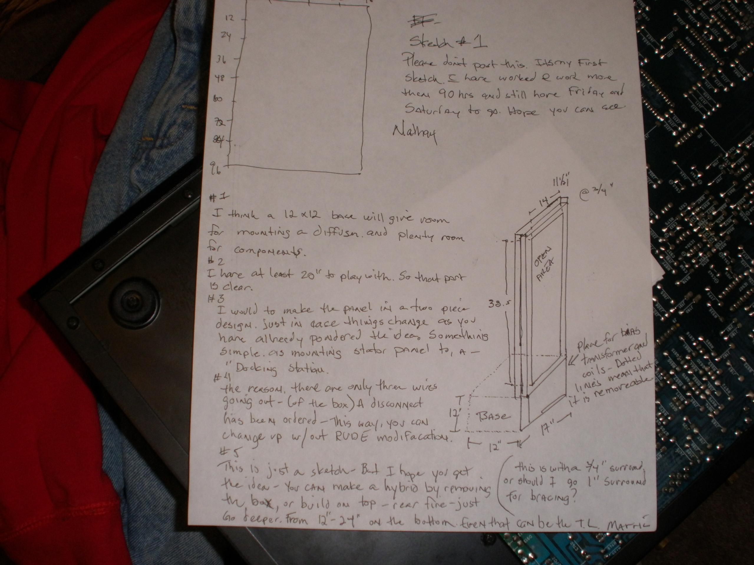

Here is avery rough idea i have, the idea is there, just not measurements. hope it makes sence. A hybrid is the back burner as i want a removable stat panel, the bottom is just to raise it off the the floor, provide good support, and for safety reasons, i have a dog, the last thing i need is him to hike his leg on this while it is on. so check it out and please dont garnish me too hard. disregaurd the second pic, wrong # on my end. just the sketch.

Your sketch looks a lot like Sheldon Stokes' 2-piece hybrid ESL. Have a look at Sheldon's website: DIY ESL's Verison 1.0
You could use your 8" woofers in a separate box under the stats like Sheldon did. In any case, you shouldn't run your panels full range because the tandem toroids that you and I using aren't really good for that... you need some woofers or your bass will be poor.
Go here for some excellent information before starting to build you ESL

I see you have a link to Sanders' Sound. I just drew up a speaker very much like Sanders' design-- have a DeltaCad drawing of it in fact, if you ever want an ESL like his.

i have my cross over, i will bring it with me tomorrow, cut off at 500hz 24db slope, and let my powered subs handle the low end. space is not a problem, I have not of heard of Sheldon's, but if it works, it was just a thought, just a way to upgrade later if i wish to. Now you are going to have me read another book, this is going to be interesting.
yes, aka sds lab, this is the design i was trying to describe to you notice the dots they are support spacers to protecet against instability and high exerusions due to the large digphram width and length .this technieque was also used in the " high effiency electrostatic loudspeaker"article in the audio amatur magizine which used 6" wide panels and .032" or .040" spacers, i"ll have to find my copies to verify this.this design appeals to me and i will probaly implement it my next panles of 1' x4'.john thanks for the url i was not aware that roger wad posted the ampilfiers articles.those are the basis for the desgin i have been working on for the last few years, i have been protecting and savoring my twenty year old photo copies i have and always have a hard time trying to find them,thanks.
