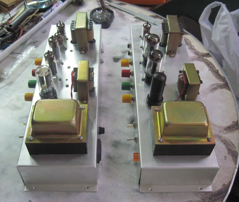

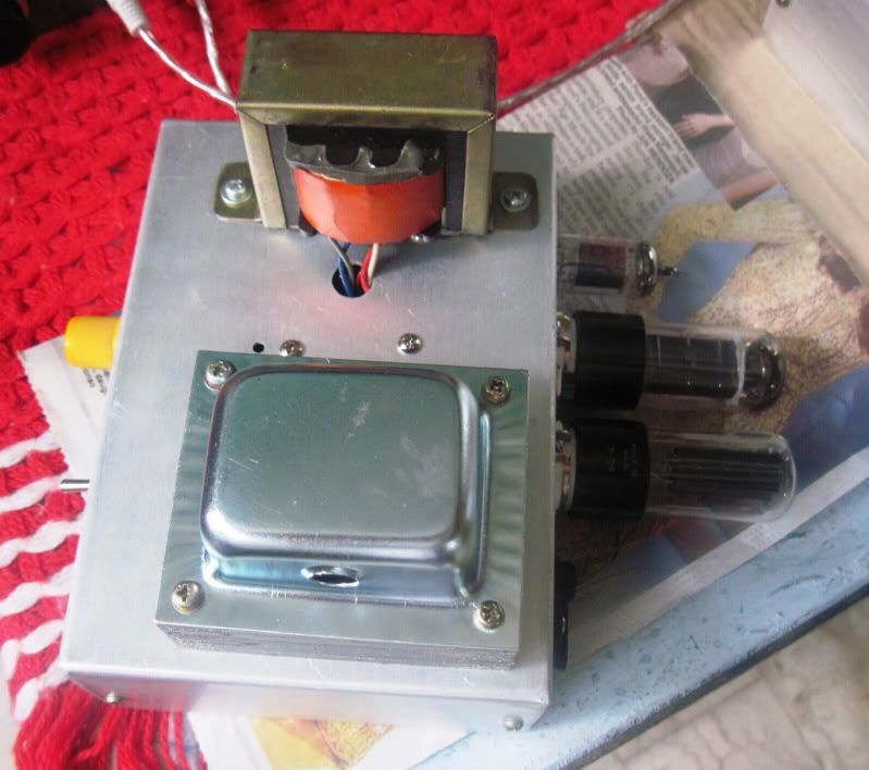

this is a single ended 5F1 clone is finished just the other day...
there are spitfire clones,
one using 12W6 finals and the other EL84's
Hey-hey Tony, which one do you prefer?
not me, but the guitarist who commissioned me to make the amps chose the 12W6 over the EL84's......to my surprise....😀
even my son liked the 12W6 over the EL84.....
the 12W6 is just like the 6V6, though with lower plate voltage and lower still screen grid ratings....
