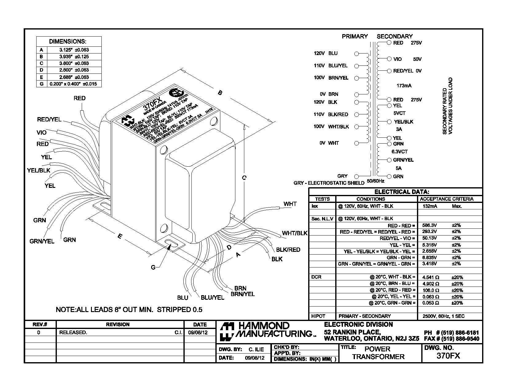

@boobtube: the voltage at the wall is 230, I think the transformer is expecting 240. If I wire to the 110 taps instead of the 120 I'd say Red would jump about 612 volts. Is this too high? Which is easier to deal with 560 or 612?
Is there any chance I could leave the brown & black taps connected (as it is currently) and simply move from the blue to the blue/yellow? Might this be a valid 230v configuration?

I've just read 2 threads that suggest 230v wiring is possible. One thread on AX84 says they got this from Hammond:
"The primaries 110V and the 120V can be series connected to get 230V. It
is only parallel connections were the voltages must be the same to be
connected."
Is that the same as what I'm talking about?

Hmm even easier for me at this stage would be to connect brown to black/red.
So that would be:
- Live to 120V Blue
- 0V Brown connected to 110V Black/Red
- Neutral to 0V White
Or would my first suggestion be better:
- Live to 110V Blue/Yellow
- 0V Brown connected to 120V Black
- Neutral to 0v White

Yes, if you series connect a 120v and a 110v winding, this will match if you have 230v wall power. But you cannot parallel connect a 120v winding and a 110v winding. But you won't be paralleling them anyway because if you paralleled the 120v windings, this would match 120v wall power. Paralleled connections do not add voltagewise. The current(amperage) will double. Series connected windings will be additive voltagewise. If you series connect both 110v windings and put 230v on that then your secondary voltage will be higher according to the change in ratio. You are putting 230v on a 220v connected winding.

As long as you connect together in series as the diagram from Hammond indicates ("top" to "bottom"), I don't think it makes much difference which of your choices above is used.
Either your 230v supply connected across 110+120 or 120+110,
OR to get higher voltages on all the secondaries:
Your 230v supply connected across 110+110 windings, OR
To get even higher voltages on the secondaries, connect your 230 v across combinations involving the 100 volt primary windings.

I rewired it for 230 by connecting brown to black/red anyhow 🙂
Seems to be working fine. No load voltages are much healthier now:
Red = 595
Green = 6.6
Yellow = 5.1
If - when there's load - they drop significantly, I can always wire it for 220.

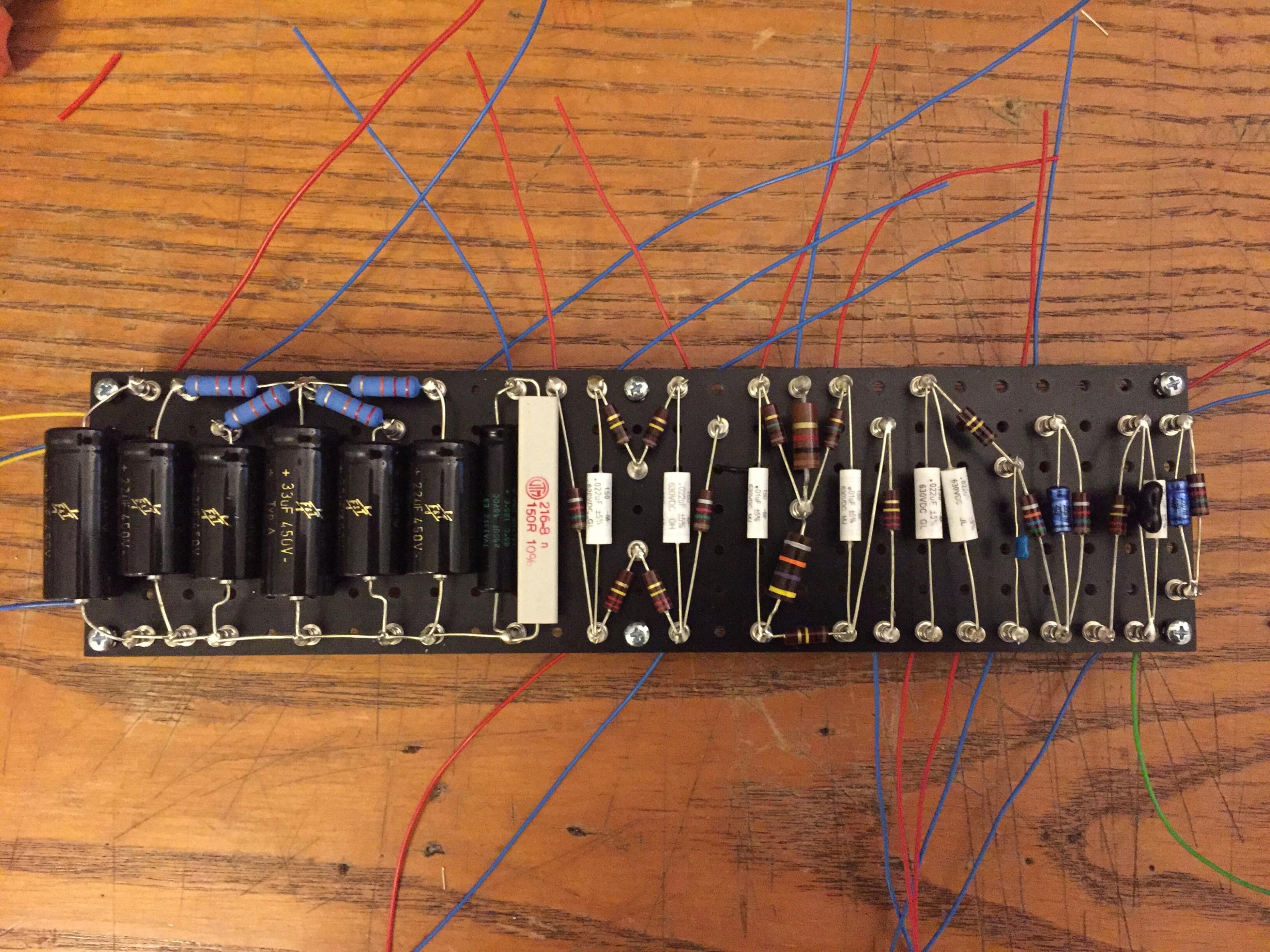

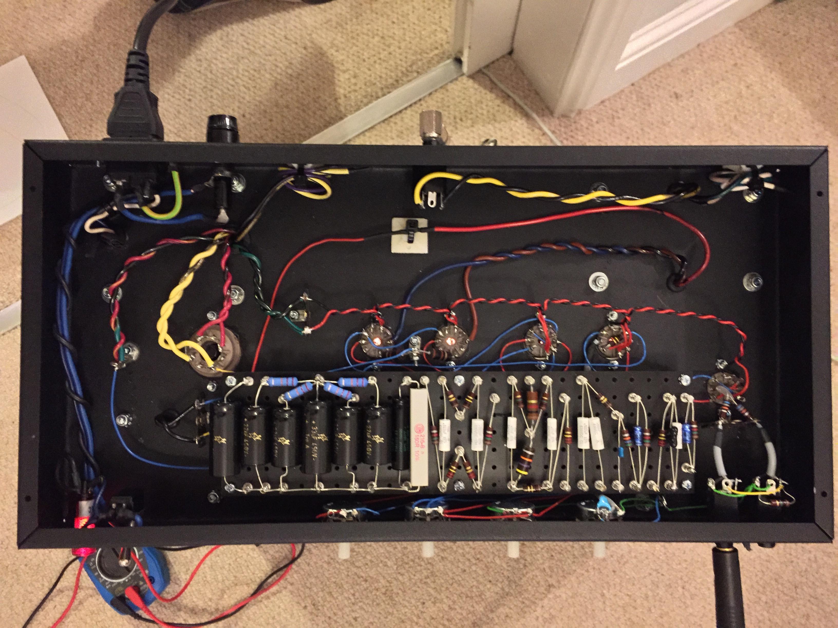

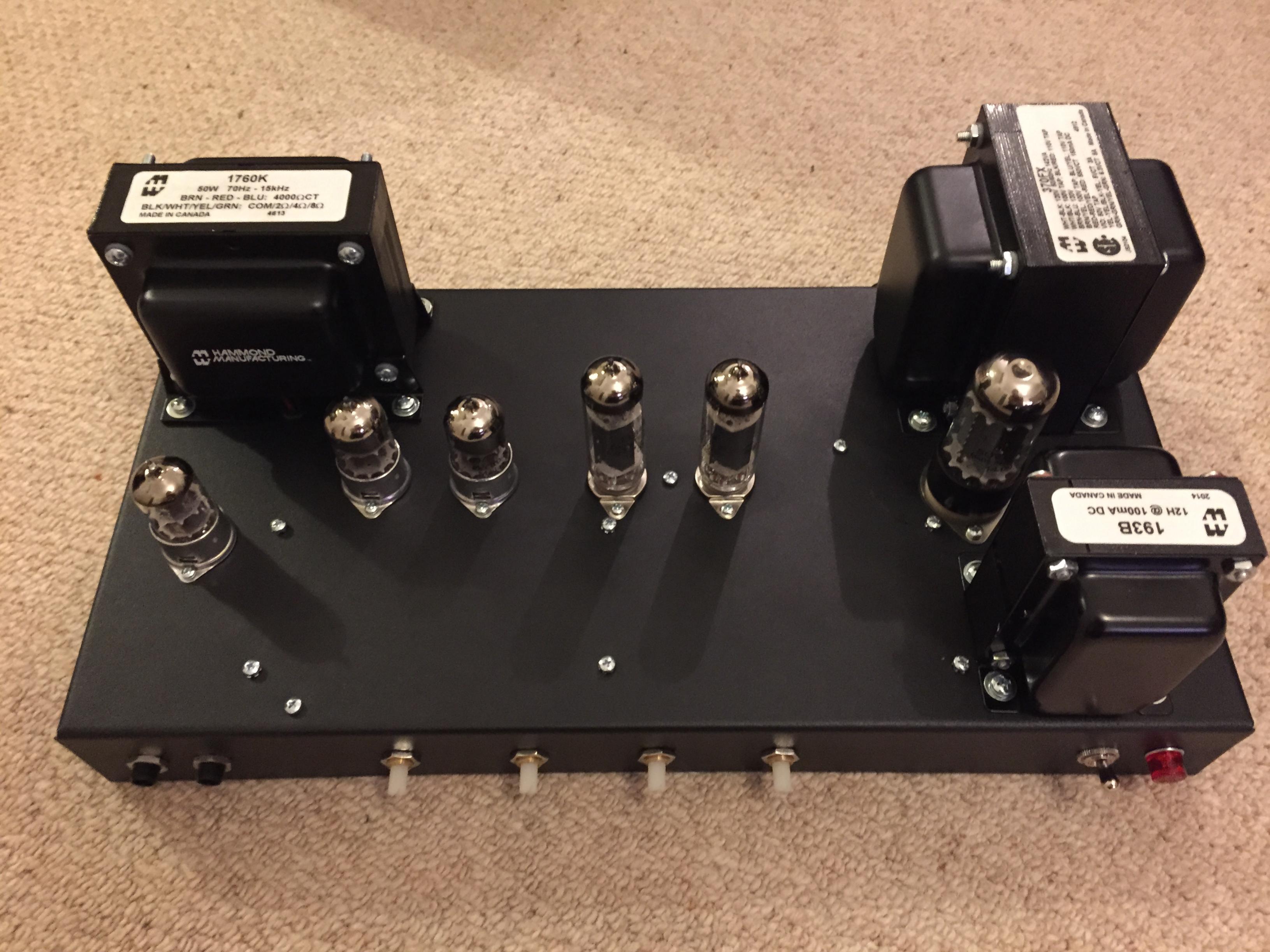

It lives!
I put in some epic soldering effort today to get it running. I'd miswired one of the rectifier heater wires (thankfully on an unused pin). But it was tracked down quickly, and once sorted it started amplifying. As far as I can tell it was my only mistake 🙂
It sounds fantastic. Chords are really solid and strong. It's very clean, maybe too clean: it only breaks up running flat out. Tone controls are excellent, bass and treble are super smooth and there's a wide sweet "area". It's not at all harsh or flabby. It is flipping loud!
There a tiny amount of hiss and hum: far less than my Fender Blues Junior, even at 3 times the volume - but perhaps more than I was expecting. I have some suspicions as to the sources.
I'm just running it through the blues junior standard speaker at the moment. But I'll get some samples tomorrow evening. I suspect it will sound even better with a greenback (that's the next job on the list!)
Thanks for everyone's help. I'm sure I'll have a million more questions once I start tinkering with it.
Some pictures attached.

Just to be sure, you did do the initial voltage check? Sometimes higher plate voltage will give more headroom and cleaner signal. Remember about the possible voltage discrepancy from the off load voltages? They did go higher after the re-wire. Don't forget about the 6.3 and 5 volt readings as well and EL84 plate, screen and bias, preamp plate and bias.I think the lightning is supposed to break up sooner. Someone who knows for sure please correct me if I'm wrong. It should sound better through the Greenback and if it is new, even better after break-in. Super progress for your first build and it looks great, too!
Good work - and thanks for the pix. It's helpful to see a working low-noise layout. Look forward to hearing some clips.
