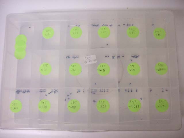

I have not seen on this forum anyone using this part, so I'm kinda out on a limb here. Regardless of the tiny operating current, I like it and haven't found any real drawbacks in performance or sound. In fact the sound is excellent if used properly. The drawback is in the fact that there is a wide % variance in Vgs on these, at least much more than the j201's I measured. Went through 100 or so in the first measurement run. Measured typical Vgs@100uA of around -0.160V to -0.300V for the KSK595.
First I measure each device and sort them as similar groups of 10-20% or so. When I need a MP, I re-measure from a group to chose the closest two. Once you have them sorted into groups, it isn't so hard to find many matched pairs. In this circuit, there is about 5V Vds on each input transistor and on each cascoding pair. 5 pairs total...one could grow old looking through a pile of 100 jfets just to find matches.:xeye: The input diff looks like a ladder:smash: ...one of my so called 'experiments' ...that actually seems to work.:D
I use these cheap storage boxes to keep them sorted. When I need more MP's, I now have a narrower margin to look through.
(The top row is some 5087 BJT's sorted by Hfe)
