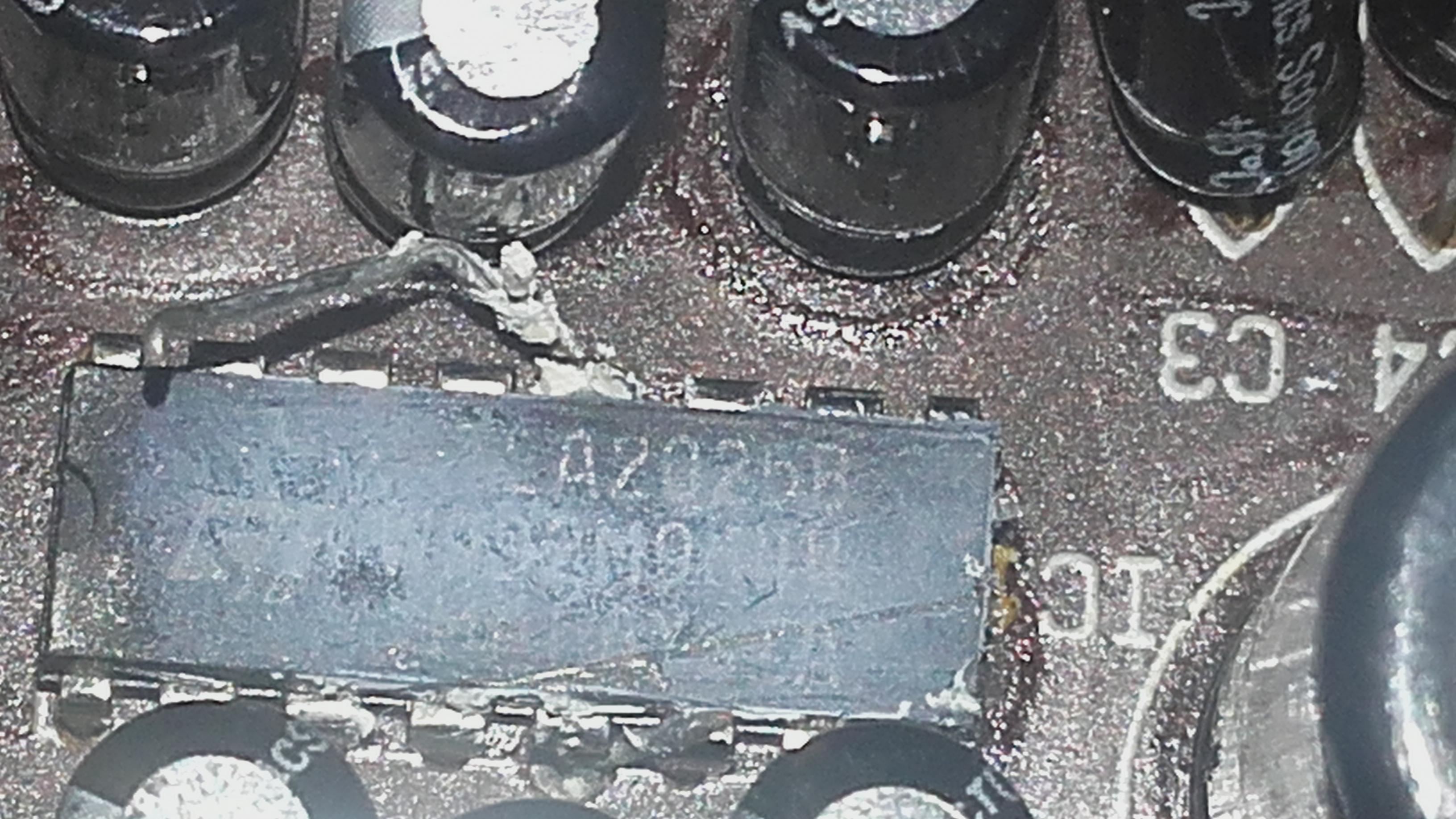

How can everyone be so sure its a TEA 2025? The heat sink is coming loose and I am to verify that soon.
Something like this?
Yes, that's the enclosure that's about to be changed to something like a proper amp. But can you tell an amp by its cover?

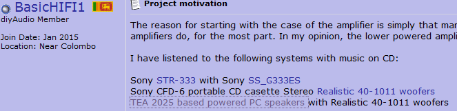

I wasn't trying to guess, just found out the context of your "low voltage" situation from reading your other thread.
Sure. But is it really possible to zero in on a amp chip based on the circuit?
You showed a PCB with a known size of chip under small heatsink, from a typical PC speaker...
I have opened more than a hundred of PC speakers, so I have Statistics here...
Of that 14-pin (or 16-pin) in less than 2W category I have only seen 2 types. Of course, 2025 (from various manufacturers) is the most popular because it is IMO the best sounding. Others use a 8-pin IC (like opamp), the also popular LM386, which sound is worse but the current requirement is low so can use the USB port for power supply...
