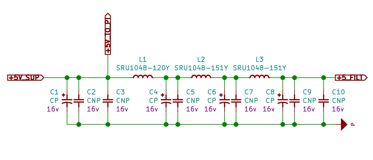

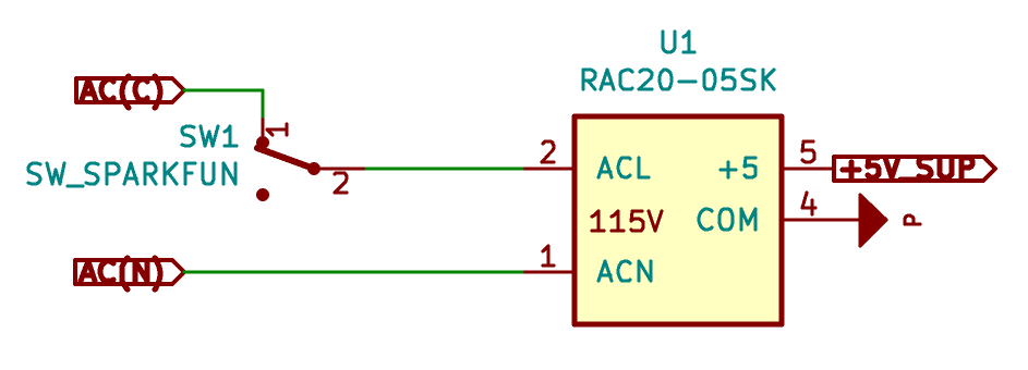

SMPS offer some advantages over traditional transformer based solutions in size and simplicity. One of the fears in SMPS is EMF and noise in the output, but you can go a great distance in this by simple filtering. Using an EMF meter, I have to put the meter nearly onto the SMPS to get it to pick it up, whereas it will pick up my phone EMF from across the room. In my project, since I use the Raspberry Pi, the Pi has it's own issues with making noise that for the most part, a linear supply wouldn't offer any advantages in the first place. Nearly any computer is going to make some EMF and noise on it's own. I have zero issues with my system even having the SMPS within 2.5" of the DAC. The Raspberry Pi is actually shielded on the back of a PCB in relation to the audio side of things.. So use your engineering skills to place components appropriately and I can say that you should have great results. In the attachments, one is just the simple AC connection, and the next shows how I filter slightly with a few capacitors for the Pi, and then chokes for the output before the audio circuits. Some parts are not labeled because I plan to use a variety of values. It's not necessary to go the the depth of filtering, but it's only a few dollars for me and the board space would be wasted anyway. Rod Elliot has a great page on grounding that you should take a look at..
