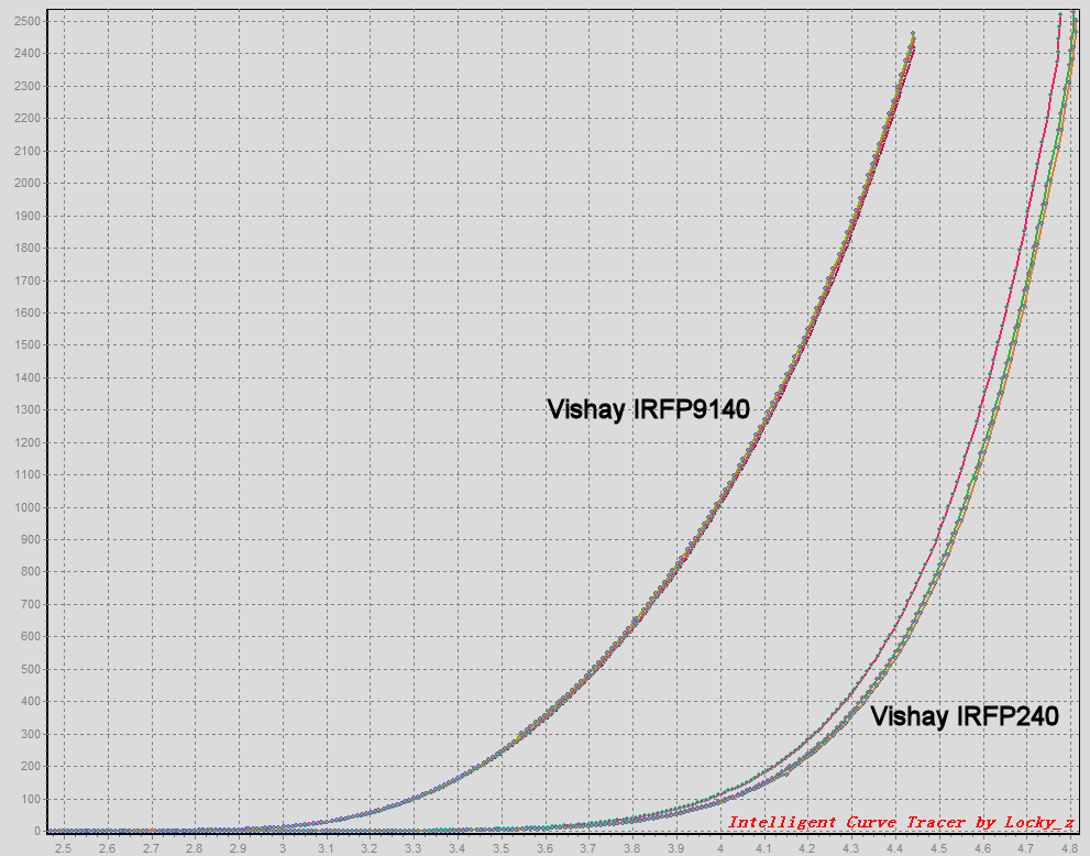

Hi Andrew, I've always hear that 9140/240 pair is better matched than 9240/240, even the spec sheet enforce the idea. However, BenY's measurement doesn't seem to say so.
However, current sharing between 9140/240 seems to be better match.
Do you think it's still better to use 9140 with the 240?
Ref. to thread of Beny's measurement: http://www.diyaudio.com/forums/solid-state/237219-fet-hex-explendit-amplifier-56.html
The top graph shows very different curves for the 9140 and 240
But what are the axes?
The different slope may be showing a gm difference
I don't know what the lower two graphs are comparing, is the last labeled correctly?

The vertical axis is the ID current and the Horizontal is for VGS..
Sorry for not pointing it out.
Back to the plots of real devices.
The middle plot shows irfp240 and irfp9240.
Both scales are linear.
Looking the Id range around 2A, we can see that the transconductance (slope) is higher for the irfp240. This is what the datasheet would state.
The top plot comparing irfp9140 to irfp240.
Looking again at Id of 2A
This time the transconductance of the irfp9140 is less than the irfp240.
This is different from the datasheet.
Any ideas why?

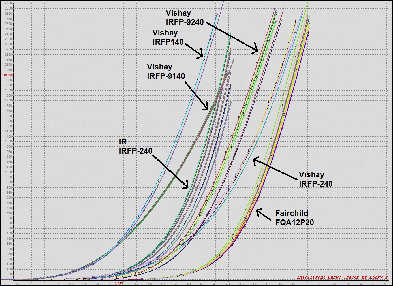

I bought these devices from mouser not too long ago,These are Vishay devices. Beyond that i have no control on the lables. But i mesured and marked them correctly.
Not the device marking..............I bought these devices from mouser not too long ago,These are Vishay devices. Beyond that i have no control on the lables. But i mesured and marked them correctly.
The labels on the plot seem wrong to me, i.e. I can't explain what I see.
The labels on the last plot are correct.
But, I would like to bring in new information i gathered.
First, The IRFP-240 devices i was measuring were an old "International Rectifier" devices,Purchased from Digikey around 15 years ago.
Lately i acquired new samples of Vishay IRFP-240 from Mouser, and they are somewhat different devices..
So i present all the plots on one window,including the manufacturer name and part number, to make it much clearer this time around.
You can clearly see that device parameters can change form one manufacturer to another.
Sorry if this led to some confusion..
