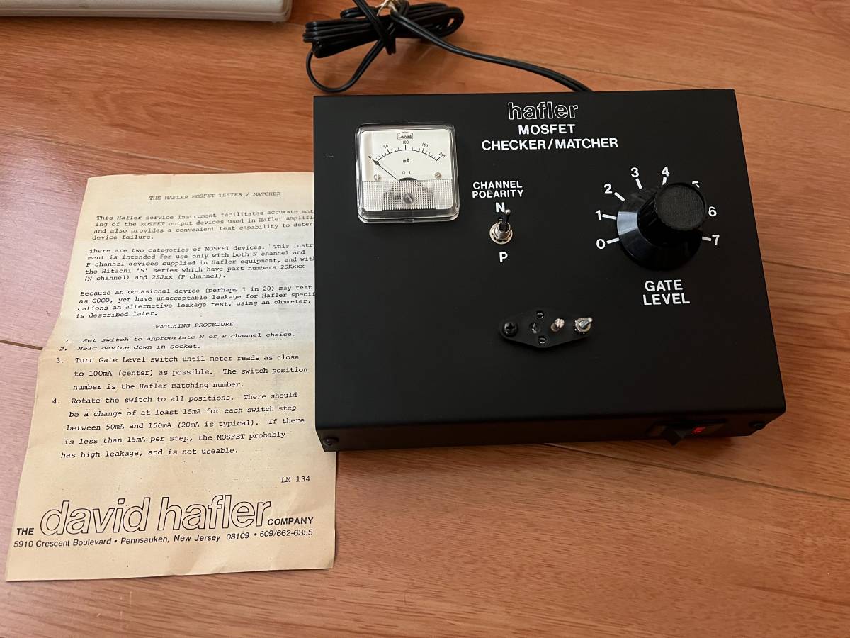

Not only do I want to match MOSFETs, I want to make a MOSFET checker/matcher rig. I would use it to test and match mostly older Hitachi MOSFETs, Eg 2SK134 and 2SJ49. Dick West used to be able to match and check them for me. He has sadly passed away last month at 82 years old.
http://www.diyaudio.com/forums/solid-state/31131-hafler-dh-200-220-mods-111.html#post3415258
He had a Hafler MOSFET Checker/Matcher device.
Anyways, I would build a Nelson Pass jig. I assume in that Hafler box there was a built in multimeter and thats what the needle meter is for. The MOSFET's Gate-Source Voltage is +/- 14V, so I gather that my power supply cannot be higher that + or -40V. And I can't draw more than 7A, or I will destroy the MOSFETs.

I assume the little rotary selector (Gate Level) 0-7 is just connected to a bunch of resistors (R in the schematic above) to allow different amounts of current to flow though.
Is this right?

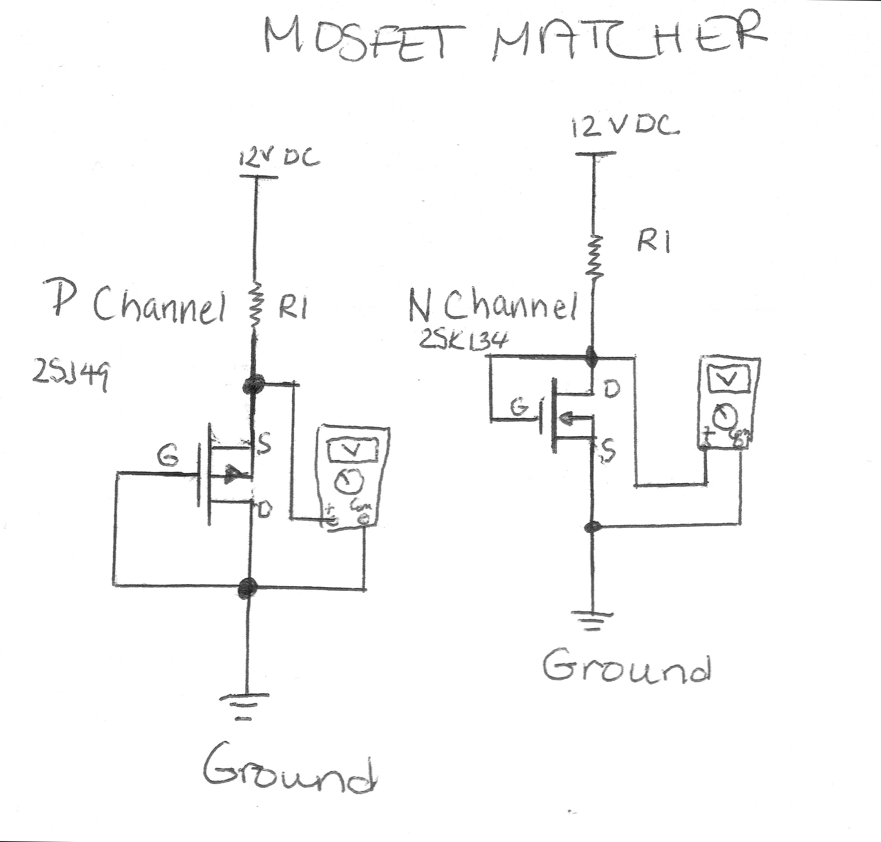

Okay. I drew a schematic to the best of my ability. I attached it. The max gate source voltage is ±14V so a 12V power supply will do. Hafler matched each MOSFET at 100mA, what value resistor is needed for R1? From what I concluded I need 120Ω resistor as R1 to allow 100mA of current to flow through the MOSFET?...
Provided my circuit is correct I would do just that, and note down the voltage reading and get others with the same (or very close) voltage reading. THat brings me to the next question. What does the knob GATE LEVEL do? Does that change the value of R1? I wonder what the meter on the Hafler checker even says.

Matching with Vdg set to zero volts does not replicate amplifier operational conditions.
But this 0Vdg matching is far better than random.
Vgs of a Lateral is quite low. Look at the datasheets for good guidance on what to expect.
If you want 100mA of Id and Vgs is ~600mV then a resistor of 10r in the drain feed will drop 1V and Vsupply should be set to about 1.6V, not 12V.
This very low supply voltage results from setting Vdg to zero volts.
R1 could be switchable to suit different Id.
Maybe 1r, 2r, 5r, 10r, 20r would suit your range of Id.

This entire thing seems to be so complicated. Different answers from different people. (also asked on AudioKarma) Can someone just draw the correct schematic with the correct values so I can test these MOSFETs? They are checked with 100mA of current through them. Is a heatsink needed in this case?
Also what do you folks thing the GATE LEVEL control on the Hafler MOSFET checker does? adjust the value of what we think is R1? Also what is the needle display for? My guess is that it is a DC voltmeter inside too.

For 12 VDC.
R1 = 100 Ohm
would be a good value. Gives like 80 mA.
R1, 100 Ohm, would be a power resistor at least 2 Watt value.

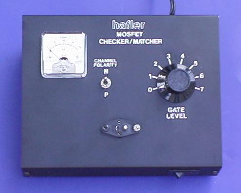

But does anyone know or can guess what the needle and the GATE LEVEL control do? I'm guessing the needle is just the DC voltmeter, and the GATE LEVEL is a pot or a switch to select different resistors...😕

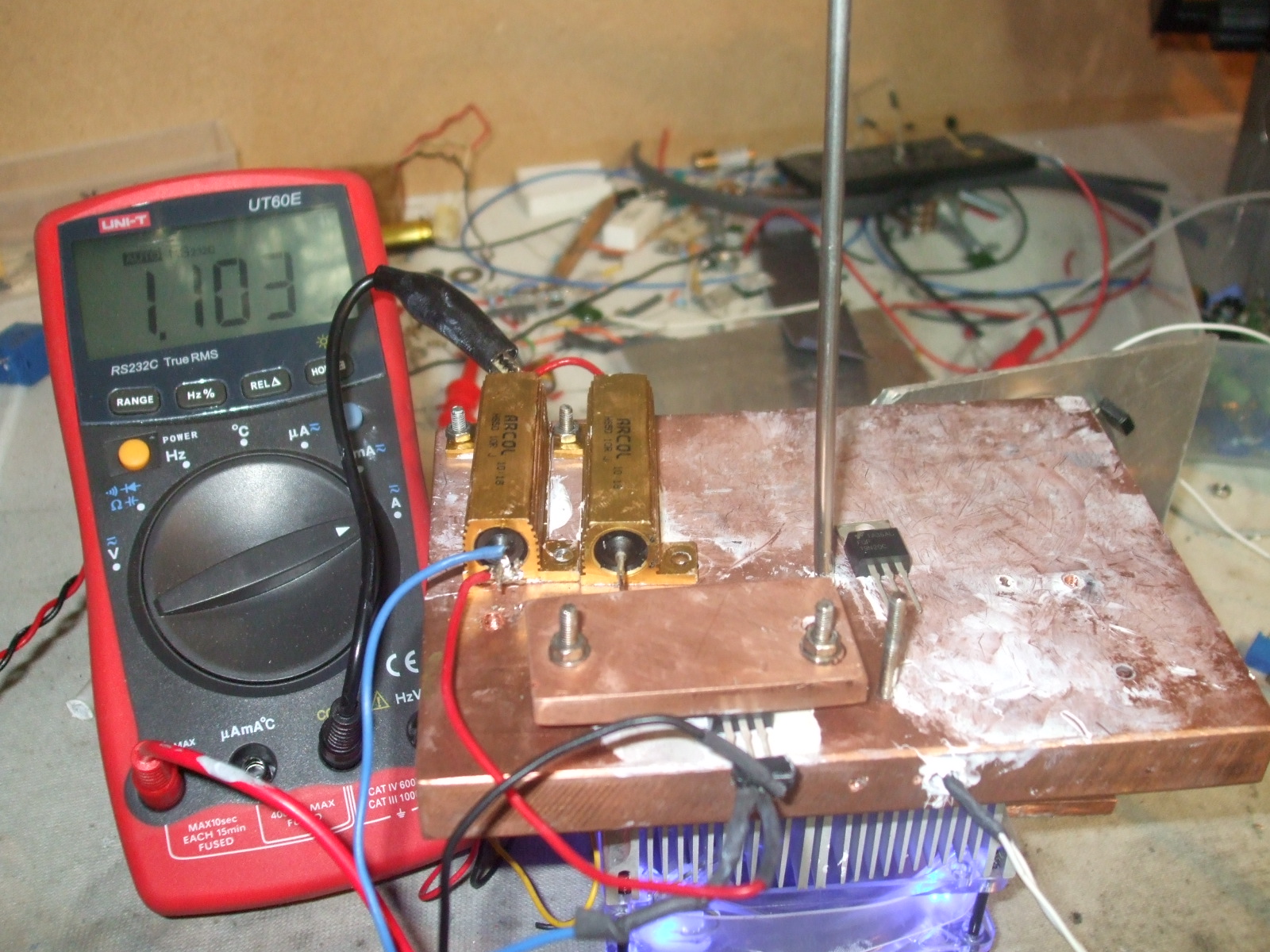

I had a similar tread open while building the F5
I was matching VGS
One thing to consider is the temperature of the beast as soon as you run a current trough the mosfets VGS change with the temperature
so I made little test bed for steady 50C this to keep similar parameters as amplifier and reduce ambient influence
I was matching VGS
