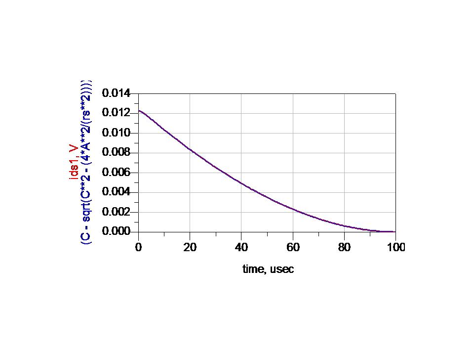

Error in the Last Equation
The last equation was in error, since it failed to take into account the Rs term. Solving for Ids requires solving a quadratic equation in Ids. The expression can be simplified with the following substitutions:
A = vgs – vto
B = 1 + lambda * vds
C = (2A/rs + 1/(B * beta * rs**2)
Then Ids can be expressed as follows:
Ids = (C – sqrt(C**2 – (4*A**2/(rs**2))))/2
When I plot the simulated Ids vs the simulated Ids the two overlay nearly perfectly. The next step is to determine which of the above parameters: beta, lambda, vto, or rs need to be matched. It seems that lambda is fairly small and can be ignored. That leaves only three parameters.
A = vgs – vto
