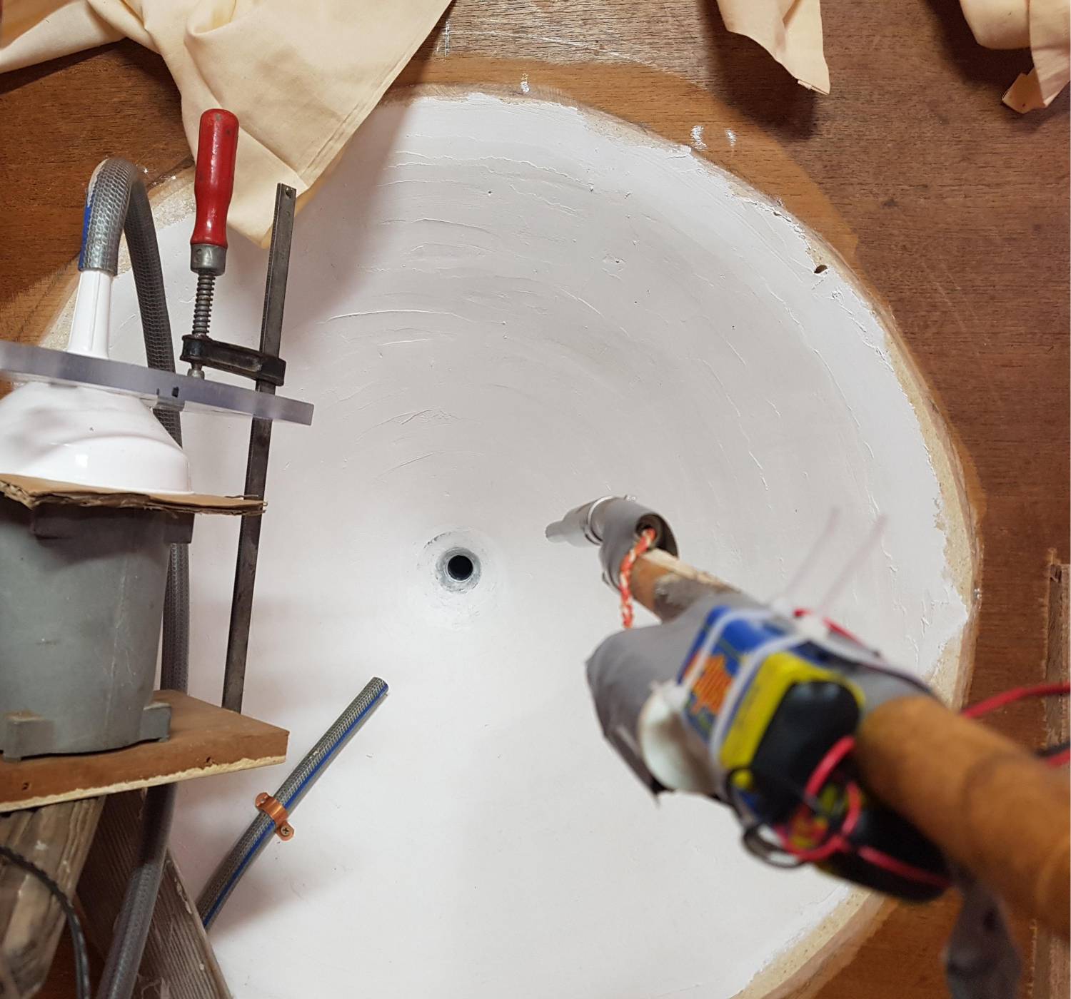

Allen, what kind of CD did you use with this waveguide? Is it the one in place within your corner loaded system?
I'm still impressed by this kind of 'plaster built'. Ellipson made a huge range in 60's built like that, including spherical enclosure and reflector based design.

For wathever reason i thought OS profile could not be used in a synergy.
Clever use of hose!

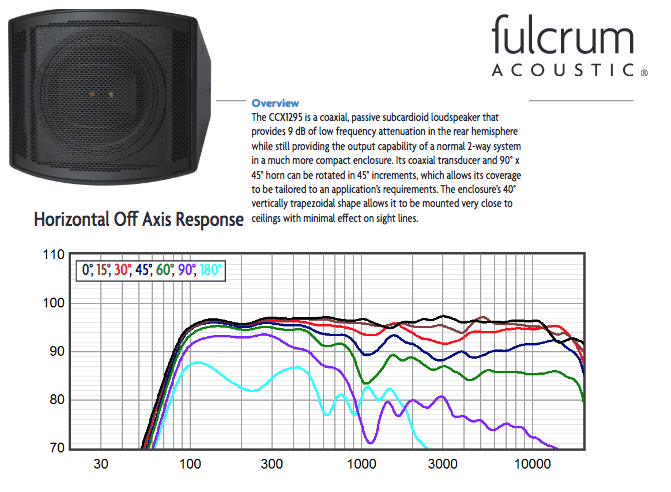

Dave Gunness of Fulcrum Acoustic has figured out how to make passive subcardioid cabinets using single low frequency drivers in relatively small mid/hi and subwoofer enclosures.
The 12" CCX1295 is ~90deg @ -6dB at 500Hz:
I am very impressed with how well the Fulcrum Acoustic passive subcardioid designs work for the size.
