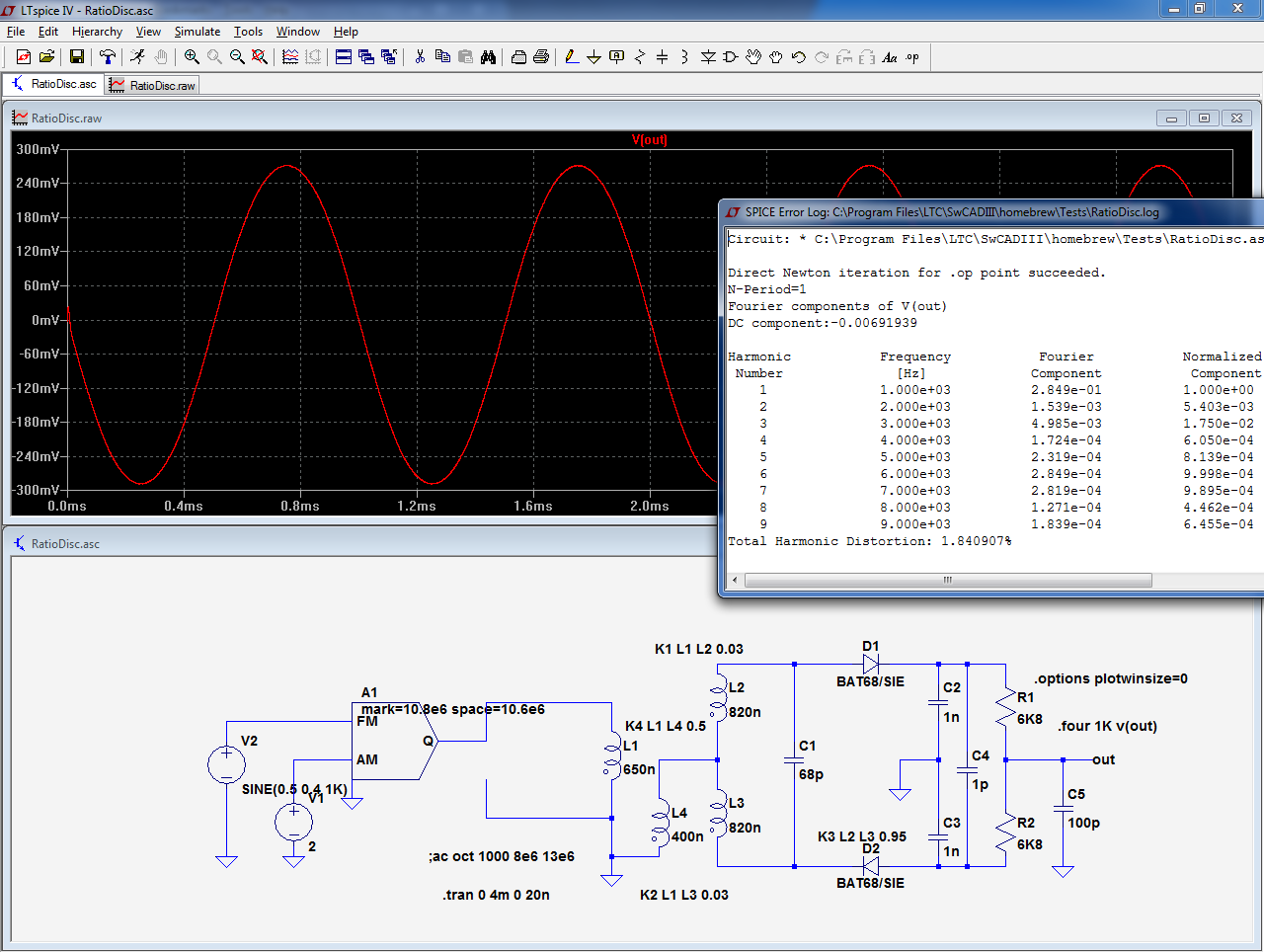

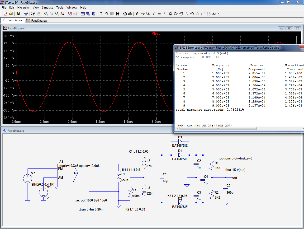

Out of curiosity, I quickly checked the effect of a mismatch in sim: it is pretty crude as I used the first values that came to mind for the Q's, coupling coefficients, etc, and the simulated mismatch is equally gross: one if the diodes is simply duplicated.
The effect is rather dramatic, with the THD going from 1.8 to 2.7%, which might be expected for such a brutal change, but of course the initial THD was already large to begin with.
In addition, duplicating a diode means lowering its Vf by ~19mV, which is not that large after all.
This example is to be taken for what it is worth and no more obviously....

Thanks! That's a very clever way of mismatching the diodes- never would have thought of it. I'd assume that keeping matched diodes at the exact same temperature is important, and that's not a given on any particular PCB.
