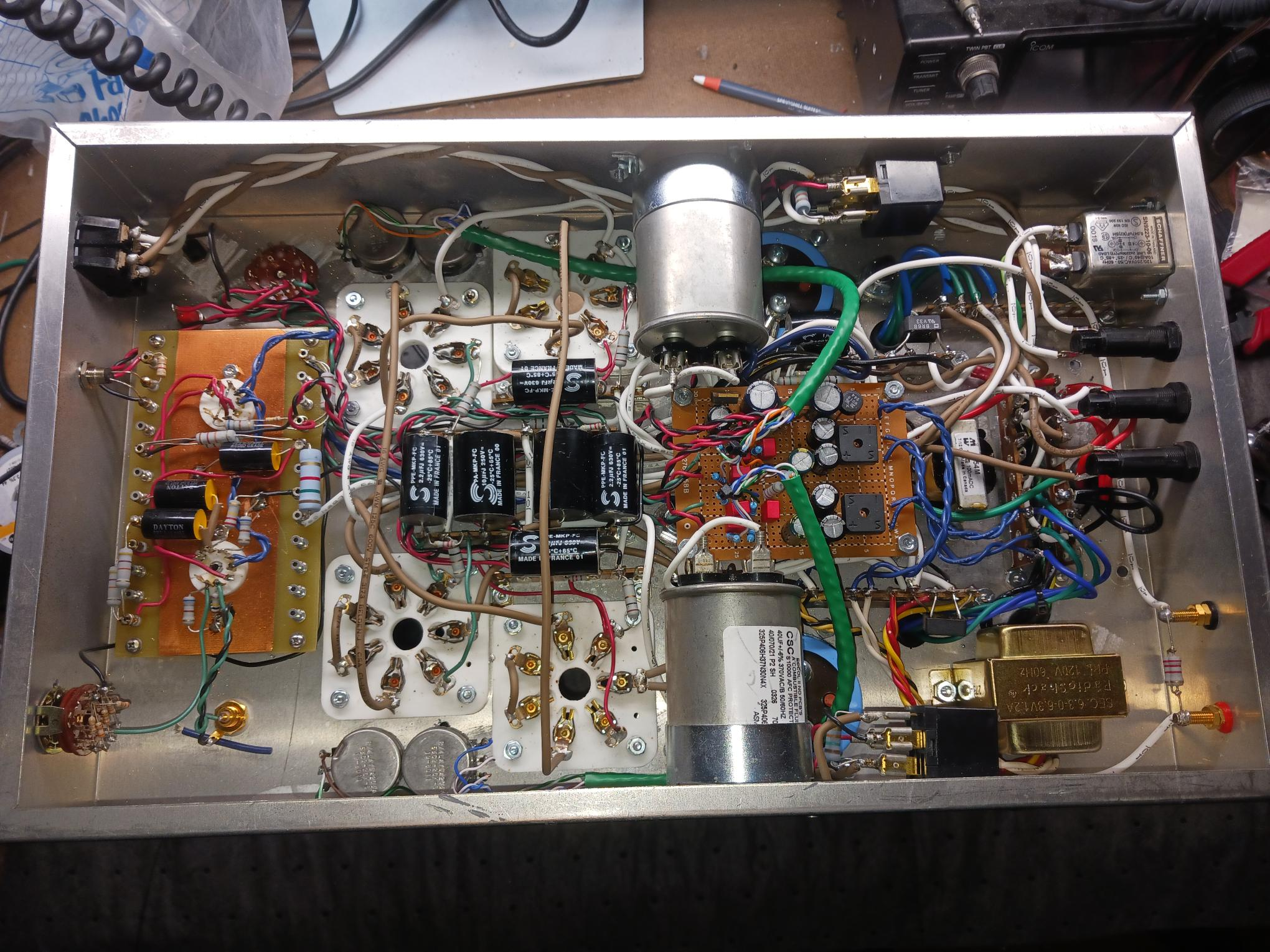

I am wondering if anyone has tried matching these tubes, and if so are the results all over the place? I built a pair of monoblocks each using 4 tubes in PPP configuration loosely based on the Ciuffoli OTL v8.2 schematic. I have 12 tubes and am measuring the cathode current at 145v Anode and at -50 and -55v bias points. I have results at -50 ranging from 50ma to 245ma with clusters around 110 and 220ma. I am going to need probably 8 more to get 2 fairly matched quads. Surely for a military application they can't be this bad?

They don't need to be consistent. They are intended as pass regulators in high voltage power supplies. In this application they run directly under active control (100% feedback) all the time. So long as they have sufficient control range it makes no difference how much unit to unit variability there is (within reason).
Just more of the trials and tribulations of using pass regulators as audio amplifiers. I've designed them in the past, but I'll probably never design another one. Just a little finicky for my taste.
The reason that these tubes show varying characteristics is NOT because of bad quality manufacturing. The main reason is that as the 6C33C has very high transconductance the internal spacing between the electrodes is very small and therefore even a tiny difference in the spacing will have a big effect on parameters, especially on gm, for lower gm tubes the spacing is larger and therefore a similar difference in spacing has less effect.
We meaure every tube at a given anode voltage and current and match them for equal grid voltage.
In a OTL amp I would recommend to match for equal grid voltage within 2V to minimise distortion, you would probably need at least 20 tubes to get 4 that are OK
Yep I ended up buying more (6) than I needed for that reason. Some websites are offering matched pairs. The PP amp built uses servo bias to give 100W out of a pair in PP. I have to agree they do need a few minutes or so if they have not been used for a while before measurement.

I can set most of the tubes to the desired bias current by adjusting the G1 voltage, and it sounds OK. I just think it would be better if all the tubes were near the same place on the curve. Maybe we should start a 6C33 tube bank? "Will trade a 160 for a 200"
Our experience is that tubes that need different grid voltages for a given anode voltage and current also differ in transconductance and Rp but not that much in amplification factor mhu. Using 2 tubes with different specs in a push-pull amp usually give less surpression of 2nd order distortion.
For paralleling tubes in an OTL the tubes need to be very similar in needed grid voltage for a given current as otherwise either available output power will be lower or there will be a risk of current hogging risking the destruction of one of the tubes, current sharing resistors in each cathode is recommended, (also indicated on original 6C33C datasheet) .
