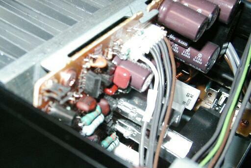

Sorry for the focus but the pic is the inside of a fairly current Marantz home theater amp using a Toshiba jfet pair. One would assume Marantz buys fairy large numbers of them........
