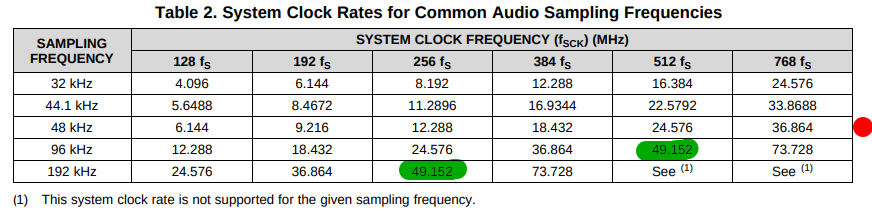

According to the PCM1794A datasheet, the 49.152Mhz clock can be used for the 96/192khz sample rate, but it does not appear in the table for 48khz.
Is another 24.576Mhz clock required for specific use at 48khz?
