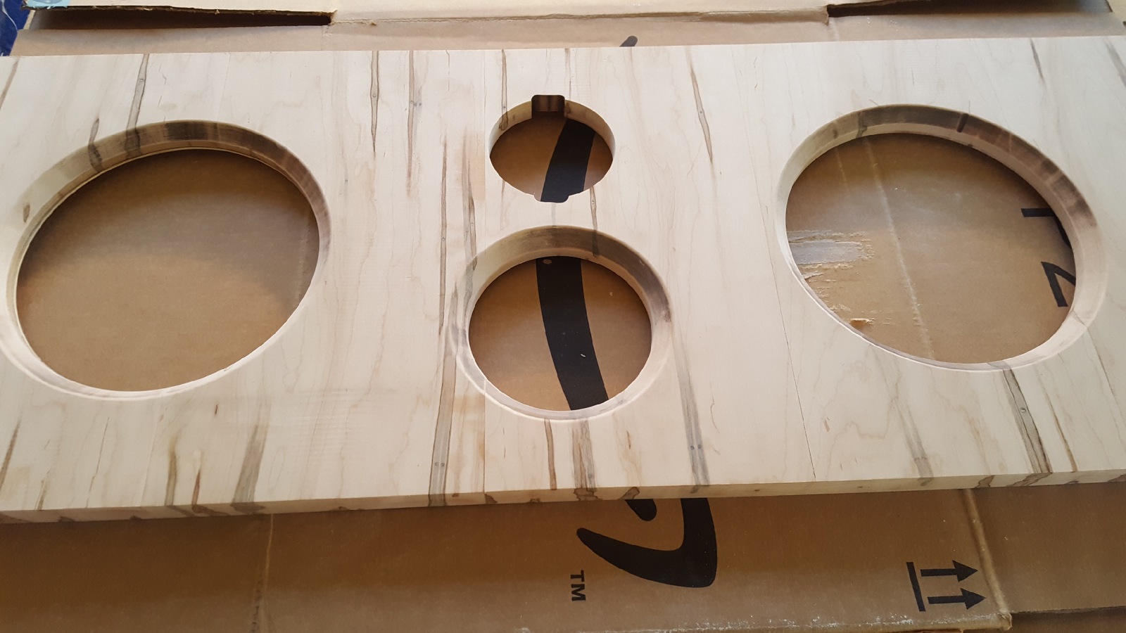

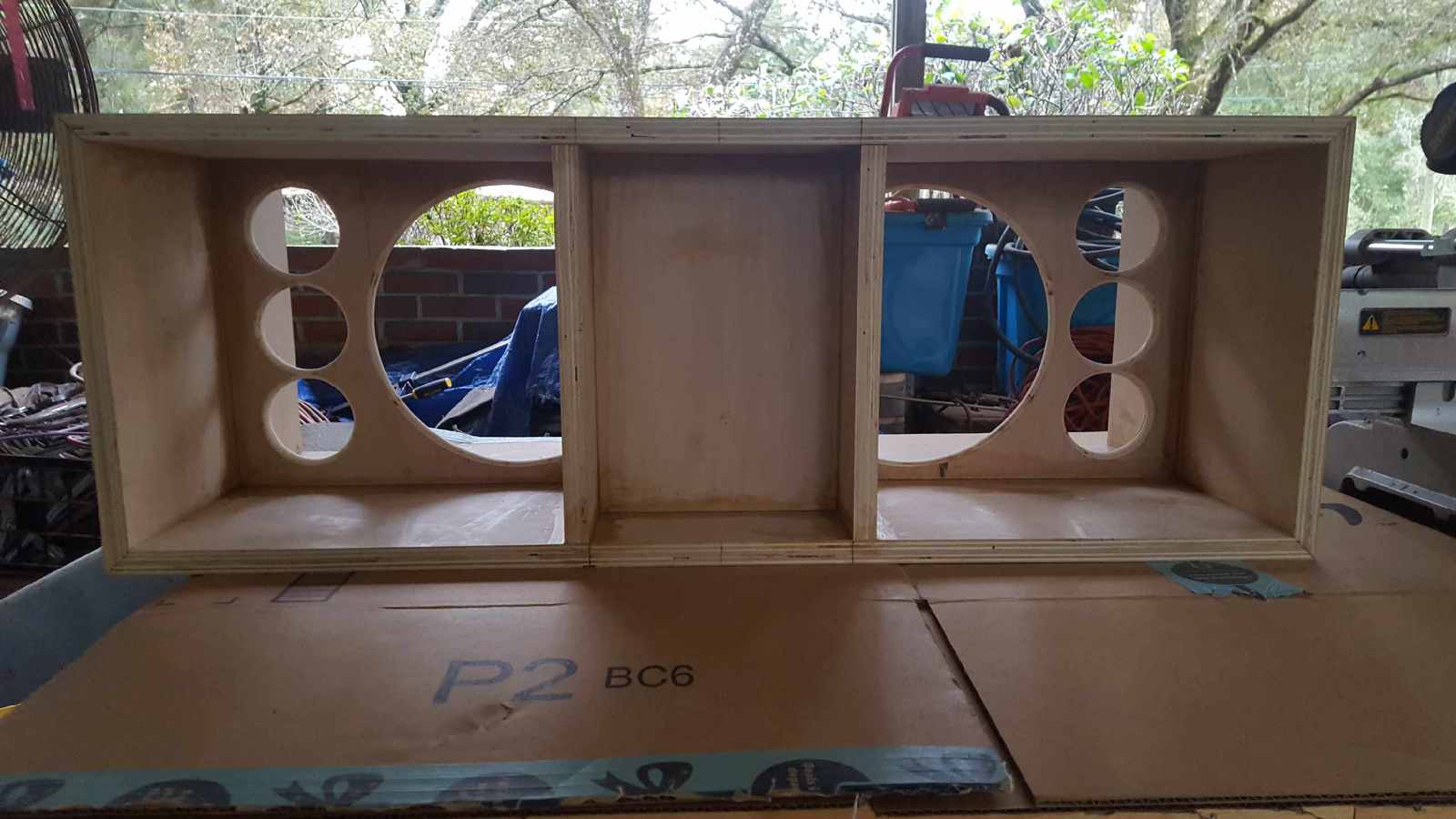

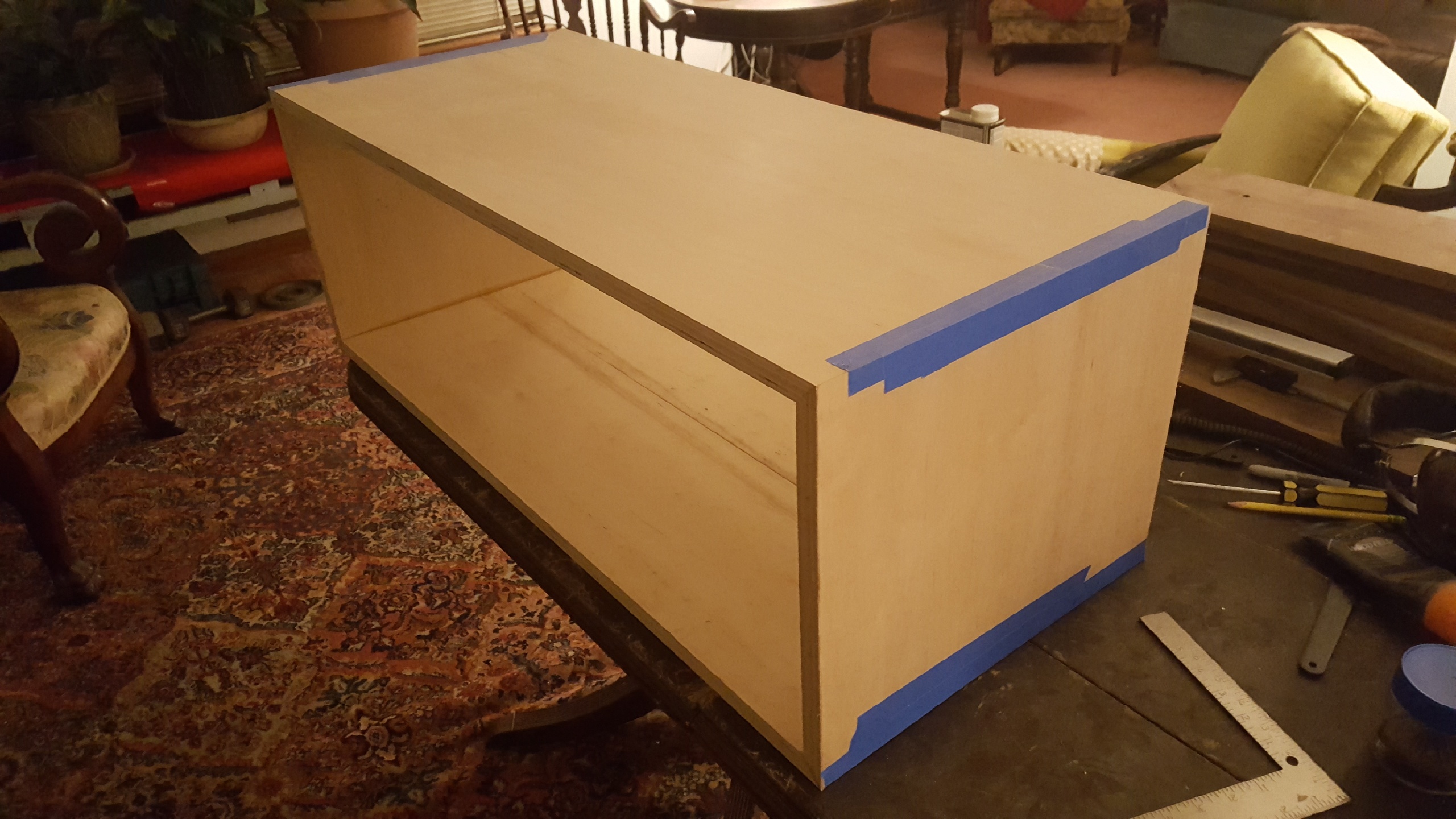

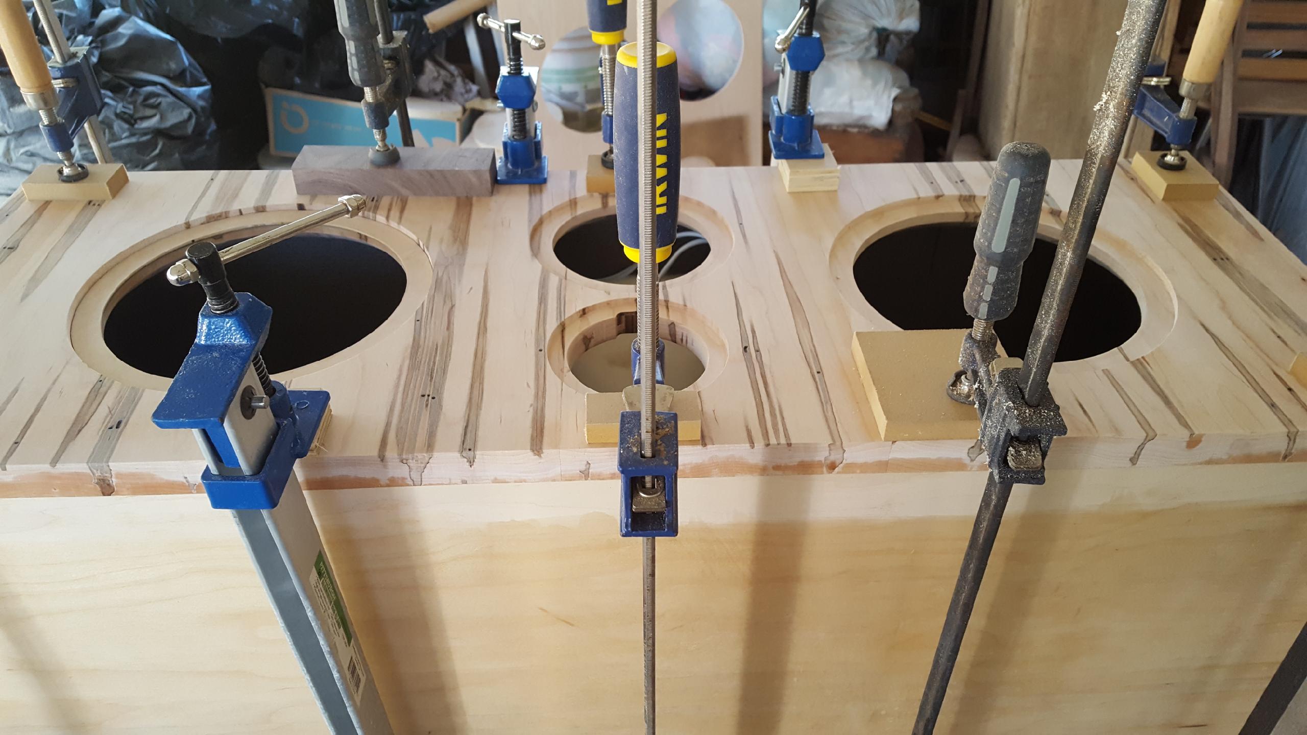

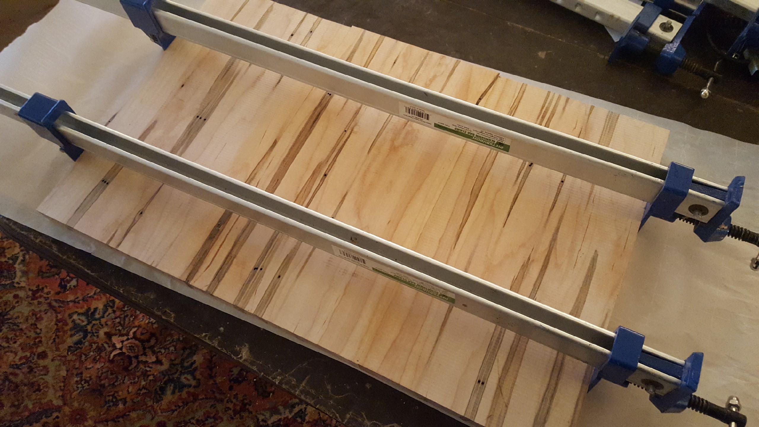

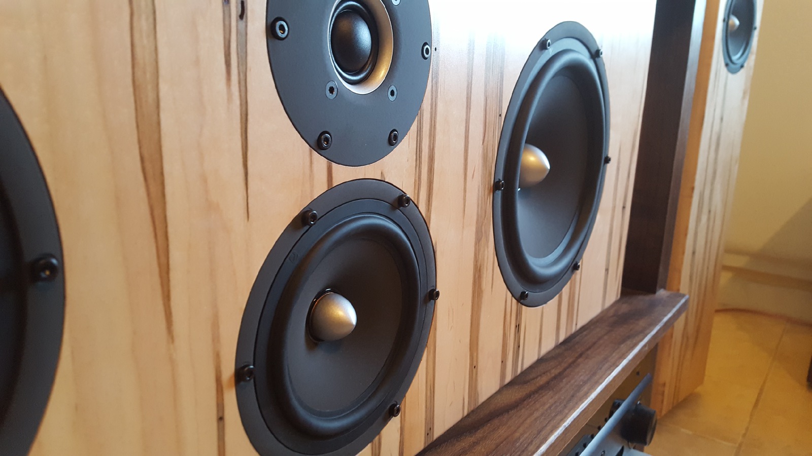

Honestly I went a bit overboard with this one and thought to myself, "why not have a stupid capable center channel that can run full range?". So its inspired by a Troels build only I am using a W15 midrange, Excel tweeter, and W22 8" woofers. Its just turned up a few notches. Midrange is sealed off at 0.15 cubic feet and the woofers are seeing 3.15 cubic feet tuned to 30 HZ with a 4 inch precision port. Hope you enjoy the build pics..

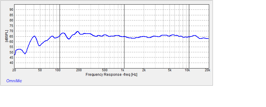

Thank you for posting. It still is a work in progress. I will admit the baffle width and height have not been really all that ideal for the specific layout of this particular drivers with respect to the midrange and tweeter integration. I switched from the 5.5 neodymium magnet driver over to the regular 5.5 with strontium magnet. Troels even discussed how tricky the neo magnet w15 was to get right on a baffle in order to get a good measurement. I traded off some efficiency (around 2-3 db) by switching to the standard w15 without neo magnets and it measures a bit better also with this baffle.
This was always for me going to be just an active DSP filtered speaker and honestly I think these days anything over a two way can be more cost prohibitive to do than designing and building what could be very expensive passive crossover for a 3 way. Amps and decent clean power are getting more affordable vs some huge value capacitors and other "magical" components marketed to folks with deep pockets that I sometimes just shake my head and laugh about.
The tweeter and mid are crossed at 2.2kh 12db LR. Both in phase. The mid and woofers are crossed at 350 12 db LR but the woofers are wired out of phase. I am getting way more energy from the tweeter mounted to this baffle than the mid so it is generously attenuated down some -12 db. DSP makes this easy without using a great deal of costly resistors.

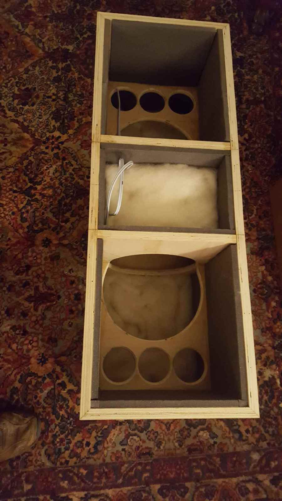

It measures pretty good with these settings but the mid from time to time exhibits some resonances and colorations I feel that are due to the mid enclosure not having enough mass. It was a small sealed compartment at around .2 cubic feet that I honestly felt would be plenty inert at building with .75 inch plywood. However, it needs more mass so out will eventually come the foam lining and in will go some non drying modeling clay that I use for adding mass to the walls of this sort of thing.
On my tower speakers I used the same .75 inch plywood but knew more mass would be needed to combat resonances so I lined the insides of those cabinets with .5 inch mdf and that has worked nicely. MDF has mass whereas plywood has rigidity with low mass.

Here is a response graph of an mtm I built. Nevermind below 150 HZ where the room modes start to show themselves but this is a 2nd order LR (12 DB) at 2kh and maybe Im just a fool but that looks to me like a pretty good "phase relationship" between the mid and tweeter which happen to have regular polarity.
