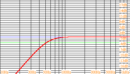

Below is a graph of the auctioned speaker, in red,and the Peerless XLS 10", in green. The box for both is a one half cubic foot enclosure, (14 liters), tuned to 42 Hz. Note the similarity, with the Peerless just edging out the auction speaker. The auction speaker dips just a little in the low range, but other wise holds it's own down to 42 hz-the lowest note the bass guitar normally plays, (with normal tuning).

Here is the graph:

Thanks for the help. I think the subwoofer/speaker design programs that I used to design this speaker give me suggestions that seem to put the speaker in a box where it has the flatest frequency response. From the graph that you made and that I made later using WinISD (looks the same) the box for that wooker needs to be bigger (14 liter per woofer), with a lower tuning frequency (42 Hz). I don't think that I'll be going with a vented woofer in my car, I like sealed enclosures much better.
Yes, the graph I printed out was from Win ISD. That is the program I usually use.
Sealed would be tough for this woofer. You would start rolling off below 100 Hz.
Look for a speaker with a higher Qts for sealed. Or a very very low Fs.

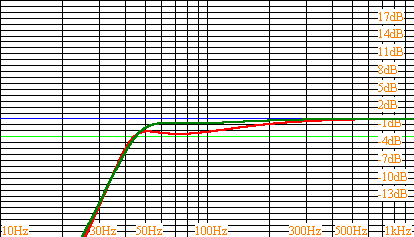

Want a nice 10 inch subwoofer for your car in that price range? One that works okay in a small sealed box?
Try the Peerless CSX 10".
I don't know if you know about Qtc-what the Q of a woofer is while in the box-but in a one half cubic foot box, the CSX 10" has a Qtc of 1.18. In a three quarters cubic foot box, (21 liters), it has a Qtc of .98.
Optimum Qtc is between .7 and 1.0. So the three quarter cubic foot box is within optimum range, the half cubic foot box is a little less than optimum-but still workable. Some might find it a bit boomy, most would find it all right.
In these compact boxes, don't forget to leave a little space for the space the speaker itself occupies. In these small boxes, that makes a difference.
About $60 each from Parts Express and Madisound, if you are in the US.
Available also in the UK and Australia.
Red is the half cubic foot, green is the three quarters cubic foot. box.
