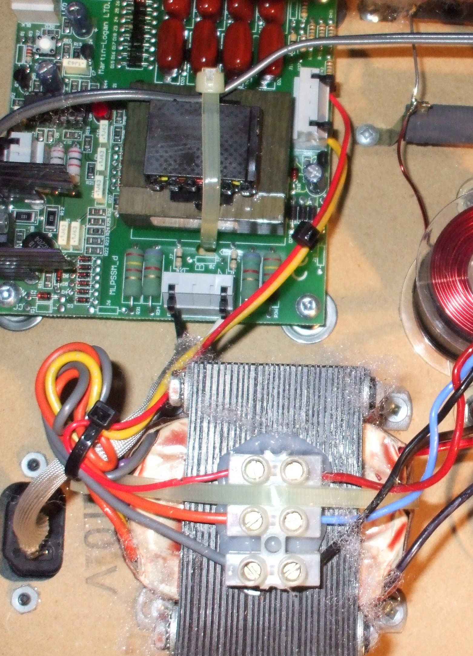

Look at the Zeners,Bottem righ....
This what sets up the Bias,it at allmost 5500-vWith out the Zener string
Reg.to ground.
If you go up to much with the ML panels, You hear a buzz, just back off.Same as my Soundlabs you here the buzz back of a little...
Mr Powers gave Me the info...an i did this MOD, it works...As you see ....Eze..
As you see there are two RE. r23-r24 1.8k in the feed to the bias tranfourmer on the AC side....this well give more aswell, Just jumpr23-r24 an you go to allmost 4000-v.. From The stock of 3700-v....Have Fun Price$$$$ your time.

I have bypast the SL3 bias board .
Put in the Ajustabl bias for my Acoustats, now i can go from 3.5k to 6.5k Thay now can be set up to mach the bass driver much better an there at 4.3k sounds better than ever.

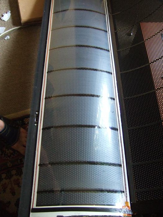

Just got these of CL for $100.US.....i well have pix after there playing.. there out there the panles are like new....after a bath...here how thay lookt in the add...This is killing my diy ESLs.....

Any suggestions for possible tweaks or mods on the boards shown in the post above are greatly appreciated! Also, does anyone know the purpose of the switch shown in the bottom right of the bias board? It has two positions: "0" and"1" but has always been on "0".
Other mods I have done on the Sequels have been structural. Based on posts on the net several years ago showing resonance in the bass cabinet and "wings" behind the panels, I fashioned braces made from 1" galvanized pipe filled with sand. One goes between the wings and one goes from either side and to the rear of the bass cabinet using a pipe T. This cleaned up the bass and midrange clarity. I also removed the batting in the bass cabinet and installed a sorbothane deflector on the rear wall of the cabinet. This had the effect of making the bass sound quicker and more impactful.

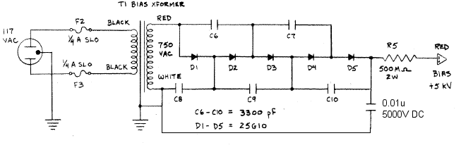

Martin Logan uses a string of zener diodes inside of a bridge rectifier to regulate the output of the bias supply transformer which is fed to the HV multiplier. The switch is in the lower right corner of the attached schematic.
When the switch is in position "1", it is closed and bypasses two of the zener diodes which would lower the regulation voltage and thus the output of the HV bias supply relative to the "0" position. I don't know what value zener diodes are used, so couldn't tell you exactly how much the HV would be affected. This might have been used to slightly adjust ESL panel output if neccessary to get better matching between left and right speakers in a given pair.

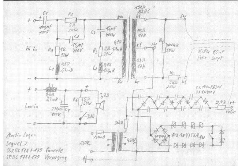

Schematic
Thank for the schematic.
Rob you can see that the tranfourmer is in the pushpull setup...
Looks like the 20w5k well cut the output of the panels...An the 100k 50watt
You can take them out ...this well give better bass...an open up the sound... if you like the sound of them in, a new diff res. there ,can give a better sound...
The SL3 an Ascent Tranfourmer is diff than the Sq...but thay use nothing on that side of the tranfourmer..here is the Ascent schematic
An the limiter dose not come on the sean...till the late SL3.. i have had 2pr of SL3s here that did not have the limiter in them..
Thay did this same thing to the older CLS, it some type of tone seting that jim said thay did away with...I have pulled out these res. an got much better sound...Hoho

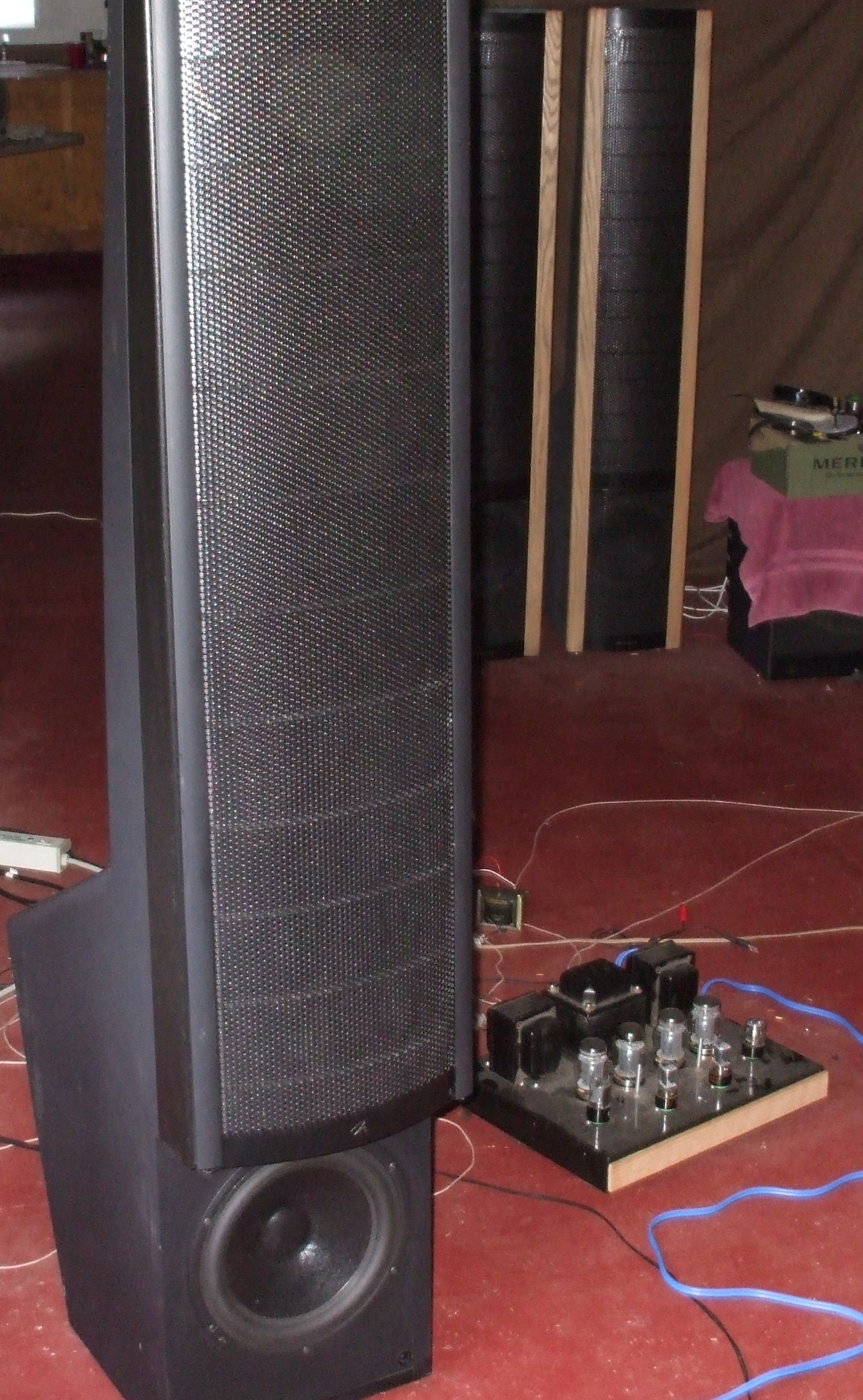

I now have a Pr of Prodigys here now...stock thay sound ok...for a 10k pr of speakers....if you drive the with a big amp...an big bucks..wire,tube pramps..
But with small mods the Prodigys can fill a room 18'x27....with a 60watt tube amp...mods.... Panels....got to get the Bias feed to the panels.. with the logans at lest bias on the left an right side of the panel.... Bias...some how we forget the bias IS the ESL.. it what sets the sound of any ESL...10k speakers with a $20 bias an limiter board.....An then the Limiter...had people here that let hear the Limiter in....an out....all said the highs were much better with it out...I well say that if all i did was pull the limiter out of

Check my logic here
C1 and R2 in the Sequel II schematic (offered in a post above) are the only components where signal has to directly pass through on the Hi Freq side of the crossover. I am assuming that means these are the only two that therefore need to be very high quality and tuned by ear. For instance, changing out the other caps, etc will have a marginal, if any, affect on the sound quality.
Is this correct?
Thanks for your input.
Is this correct?

Effect of R5, R4 and a question.
thanks Bolserst (and Calvin) for the circuit and Rob, Tyu for your posts.
My findings concerning Sequel2:
Ommitting R5 results in the highs being raised beginning from 8-9 kHz.
At 20 kHz they will peak more than 10 dB above the rest.
For me, it sounds too hot. Paralleing R5 with the same value and therefore halving the resistance, should be more balanced.
R4 lowers the efficiency of the whole panel about 4-5 dB. Ommitting this will result in a lean sound. Might be OK, if you place the speakers near the wall.
I took measurements, but unfortunately, didn't store them on my PC.
What's not clear to me: putting the resistor (R5) before one stator, should raise distortion, because the force to the foil will be not equal from front and back stator.
What do you think?
Negligible?
Maybe it could be prevented, by putting resistors before both stator sides, right?
regards
Olaf
