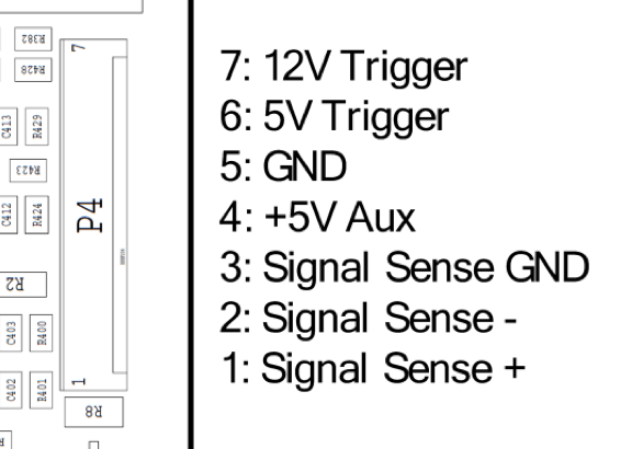

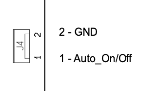

Dear all, I managed to get 300ASC boards, however they differ in J4 (200ASC 2 Pins for GND and Auto on/off) or the P4 (7 Pins on the 300ASC) - any chance that I can used the 300ASC in my ML Spires? Is the Auto on/off a 12 V trigger signal?
Cheers and thanks,

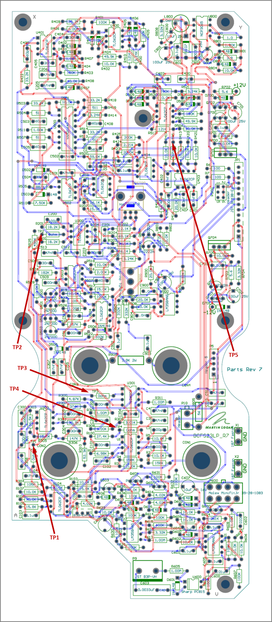

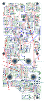

It sounds like there is a problem with the upstream circuit, not the power amp board. To confirm, when you have nothing connected and are hearing the humming/plopping noises, what is the color of the status light on the back panel? If it is blue, wait15 minutes or so until the auto ON/OFF times out and it turns red. At this point, the power amp should be muted and the noises should be gone.
If this is the case, then the next thing to do is to signal trace thru the circuit from input to power amp, circuit block by circuit block. Fortunately ML makes this very easy as they provided TP(Test Points) on the PCB between each circuit block. Just input a 100Hz signal and step thru each TP with an oscilloscope until you find where the signal is lost or corrupted to locate the faulty section of the circuit.

An input of 2 to 3 Vrms on the Woofer binding posts will get you in the 100mV - 200mVrms range at TP4, a reasonable level to follow thru the rest of the test points.
Yes, the TPs should be measured relative to ground. There are 2 connectors(X1 and X2) on the PC board which are ground and can be used for measuring the test points.

Ok, so it took me some time to test the board or boards (as I used the functioning one as reference).
As you explained, 2.5 Vpp gave around 400 mVrms on TP4 on the functioning board. This board remained in standby mode for the amp (red LED) when I input the sine wave signal on the woofer post (I assume it does not matter whether I use the + or - post, I tried both).
On the broken board however, the amp board instantly goes into active (blue LED) as soon as I input the same sine wave and I detect nothing, not even noise on TP4 and TP1. TP3 gives a noise signal.
Could that indicate a dry soldering point?

Hmmm...Trying to understand why the good board left the LED in standby mode, but the bad board instantly switched it to blue.

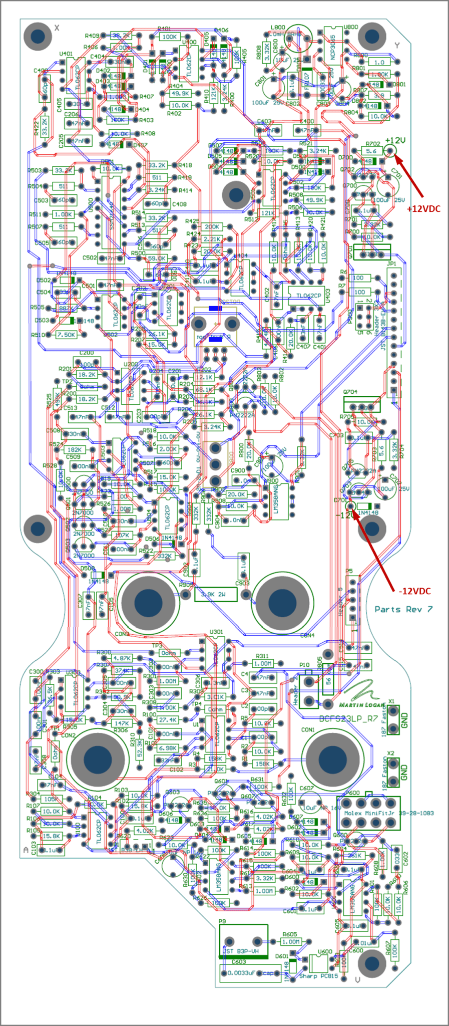

In any case, if you aren't getting any signal at TP4, either the input opamp is bad or possibly there is a short somewhere that is pulling down the power supply for the opamps.
I'd check the + and - 12VDC supplies as noted in the attachment. Lack of +/- 12VDC power could also explain the LED behavior, but I'd have to check the schematic tomorrow.

Thanks for the idea on the 12V supply, I will check that.
