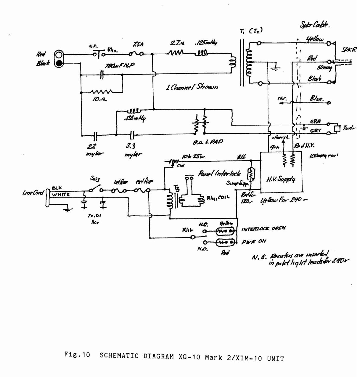

BTW, I recently learned that Dayton Wright used a large safety relay in series with the audio.

I also have 5 pairs of Dayton Wrights XG 8 , XG 10, XG 10 mk 2 in the garage ( 2 working pairs ) with lots of parts, tank of SF 6 , DW subs etc all to sell off this fall. The relay was in series withe audio signal and wouldn't close unless the AC to the bias supply was present (A simple way to prevent driving the system without bias present)

As you mentioned, the Dayton Wright XG-10 did have a relay in series with the audio signal going the step up transformers.
Looking at the attached schematic, you can see that the relay will be energized if and only if two things happen:
1) 120VAC wall power is applied
2) The safety interconnect switch is closed.
My guess would be that this relay was to make sure a customer didn’t accidentally have audio applied to the step-up transformers when he/she had the interface box open and could accidentally touch some wires carrying the high current High Voltage coming from the secondary of the step-up transformers. I good safety precaution I would think.
This setup would also keep a user from inadvertently turning up the volume to much if the HV supply was not plugged in and they didn't hear much sound coming from the panel and just kept turning up the volume. They could potentially overdrive the transformers or arc the panels. Perhaps this is the purpose of the FET switches in the CLX as well.

I'm not sure if the Dayton Wright relay was done to protect the cells from an unbiased audio feed or as part of the safety interlock with the front panel AC lockout - probably helped both functions. The Hammond EI core stepup transformer for each speaker weighs 39 pounds with an 80k secondary - the entire interface unit weighs over 100 lbs
