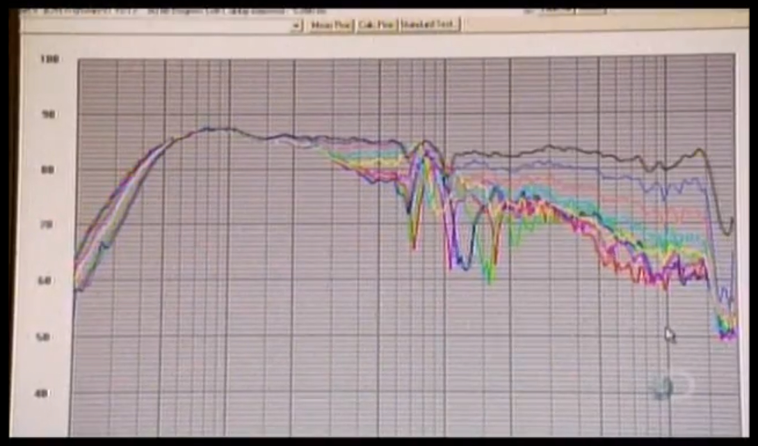

Attached is a screen capture from a recent video showing the FR of the ML Ethos measured during ML QC (I assume). But since the conditions of this test setup are not known, I don't know if you could correlate this (or any) FR test with your own setup.
Please do post your measurements when you run your FR test! I just hope you aren't disappointed -- I've seen other ESL FR tests, and they're surprisingly wiggly...

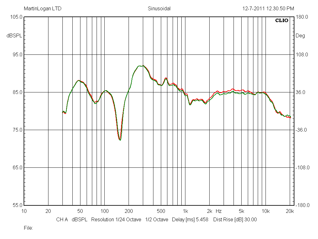

Here is the SL3 reference response from Martin Logan:
And herein are my Sequel II ES panel responses before and after washing (yes! I washed these!) - don't care the offset, I used different levels.
Lug 14 are the graphs 1 & 2 BEFORE washing (since 1996 when installed)
Ago 4 (today) are the graphs 3 & 4 AFTER washing (washed yesterday)
Currently I am listening to the new "washed" sound and it seams better, more realistic and brighter ... even if from the measurements it should be the same of before.
Andrea
Andrea
