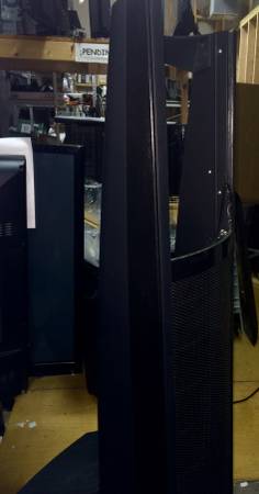

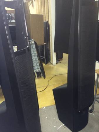

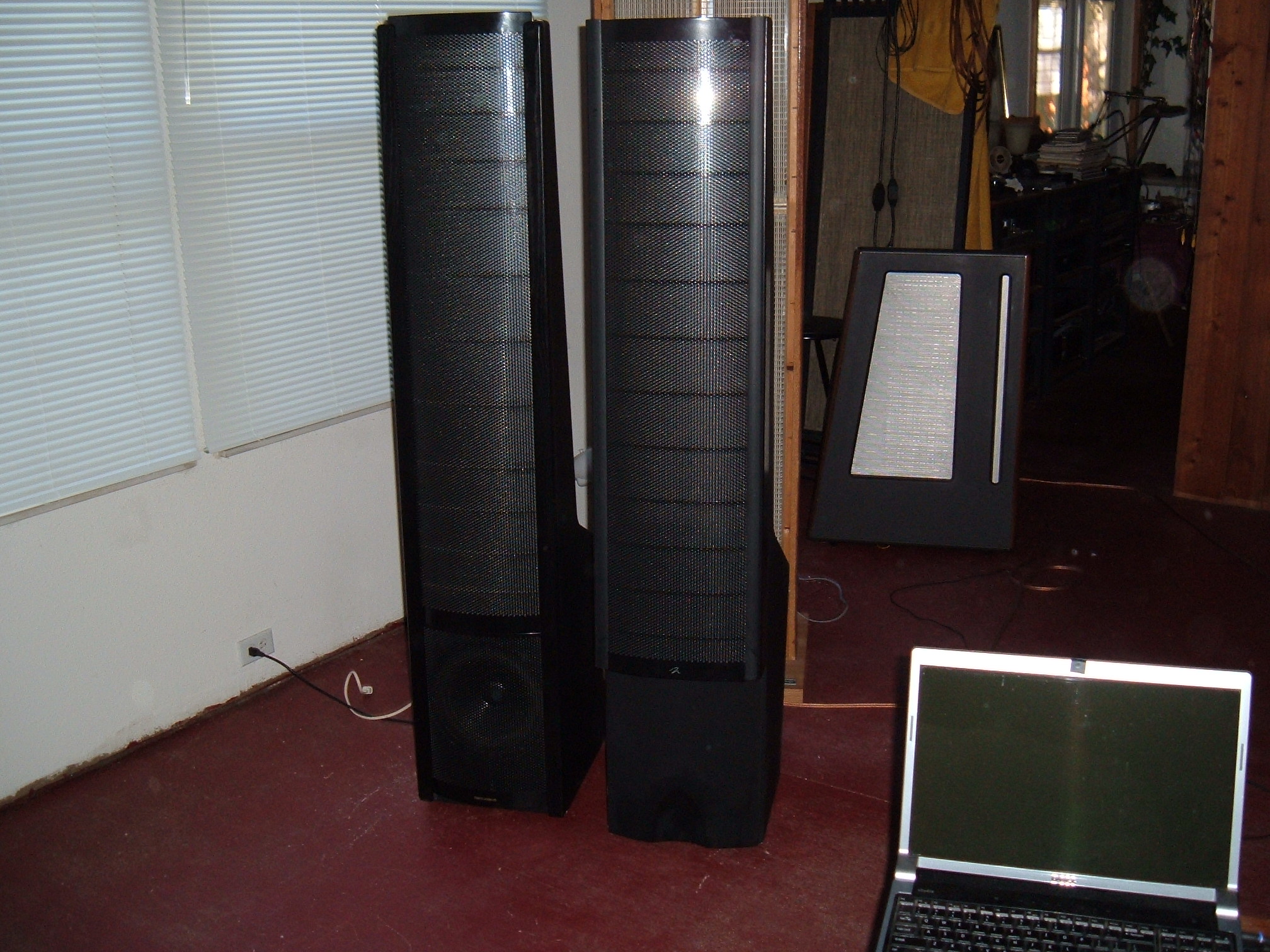

I have here now..a pr of Ascent ....see pic that I just got..for $40 for the pr...panels fell out...ripet the wire off the panels...the owner could not sale..ML offer to sale him a new pr of panels an the give him the panel fix......for $2k thay sat for year then I offered him
$40....he was glad to get it....
I think you have nothing to lose...an I feel you well get better sound...you can aways put the stock crossover back...last pic is two pr I just got running....
