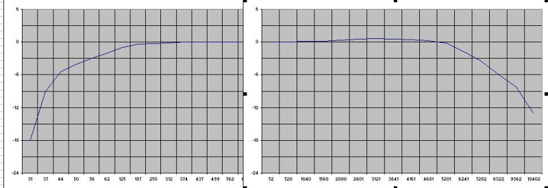

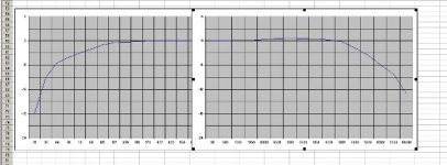

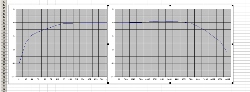

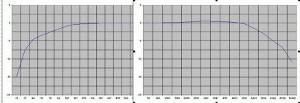

Hi sholby,
i calculated a little bit:
If you want to go down to 150 Hz , your primary inductance need to be at least 4mH. Even a perfect stepup won't show better coupling between primary and secondary windings of about 0,002.
So 1: 150 and 680pf Panel capacitance results in high frequency response as follows:
response when serial DC-resistance is 2 Ohm:
